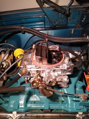

Ed, Just reread your original post. The problem started when you increased tension on the choke blade to make it stay on fast idle longer. Please take a clear up close picture of the passenger side and driver side of your carburetor so we can see the factory set-up. Thanks.

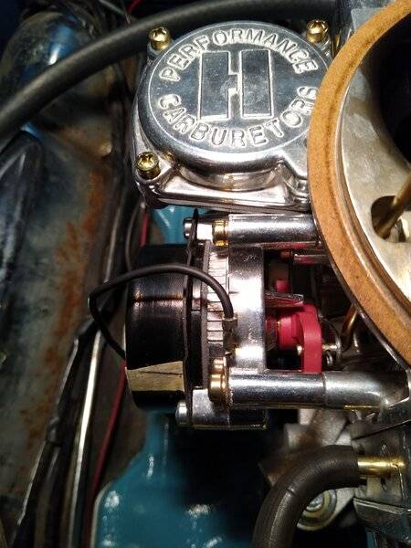

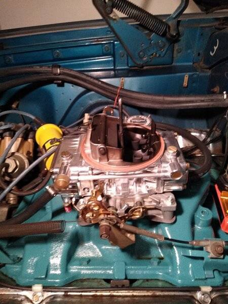

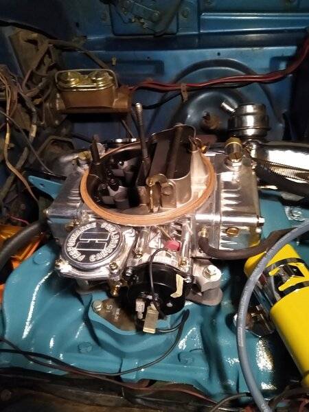

Dave and Mike: This is great, I appreciate the input you guys are giving me. I have adjusted the cap to notch 4 from the front (hope you can see from the photo). The mark on the piece of tape is what I was using to keep track of several changes since I could not find the reference mark on the cap until this week because it was so far CCW past the notches and I had put my mark even past where the real mark is in the cap now at notch 4. So now it is much more lean. I really think this will stop the black soot. I understand the fast idle stays until I tap the gas. Doesn't it come off fast idle one step at a time on the cam until it's fully warm? My problem before is that it wasn't staying on fast idle very long (that's why I adjusted it so far CCW to rich) and the engine was stalling when I had to come to a stop before it got warmed up. Here's some photos... there are supposed to be three, but can't get the carb from pass side to upload. It's a 80457SA 600 cfm Holley. IMG_20200816_133920772_BURST000_COVER.jpg

Thanks Mike … see my response to you and Dave just now. I had trouble uploading the photos, don't know why there are so many. There are three and I think the pass side carb IS there.
I see the index mark on the cap it looks one notch right from center. (looking at it straight on. That is rich I believe. ) Never adjust it more than 1 notch at a time. The caps always had a arrow and Rich/lean marked on it as to which way to go. Those Holleys have the fast idle cam behind the choke assembly. (the red plastic cam. it should be free and move with gravity when you step on the gas to set the choke when the engine is cold. If the choke is set too lean it might not choke or go up on fast idle if it is near 100° in the morning when you start it.

(((( I have adjusted the cap to notch 4 from the front (hope you can see from the photo). The mark on the piece of tape is what I was using to keep track of several changes since I could not find the reference mark on the cap until this week because it was so far CCW past the notches and I had put my mark even past where the real mark is in the cap now at notch 4. So now it is much more lean.))))
Do you see the index mark on the cap now. That is the only mark you need. Don't confuse yourself with the tape and your mark. tear it off and get rid of it.
