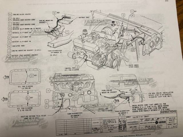

I have a question about a block heater for a 440 I have it installed correctly on the passenger side of the block. Does the wire get routed under the oil pan attaching it to clips using 2 of the oil pan bolts then does the wire get clipped to the k-frame and then to the underside of the battery tray and finally clipped to the rad support.
I own a 1971 GTX that came with a block heater and if any one has a schematic showing the routing of the wire and clips used that would be great.

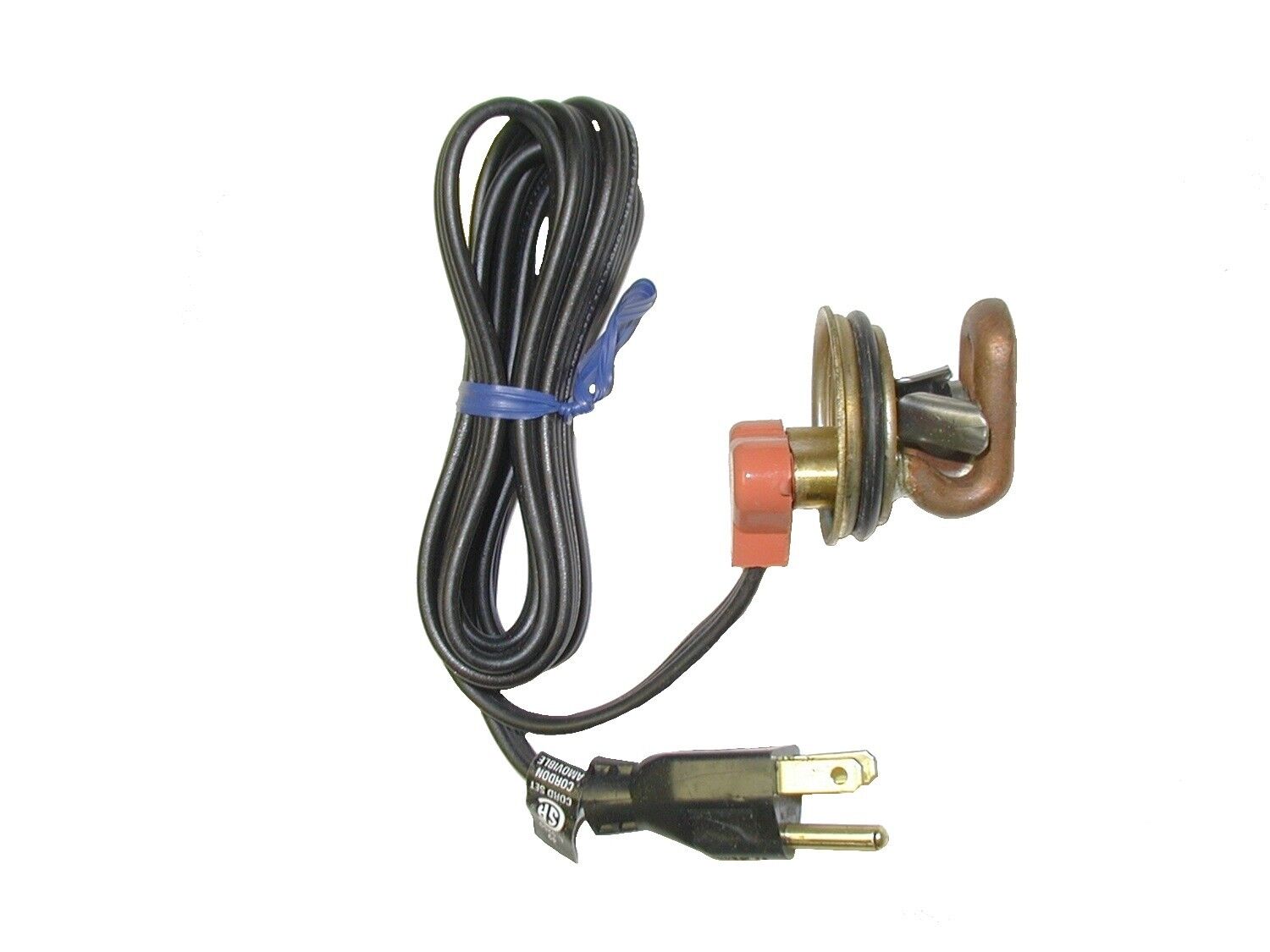

You remove the sand cast plug.
Buy the block heater, which has an element similar in shape to an element in a residential electric water heater. You then insert it where the plug was.
A cord comes with it that you plug in and then plug the other end into the 110 volt outlet.

Here's a typical picture, courtesy of eBay.
Thanks for all the replies but I HAVE the block heater installed and only looking for a drawing from factory or otherwise about how the dealer ran the wire from the passenger side of the engine to the drivers side where the 110 volt plug ends up fastened to the rad support, that's what I need. Just trying to have it look correct
My car is a promo car, very low vin almost finished restoring it to a high end drivers look came with a ton of options adding the block heater to the build

Hi Ron. I don't know if you ever got the information you were looking for, but here is the factory assembly drawing for the installation of the block heater on a 1972 B Body. I'm sure it was the same for 1971 as the drawing has an August 1970 date on it. This is from page 454 of the 1971-1972 B Body Electrical and Body Assembly Manual available from Faxon Auto Literature. His manuals are available most body styles and include hundreds of factory drawings with installation procedures and processes documented. Hope this helps.
