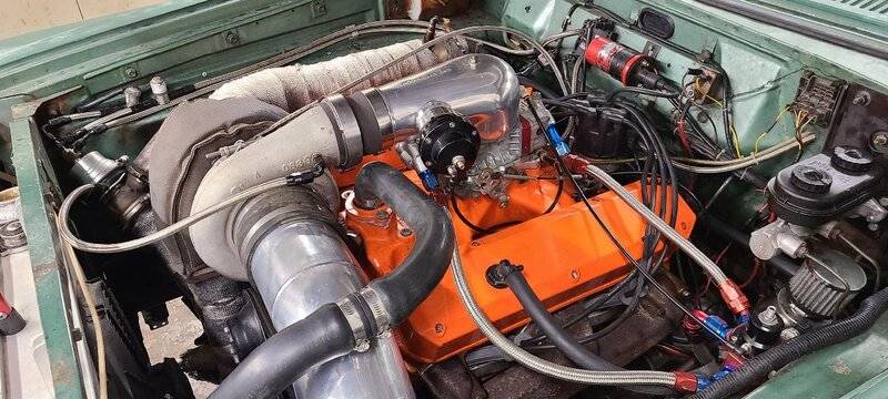

Ok, thank you all, I've had a really hard time finding many turbo B engine guys willing to talk much about specifics, so as I progress, I will keep you all up to date.
The engine specifics are;
Early 1973 block, I believe its the second most sought after casting, the block is square decked, align honed, and bored .040". It has ARP studs, a steel stud girdle, and has been hard blocked to the water pump holes, 1/2" oil pick up, 7 qt Milodon pan.
Steel crank, standard journal sizes, stock 3.38" stroke, balanced.
Eagle level 2 rods, rated to 1,200HP at 8,500 Rpms, checked for roundness and clearanced, .990" pins.
JE boost pistons with a small dish, 10.0/1 compression, rings gapped for boost.
Edelbrock heads, valve job corrected, guides clearanced and mild bowl porting, they flow 282 Cfms at .550" lift, ARP head studs, Cometic gaskets.
Bullet solid flat tappet cam with EDM lifters. 114 LSA, 247 degrees at .050", .547" lift, degreed.
Harland Sharp rockers, Smith Bros push rods, valve train geometry kit from B3 racing.
MSD programable ignition, MSD distributor, NGK spark plugs, #7 heat range, gapped for boost.
M1 single plane intake, dual needle and seat blow through carb, -10 fuel lines, Aeromotive A1000 fuel pump, E85 for fuel.
Starting with a Borg Warner S475 75mm turbo, but will go bigger if I need to.

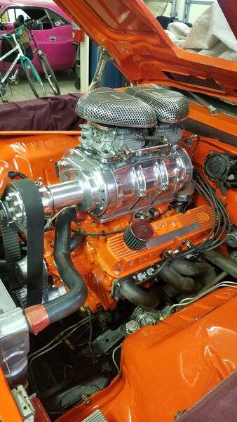

DVW...Posted the wrong picture.
picture not matching description. Looks like a small roots 471 on a modified factory intake. Stock heads, Dual AFB's
That is the substitute for my racecar. I've run this with a 6V-71 since the mid 80's. Ran it on the stock block and crank for years. Now has an R block a friend donated. This is the 62 motor.
