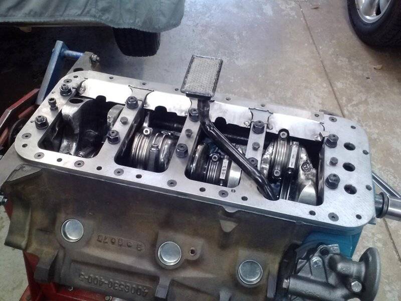

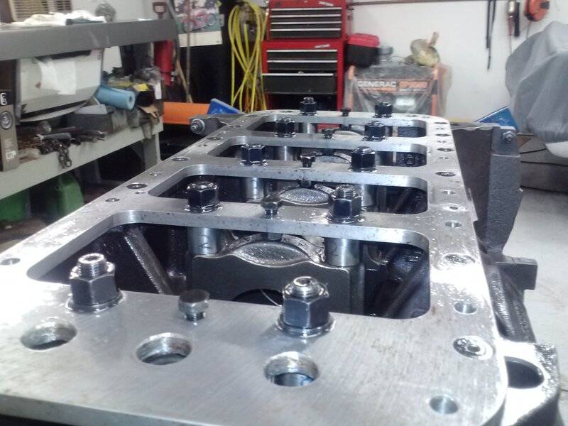

Satellite 11-10-2021 - YouTube Sorry, I guess I'm a little late to this post. Been boosted for 11 years now. Started with an old 383, and stepped up to a 470 in 2017.Home made 3/8" girdle&a half fill of Hardblock in a 75 block. Had a homebrewed blowthrough carb, but have since gone to the Sniper X-Flow(8 120 lb./hr. injectors) on E-85.Ported Edelbrock r.p.m. heads,M1 single plane,10:1 compression,s.f.t. cam 247-251,.546-.540, 115 lobe sep.,homemade ex. manifolds,9.5" Dynamic converter, 3.54 Strange Dana 60, 315-60-15 Mickey drag radials.My best advice is don't get greedy on timing,and bullet proof your boost control system. Running 22 degrees of timing and 11.5:1 a.f.r. on the gasoline scale at 11-12 lbs. of boost. Traction is an issue below 60-65 m.p.h. Here's an update with a 470 block pic CAM00180.jpg

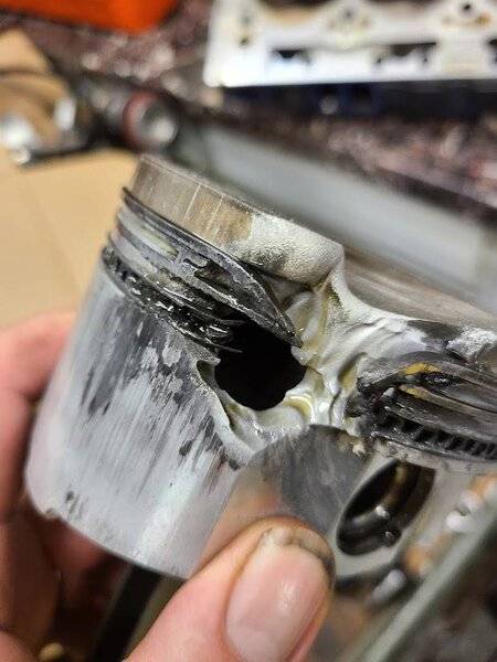

We found the limit on the tune up in hot weather. Piston #2 as well. First time its melted and hurt one in years. 360, non intercooled, 9.5-1, E 85, 22 degrees, 22psi. The rest of the engine is perfect. Went 140mph on this pass

Holey moley! :eek:
The funny thing was it barely smoked out the exhaust.
