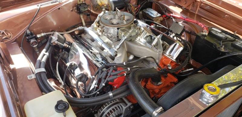

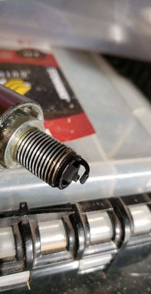

So I fired up my car yesterday after putting it away for winter and noticed blue smoke coming from the exhaust that wasn't there (as far as I could tell) before storage. I let it warm up and went for a quick ride and still a bluish smoke. The engine is a 572 Hemi, well maintained and babied. Of course this happens as I'm preparing to sell the car. Can blue smoke be caused by overly rich mixture? Plugs are black but not wet. See pic.

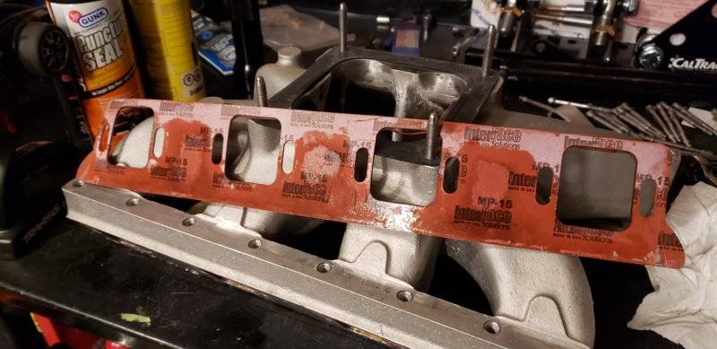

I'm going to pull the carb and go through it and clean it as well as change intake gaskets to see if the engine is pulling oil from the intake.

Looks like the intake gaskets were not sealing. Wow.
That’s a fairly common issue. Check and see if there’s any misalignment of the intake/head face. I’ve used ultra grey on those gaskets and also have used Moroso cut to fit pro stock gaskets that have some crush to them. Torquing those intakes is a lengthy process. I use an inch/lb torque wrench and lots of patience.
