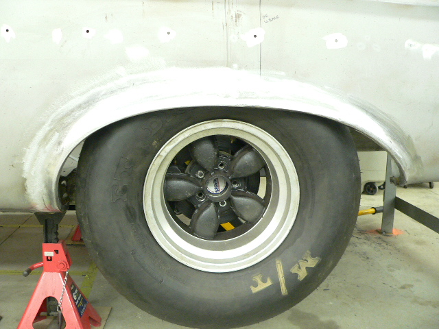

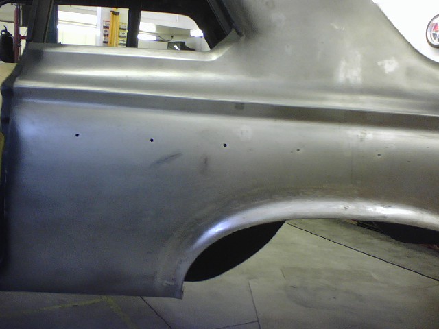

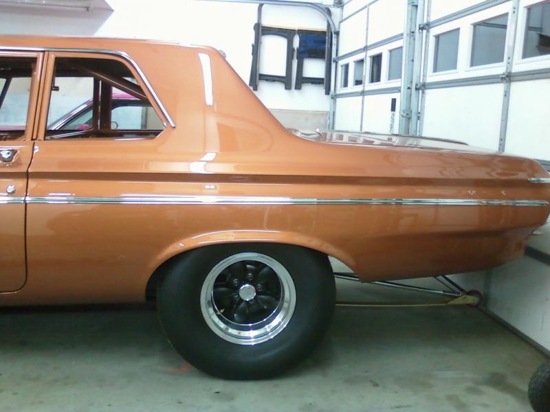

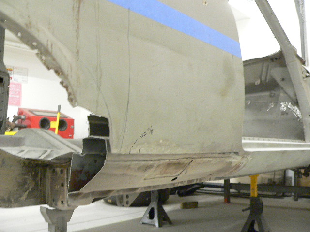

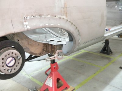

I agree. I don't like cutting right on a body line as it's hard to get it perfect. 1/2"-1" away keeps the structure enhancement of the body line w/o getting into it. That being said I always add as little as possible. I find but welding works bet unless your just learning. My 1/4s were rebuilt on the bottom due to rust and stretched 4". Can you tell?

Wow that's nice work man, my cousin is a chevy guy so enough said there.I have plenty of welding experience through my work with many different gauges of steel I'm not worried about the quality of my welding. Thanks for all the replys guys.

ALL that Beautiful work!!!!! just needed to be MOVED forward another 2-3 inches
