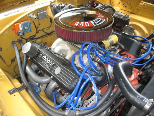

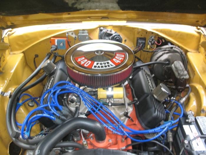

Some pics
The 383 was replaced with a 440
d21 on fender tag shows factory 4 speed
99 99 special order paint (Bahama yellow?)
RM21 Coupe

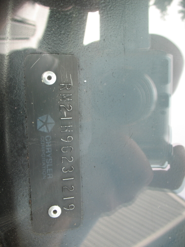

The vin is RM21H9G231219
So the stamping number should be 231219?

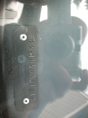

It might be just me but your vin rivets look different than mine. The ones on my car are thinner, black, and the center hole is slightly bigger on mine.
I see it too welder the rivits look new, and they don't look right.... fender tag screws not painted... zinc & clear unpainted screws...

Rich the body stamping numbers you are looking for on the core support and trunk lip are the order number of vehicle , not vin. These order numbers appear on the bottom of the fender tag. Those rivets on the dsash vin are definatly not correct. I would be suspicious. I just restored my dash and had to spend 51.00 for correct rosette rivets. I know however that my car had never been dissasembled before me.

It might be just me but your vin rivets look different than mine. The ones on my car are thinner, black, and the center hole is slightly bigger on mine.​
Those are standard POP rivits..... There is no doubt that vin tag has been removed... The body numbers will verify the authenticity. Trunk lip stampings and the core support stampings should match the VIN on a 69. (Core support will be stamped on the drivers side and can be stamped on the top or on the engine side and read upside down.

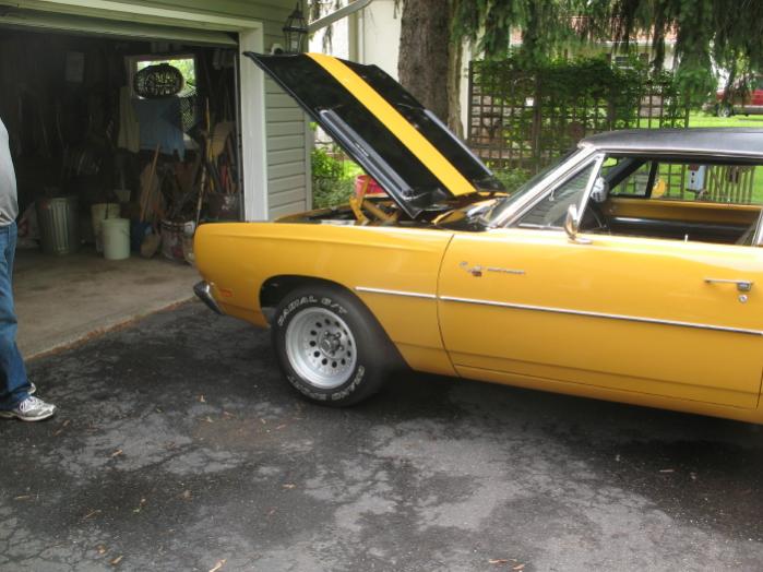

Also... 999 is a special order paint code. Bahama yellow (EL5) became avaliable in April 69, The 312 build date is before that.​

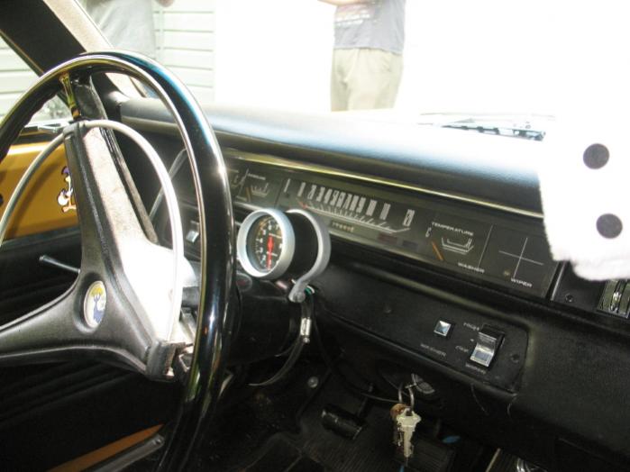

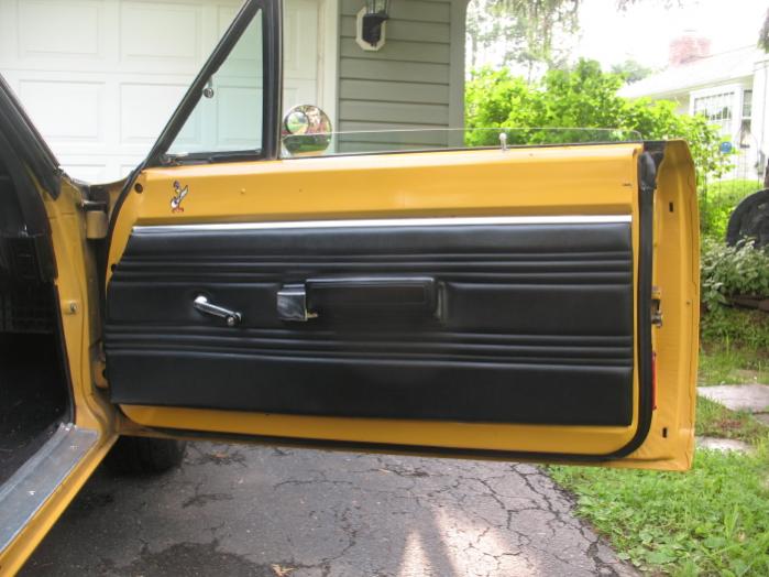

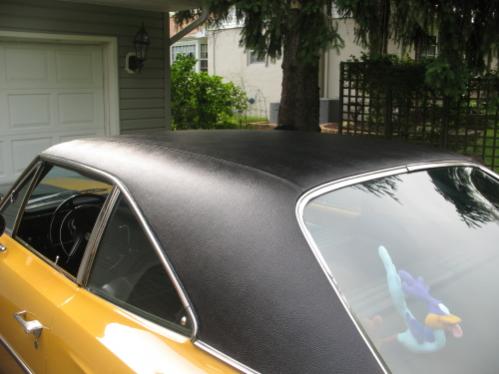

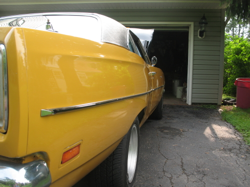

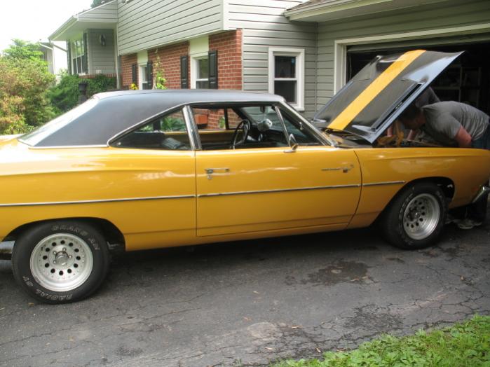

(Prop wash) Yes, someone added mid body trim. It is riveted on. Also, another weird modification is the radio antenna has been moved from the front to the rear quarter. I have no idea why someone would have done this.
(Blue Fury) It has front and rear sway bars front disc brakes and there are frame connectors welded in.
The current owner lives in PA and he bought it from a guy in NY. The guy in NJ claims that the car came from CA and at one point was a drag car.
I know it will never be a show car. I am just planning to cruse around to the shows and enjoy. I just want to make sure that it is a real Roadrunner. I expect that after 42 years a lot of changes were done.

Here is a quick clip of the motor running.
http://www.youtube.com/watch?v=Y8fUpeUmkoE
(Prop wash) It does have mid body molding someone added it and it is riveted to the side of the car. Also, someone moved the radio antenna from the front to the the rear passenger quarter.
(Blue fury) It has front and rear sway bars. It has front disc brakes and welded frame connectors.
The car lives in PA right now and was bought from a guy who lives in NY. The guy in NY allegedly bought it from a guy in CA. At one point in the car's life it was a drag car. I added a clip on youtube but the moderator has to approve it first
The Vin, fender tag, title and now it is confirmed that the radiator core support match. Would this be enough evidence that the car is in fact a real Roadrunner?
