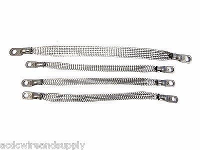

I used two, going from the bolt on the back of the passenger side head to the bolt on the ECU and to the bolt on the voltage regulator bracket.
BTW bonding is a supper common term in construction, when you connect the electrical panel or the steel frame of a building to a cold water line or ground rods your bonding to earth ground.
