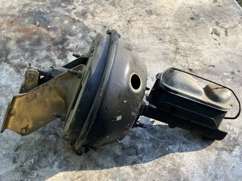

My 65 needs a brake booster. I am having a hell of a time finding a direct replacement. Looking for pictures of what people are replacing the stock one with.

This is it
Oddly, that looks like a single diaphragm unit, similar to the A body disc/drum booster from 1973-1976.
The vacuum line on yours is different. Notice how forward of the band clamp, the case tapers down? The A body unit does that.
I don't have anything exactly like yours. I wouldn't waste your time trying to sell you something that is just close enough that it wouldn't work....
Maybe sending it out for rebuilding may be the best choice. The alternative is trying to find an original unit that is 58 years old and hoping it works.
That is a Midland-Ross booster. Have you tried RockAuto? Can it be rebuilt locally?

Thanks for the Booster Dewey heads up. They said 2 week turn around
