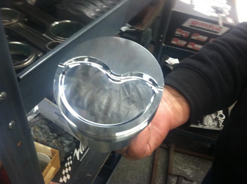

pump gas today is not the same pump gas 10 years ago. i'm building a 493 aluminum head pump gas motor and my engine guru decided to go with a icon piston ,with a final compression ratio of 9.7 with a 84cc camber i can run today,s pump gas all day long and not worry about hammering my bearings to death. street car is the key word.$3 and change is better then $ 13 bucks a gallon i'm not chasing 10th's anymore. all them cubes should make up for a 1/2 a point in compression anyway good luck p.s. thanks for the converter :-) IMG_1639.jpgIMG_2262.jpgIMG_2344.jpg
There is nothing wrong with your comp as it all depends on the build. If its a street car like yours and will run on this crappy pump gas we have then it will depend on alot like if the eng has quench and the cam that is used as that has alot of effect on cyl pressure. On my 493 I use Indy EZ heads wih the Indy dual plane intake myself and my heads are 75cc's. I am using these 440Source D-dished pistons you see here to keep my comp at 10.6 and still have good quench. I run a good size solid flat tappet cam that keeps my cyl pressure low enough that I run on 92 pump with no problem. If your cam does not have the intake valve closing timing and the other specs in check with cyl pressure then that may be why your eng builder decided to go with 9.6 on your eng. Actually with a smalller cam it wont always knock the cyl pressure down enough as you cant run as much comp with a smaller cam since it wont have an intake valve closing to keep cyl pressure in check for pump along with all the other parts and specs on your eng. I would say if it runs strong and has no ping I would not worry about it as even if you changed it to 10.5 or about that it wont make the car that much faster. You may be talking about 20 hp or so and may be a tenth or so in the 1/4. And you could also talk to your eng builder and ask him why he went with that comp but I do see many street strokers with comp in the mid 9's. Ron
