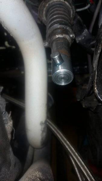

Just installed a borgeson steering box. Instructions tell me to cut the steering column, but mine is to short?
What do I need to make this work?

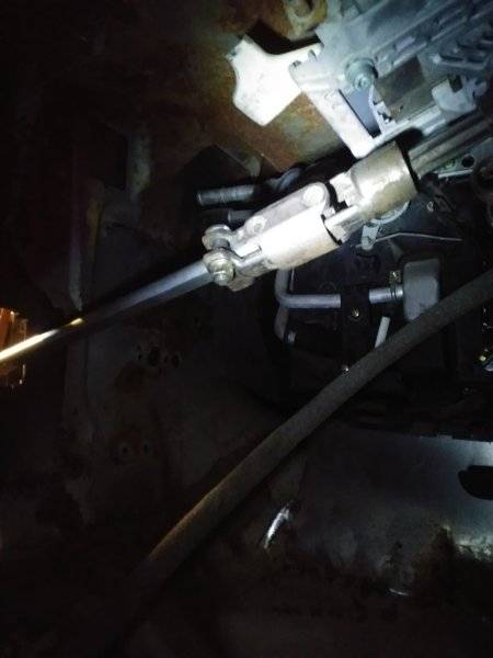

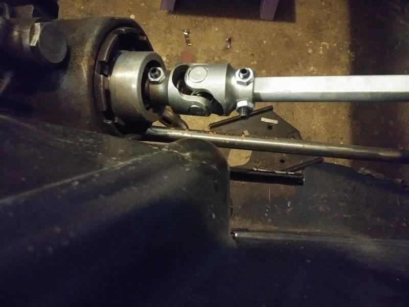

Look into the end of your column and determine what shape the hole is. Is it a DD with two flat sides and two rounded? If so, measure it to see what size, 1/2", 3/4"? Or is it splined? If so count the splines and how wide the hole is, 5/8", 3/4"? Your steering box should have info on the size of the spline of the output shaft. MOPAR is 5/8" x 36 spline, MOPAR ( Chrysler) only. There are other 5/8" x 36 spline which will not fit, needs to be MOPAR. Once you determine both ends then consult Borgeson for the correct U Joint with the correct steering shaft in between. Done. Oh, and once you get to ordering the shaft get one that is long enough to bridge the gap and trim it up once you have the right u joint on the output shaft of the box. I just finished mine.

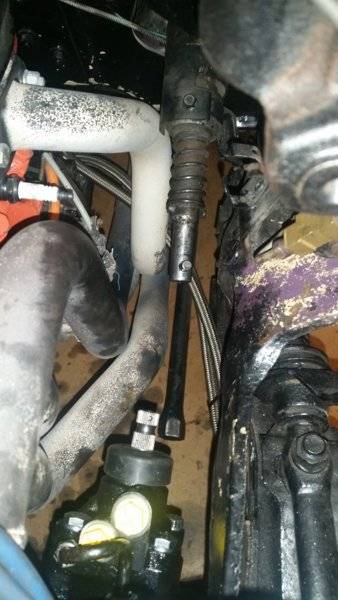

When I look at your installation it seems like I need 2 u-joints and a short shaft between?
End of my steering column is round, no flat sides. If I order one u-joint with 3 holes and drill holes in column shaft, put a shaft with flat sides between and one u-joint with borgeson fittings. Would that work?

I have replaced the rubber with poly, but maybe you are right, it will probably be some movement there. Is that why I have a spring at the end of my column? Maybe I could take my stock coupler on the columnside and weld a double D shaft to it and a u-joint on borgesonside?

You mean to say the end of your column is just a round nub? Not hollow with splines or a smooth hole? If so then yes, you will need at least a straight coupler and a u joint off of the box shaft. Is the column tilt? Telescope? Mine is both as it is out of a 2006 Audi A6 and it's in my 67 Coronet. The u joint off the box shaft will give you a bit of give for movement. Mine has a u joint at the top as well because the Audi steering wheel assembly has tilt and telescope and has the u joint attached from the factory to allow for those movements. If your column/steering wheel does not move then I expect you only need the u joint at the steering gear box end. Remember to drill out a small depression anywhere you use a joint that has the set plugs with lock nuts. You need a place to seat those plugs as you tighten them down. Don't want your stuff to vibrate apart while zooming down the road.
The Borgeson box is only an inch or so shorter than the stock power steering box, so I have read. Why is there such a big gap there. Did you remove the stock steering box from the car?Is the column pulled back? The conversions that I have read about use the bergman coupler and it just bolts together like stock
Now I see. There is some form of rag joint in between the box and the normal coupler. Sorry for my ignorance.
I'm guessing a bit here, but you might be able to weld a borgeson splined coupling to your rag joint, and make it work.
Ahhh…...you have a rag joint with a shaft that bridges the gap. I see. Then depends on what the ends of the rag joint and shaft are like. If the rag joint upper end is a splined shaft you can get a coupler with the splined hole for the shaft on one end and a smooth bore hole to fit the upper end and weld it on.
