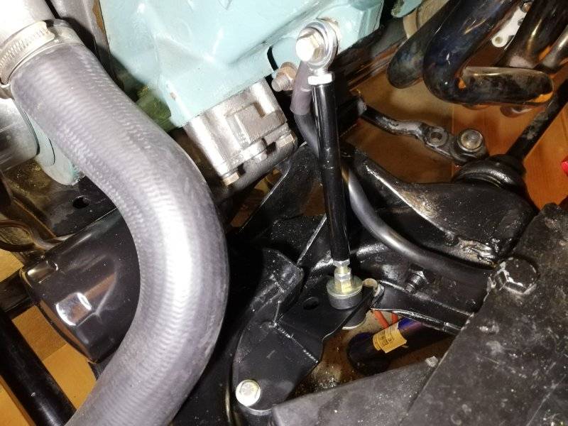

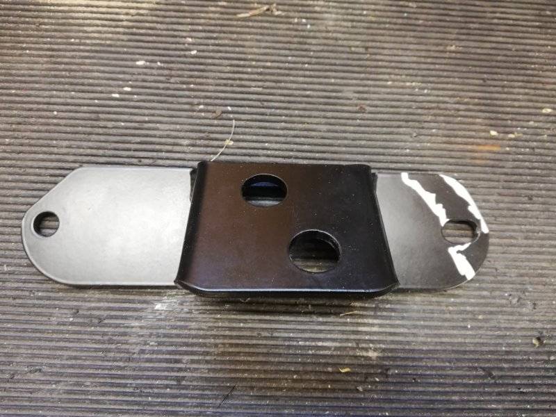

Now when the steering box and pump is out, then it is a good time to install the Schumacher Torque Strap.
At walking speed or standing still and turning, my engine vibrates so that my headers hits the torsion bars and make this loud "GRGRGRGRGR" sound thats quite annoying. I hope that a torque strap could keep the engine a bit more still at those speeds.

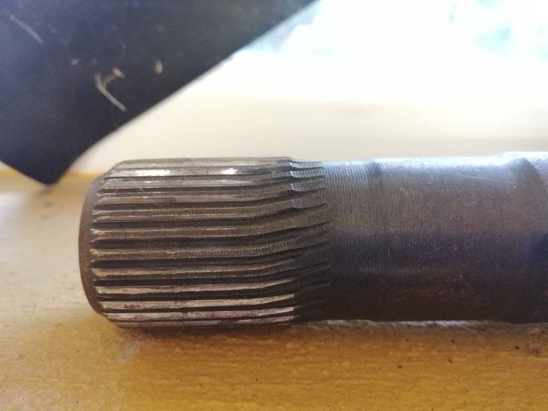

(...I dont have a monster motor but it does have a lot of bottom torque...and I am still wondering if it was I that twisted a drive shaft?)
The Schumacher strap looked like the solution that I wanted with a type of sway bar bushing at the bottom bracket.
It does come with an angled bracket for RB blocks in a B-body.
Dry fitting and measuring I noticed that the strap fit like on the A-body illustration above without that extra bracket, especially if I could move the big lower bracket closer to the engine and closer towards the rear of the car.
So I decided to cut the bracket to not have to use that angular bracket.
The rod can now rest relaxed in the middle of the hole and have less angle than on the installation instruction pic.
So, fully installed on a RB block in a B-body:
...now lets move on with the steering stuff.

Well, heck, man....if those twisted axle splines are yours, I guess you're making a LOT more power than I am!

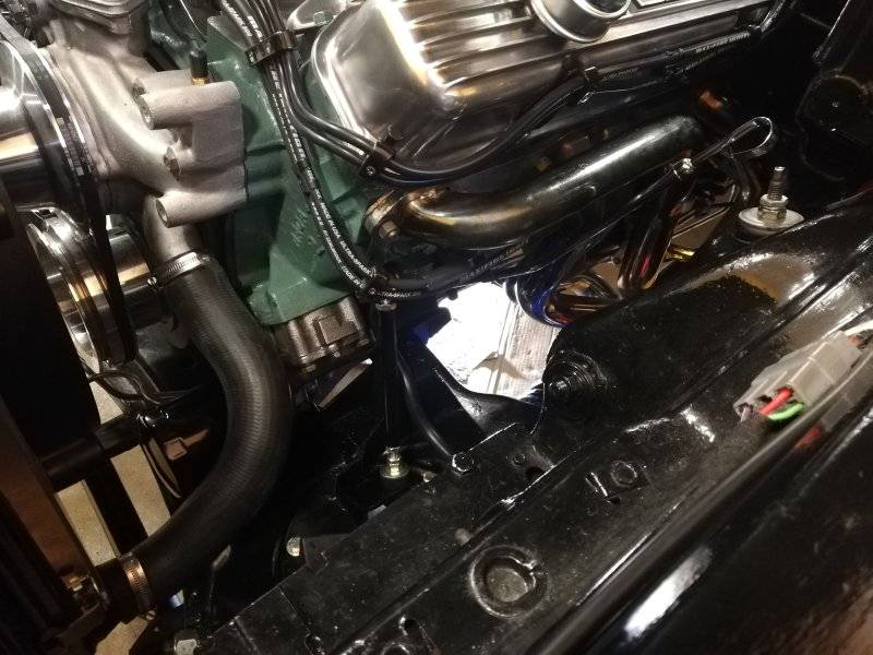

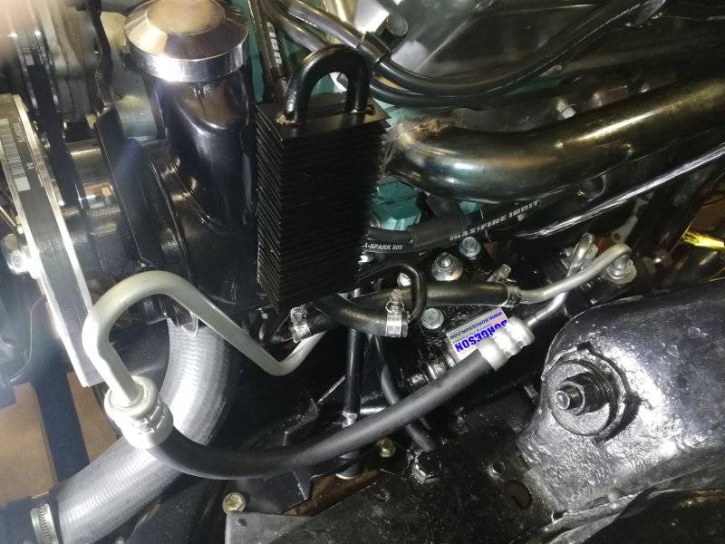

Headers (Dougs) are torqued back in place. Theres lots of space now between the header tubes and the box, the box can be installed and removed without touching the headers. One win. :thumbsup:
Test fitting the box, pump and hoses. Fits good with lots of space for the torque strap and ign wires.
Though the inlet for the cooler hits the pressure hose and I would also like to change the angle of the inlet to better meet the box outlet.
Lets take the cooler off and do some massaging again.

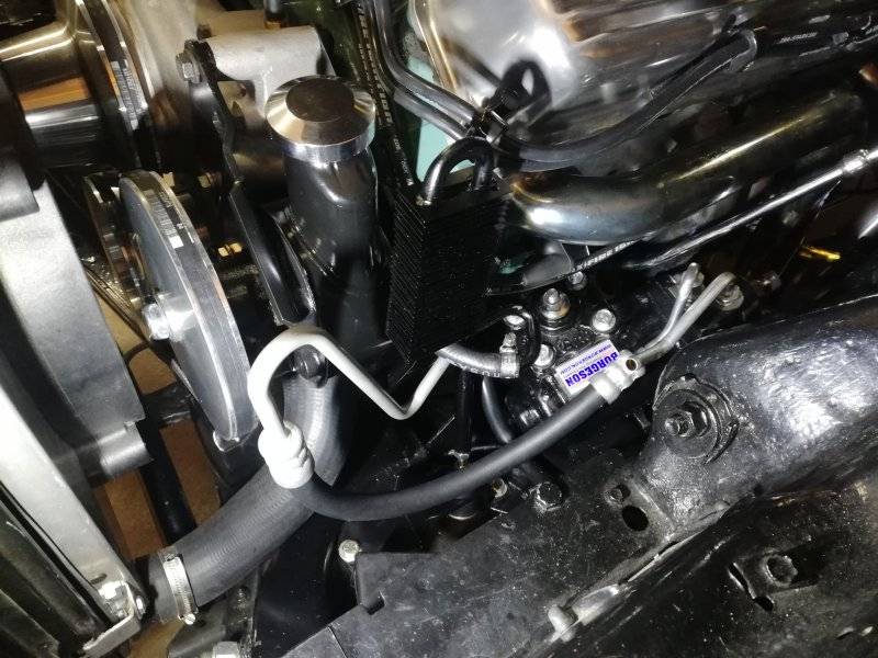

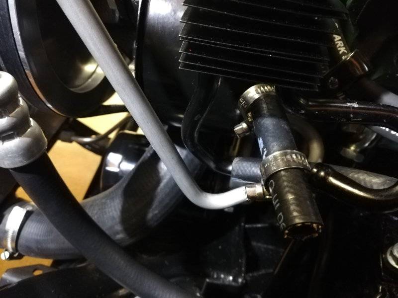

Ok, some bending of tubes and we got a nice gap between cooler line and pressure hose. The rubber hose is also not rubbing against the pressure hose metal tubing.
Everything sits straight and relaxed before tightened.
I also added a bend to the return line from the box to meet the cooler better.
But kept the upward angle as to make a curve of the rubber hose so that it can move with the engine.

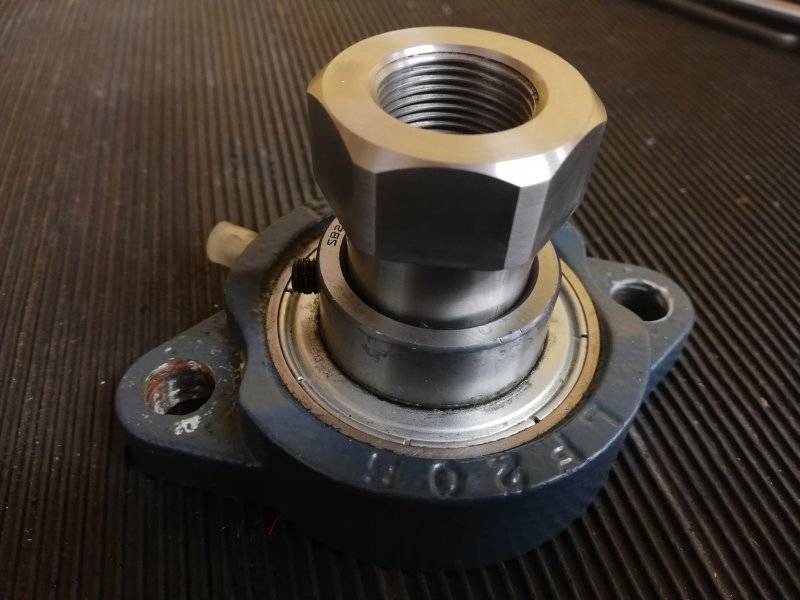

I have made the nut for the sector support to a borgeson unit.
i think i have 2 or 3 left.
A forum like this can be a life saver.
Here comes Joske2 and ships a custom nut to me that has a metric thread to fit the Borgeson box and super exact size to fit straight into the sector support bearing.
Huge thanks Joske2. :thumbsup:

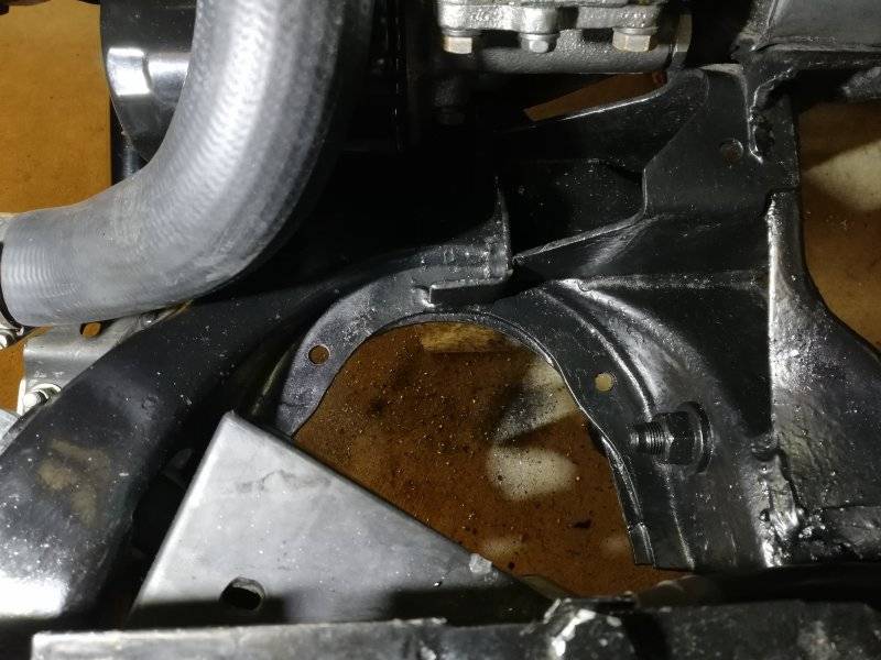

One step forward and two steps back.
The Borgeson box does not sit at the same location as the original box.
So now my sector support is off about 1cm.
Time for some coffee and think about what the solution will be. (I do not want to drill in my K-member again.)

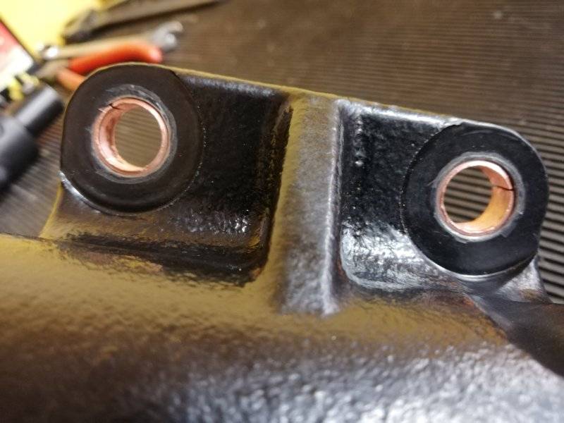

The bolt holes in the box are quite bigger than the bolts, so will see if I can make some centering rings to get the box to sit closer to where it should sit.

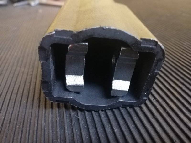

Update on the shoes.
There is some grading at the edges, so I tested to fit the shoes a bit further into the coupler.
The new shoes that I bought when putting in the FF box did still not fit.
...though my old originals did!
And they move smooth with no wiggle.
Another one of those "Always keep your old original parts"
All good. :thumbsup:
Centering rings made out of copper tubing.
When putting the box back the holes lined up perfectly with the centering rings and the box doesnt "hang" on the bolts anymore.
Torqueing down the bolts to 55 ft lbs went smoothly.
