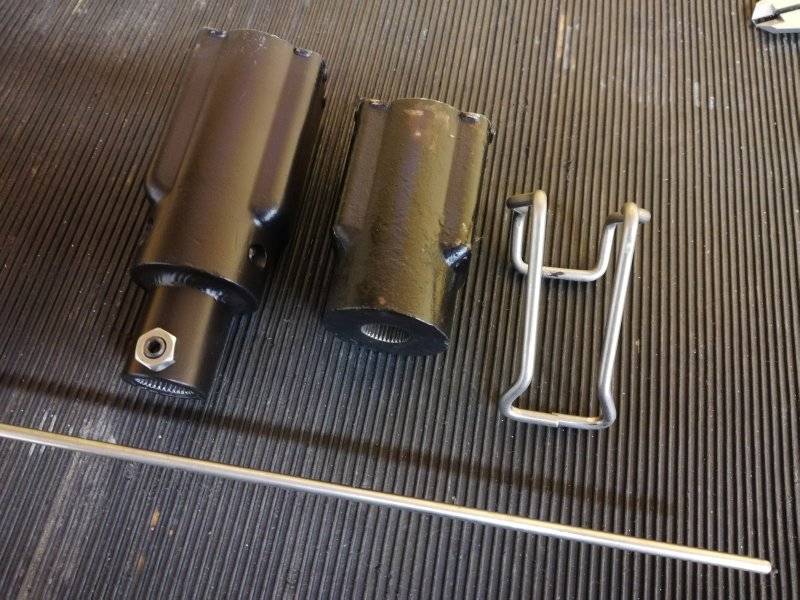

Coupler time.

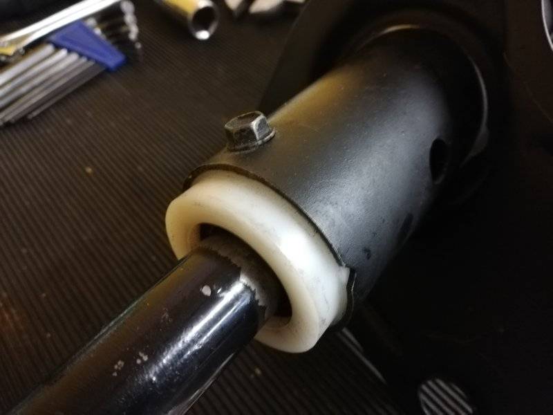

Dry testing I noticed that the deeper Borgeson coupler could come off without the steering shaft moving backwards.
It was a quick test and I hope I am wrong.
Though to make the coupler more secure I wanted to take advantage of the groove that already exists on the spline.
I drilled a hole and used a smaller pin than original, still it is rock solid.
I placed the hole a tad towards the rear, in that way the pin pushes the coupler forward.
I also cut off a bit of the long locking screw.

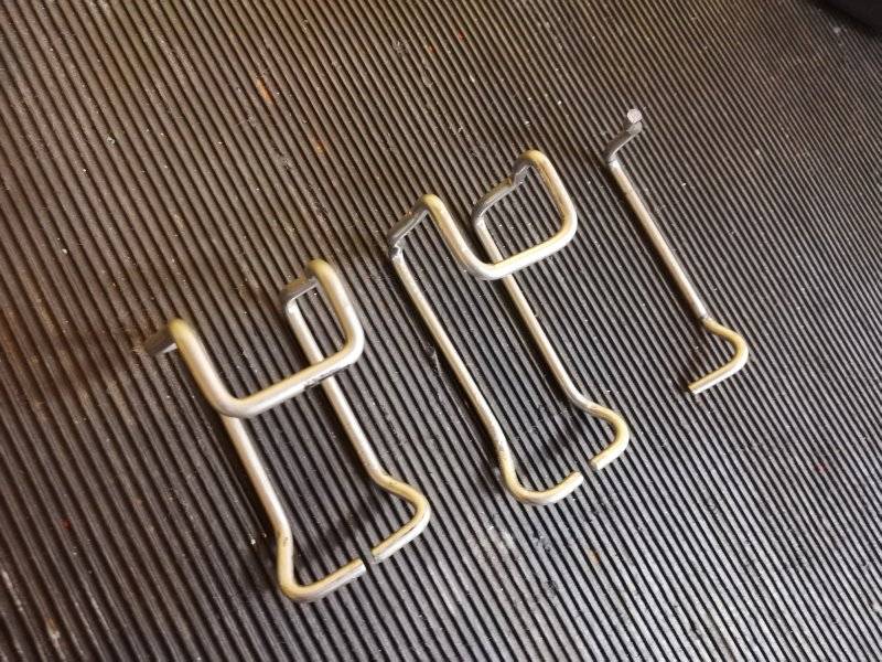

Went past a metal workshop and got a stainless piece that has the same thickness as the service clamp.
The service clamp is the best thing for the coupler since sliced bread, time to bend a new one to fit the longer coupler.
The stock roll pin hole is redundant with the Borgeson unit. No need to put anything in it. The allen set screw and 7/16" lock nut are what secures the coupler to the input shaft on the steering box.
I put the original roll pin in the original hole, just to get the clamp to line up better.
The roll pin in the pic is in a new hole, on the opposite side of the allen set screw.
This new roll pin take advantage of the groove in the Borgeson splines.
Double secure. :thumbsup:

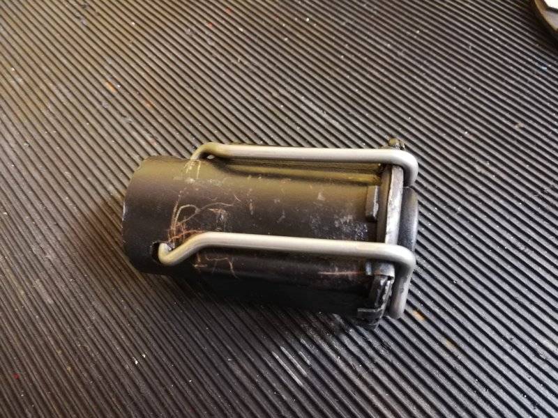

Making the clamp was easier said than done.
This was some really hard stainless steel so I had to bend carefully. Redoing one wrong bend was a no go, the piece to the right is evidence of that...
The longer Borgeson coupler is based on the longer mopar coupler for manual steering, the longer manual coupler is needed to sit at the same height/place towards the firewall as the Borgeson box is shorter than the original box.
Good test fit at the end so now its time to put the coupler together.

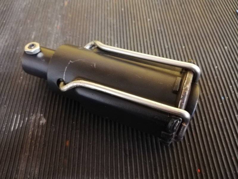

Assembled the shoes with the spring and greased it up with long lasting bearing grease.

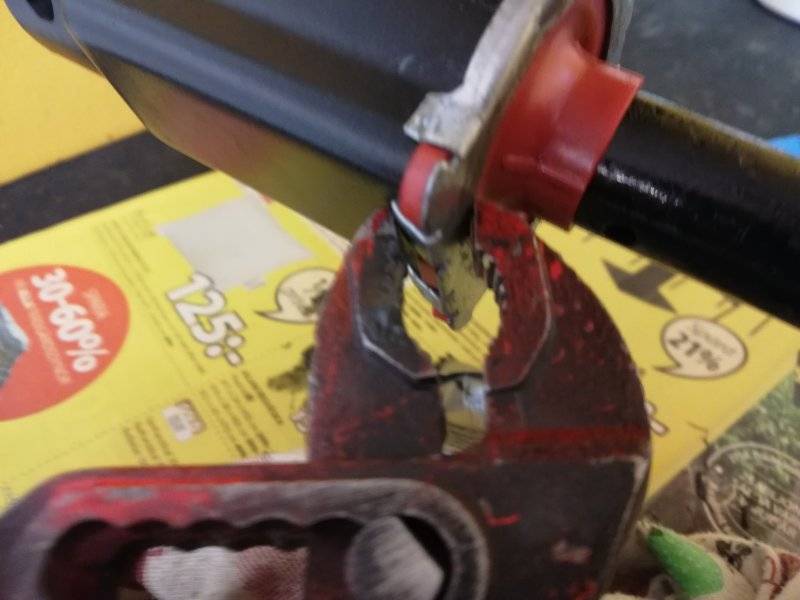

Got the cover to stick using Kerns trick with the plier.
I also added the small pin for extra safety.

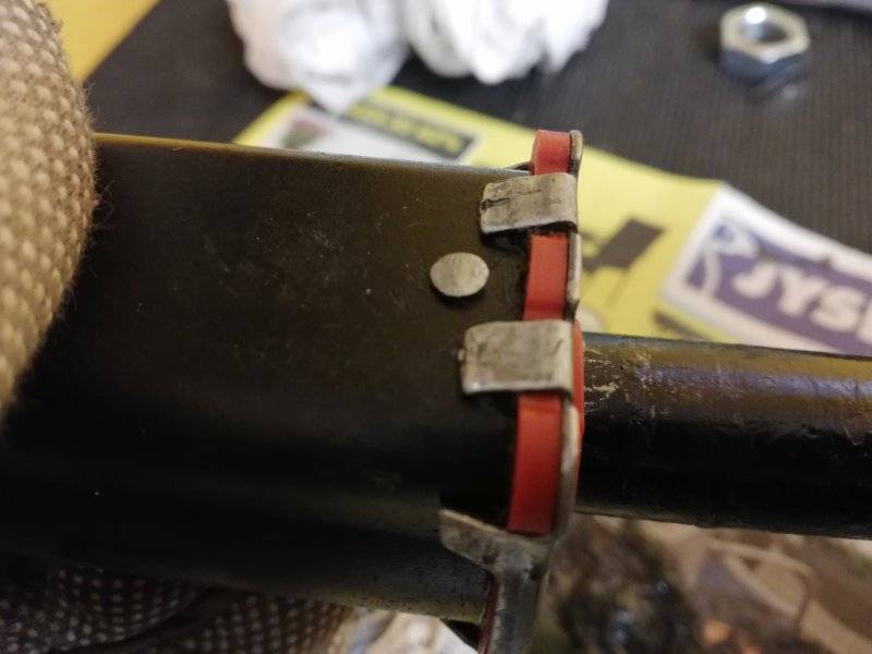

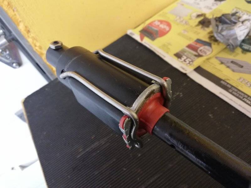

I put the coupler cover 21mm (13/16") from the small measuring hole (According to the book.) and checked that everything moved smoothly at that distance.
Adding the new clamp was a bit tricky as the new cover is wider than the original cover, so some minor adjustment had to be done to the clamp.
Is 3.5 inches long enough?
Mine is 3.5".
Also, they do make/sell repops of original parts and our longer coupler is the original coupler for manual steering, so a qualified guess is that this is the original style service clamp for manual steering.

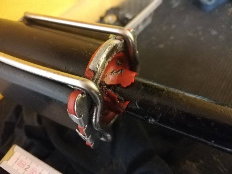

I did order a set myself as I need a better rubber cover, mine cracked when the coupler turned towards the Borgeson splines.

How exactly did you destroy that rubber piece? That is not easy to replace, unless you've got a hydraulic press to push the cross pin out. I'd take the whole steering column apart again before trying to hammer out the cross pin. Maybe I shouldn't, but I've banged on mine a few times and didn't get it to budge.
Well I hear smaller guys get to use it all, but can't confirm.
Now that I've gotten the chance to measure, 3.5" sounds spot on. If I can find one for less than $90 I'll be set!
edit - I see that Roseville might sell it separately - I've sent them a message to see if they actually have it in stock.
When installing the column the angle was too steep into the coupler, so the rubber cracked.

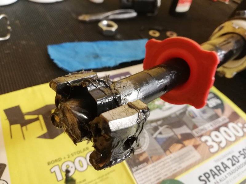

This was cos the steering shaft was too long.
After I took it out again I noticed that the shaft had moved out from the bearing.
I painted the shaft all the way in to the bearing but now an unpainted area could be seen clearly.
So the shear pins must have snapped.
So, the only thing now is to take the column apart again and fix new shear pins.
