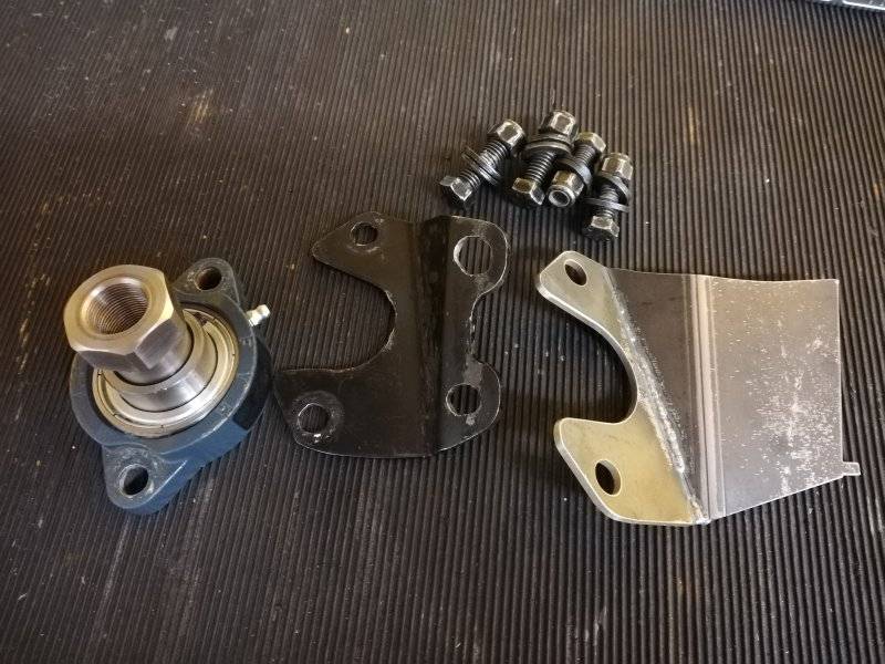

Though went and made a new bracket for the sector support so I can start over with the holes attaching to the K-member.
The sector support is redundant at this point. The Borgeson is so much smaller and lighter, the support won't add anything but weight.
..and isnt that why the sector support is more needed now?
And I believe that to stabilize the lower end of the shaft can never be a bad thing.
No, if you don't strenghten the original steering box support on the K-member, like Kern Dog did, you will see it move without the sector support, especialy with wider front tires.
People don't reinforce their K members???

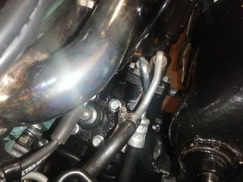

And finally the sector support is installed.
That was not easy but in the end when everything was tightened down (except the allens.) I could turn the bearing by hand. No binding here.

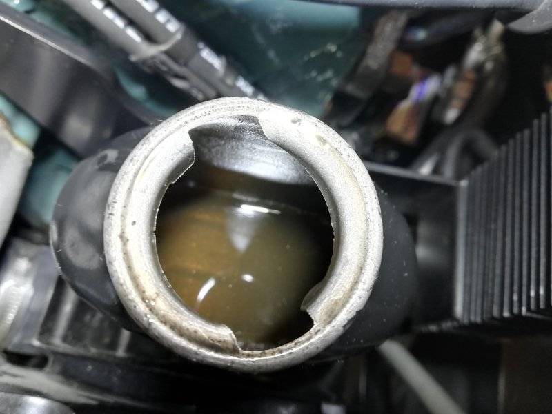

Bleeding the system 10 times right/left slowly then 10 times really fast....checking the oil my heart sank a bit when I saw all the bubbles...remembering that post about red-line oil foaming....
....though I had gone quite aggressive on bleeding the system, so this could just be all the bubbles leaving the oil?
Yep, after some hard driving (As hard as I could on now icy roads) checking the oil again and it was smooth and clear.
