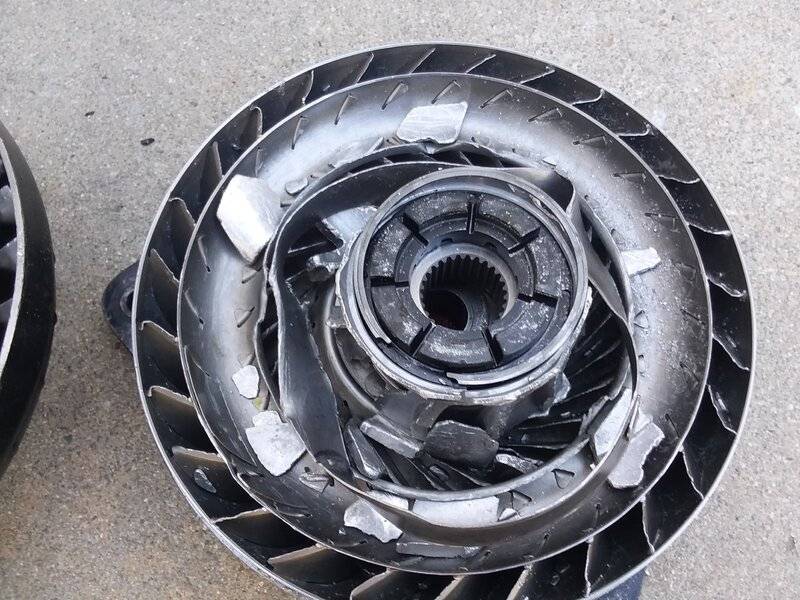

I had one once..... ONCE! In fairness, it was fine behind my 383 that made around 450lbs of torque. I made the mistake however of leaving it behind my 451.... didn’t last long before it came apart and took the transmission with it. Nearly took my 230-400 block When it ballooned and shoved the converter bolts against the back of the block (ugly sound!!!!). Also had to tear down the engine to check thrust Surfaces. Lesson learned, spent some money on a good converter after that.
In fairness, I don’t think it was fair to put a cheap converter behind 600 ft-lbs. it also heated up though, even behind the 383.
Was that a boss hog, or a GER? (I Learned my lesson too. I replaced this one [ NOT a ger! ] with a munsinger.)

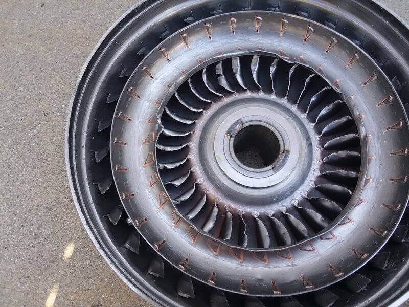

my engine has about 220 h.p. (Most of the TC have hp rating) , i'm guessing i should be fine regards to blowing one up. summit have some of there own and Fti looks good.Any body have any feedback on summit.
I have had 2 bad ones over the last 3 years. The ring on one was chewed up right out of the box!
