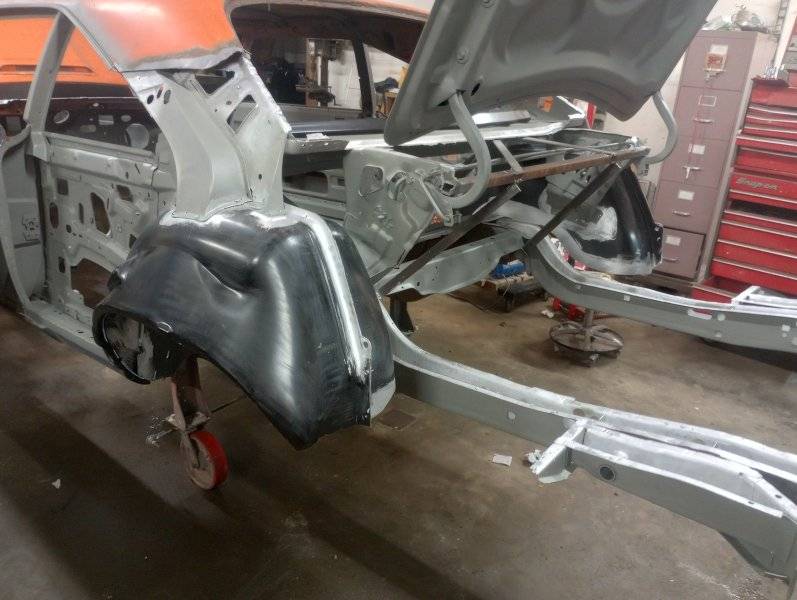

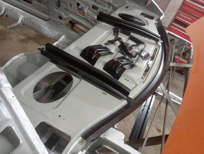

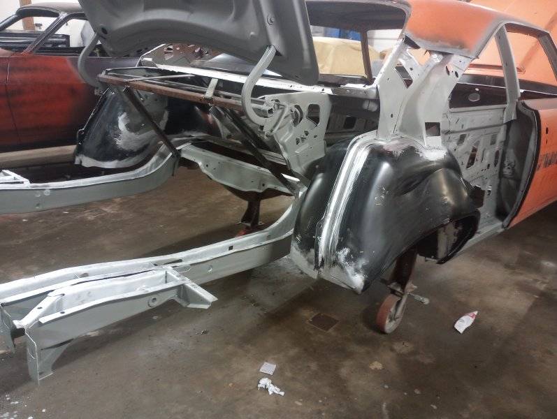

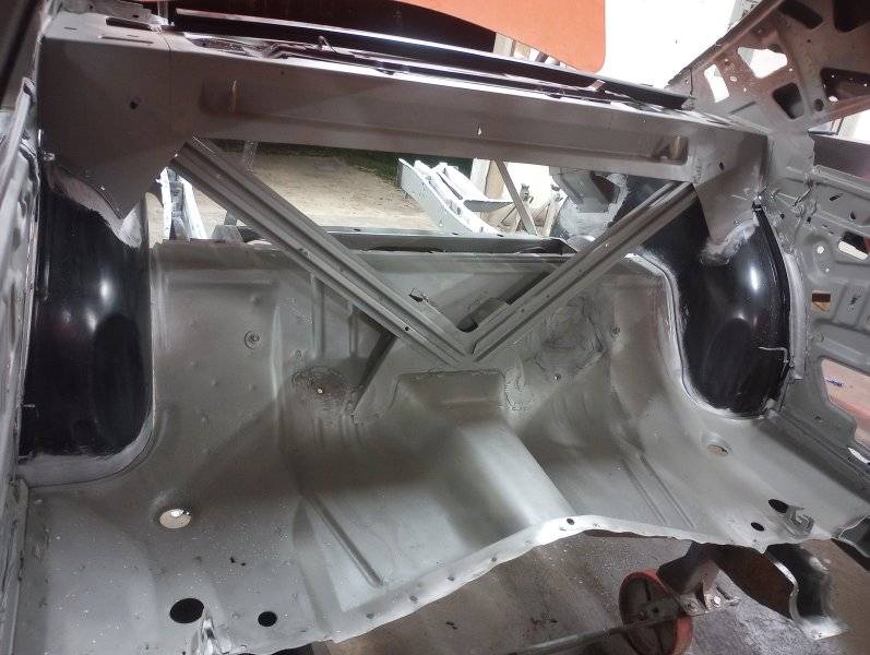

........the weldable primer I use is very watery, and anti rust
I brush it in the rails, it runs under all the little support brackets .......I brush it, and puddle it in hard to get places and blow it in with compressed air, it easily runs into all the seams
