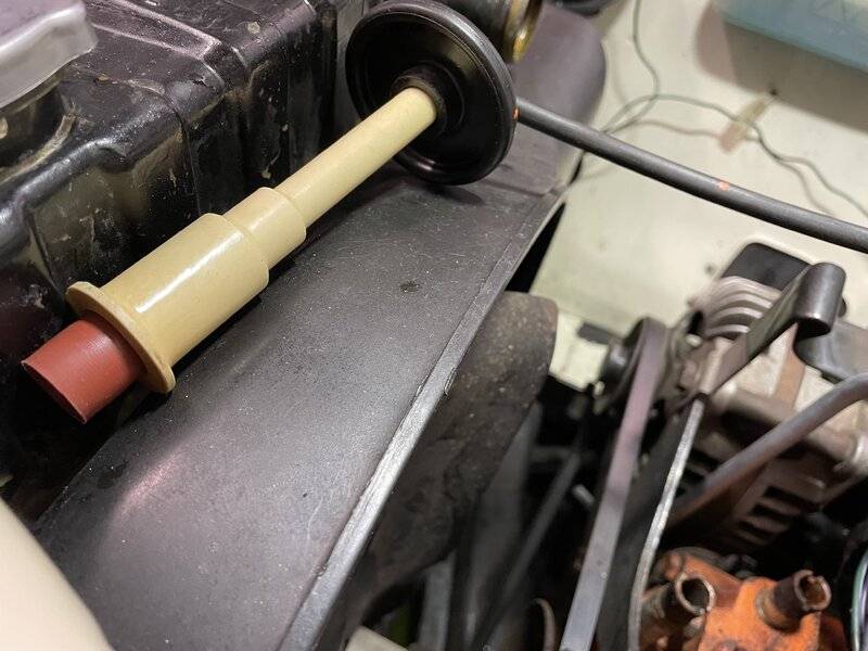

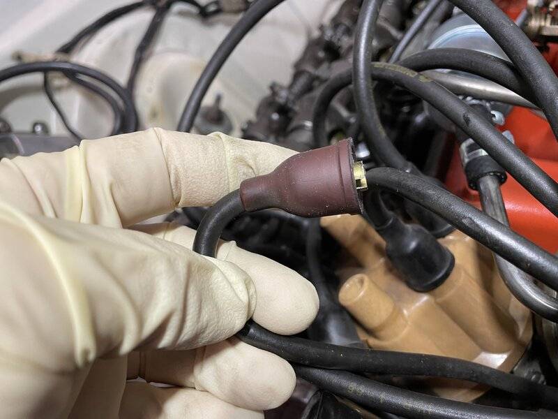

I was told that the original Hemi spark plug wires have a red boot on the coil wire on the cap end & red plug boots.

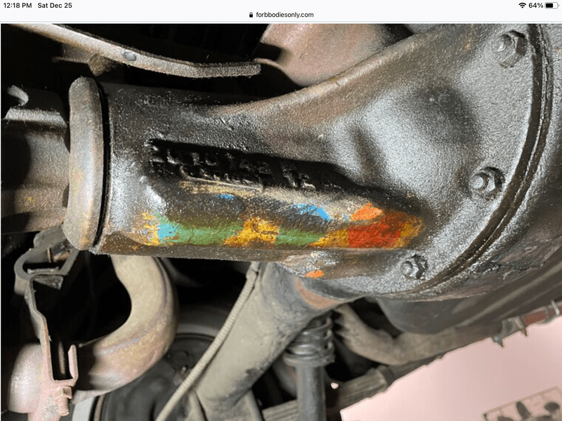

Next time you're laying under it can we see what kind of markings are on the rearend housing???

I saw that but I'm asking about the rearend housing.

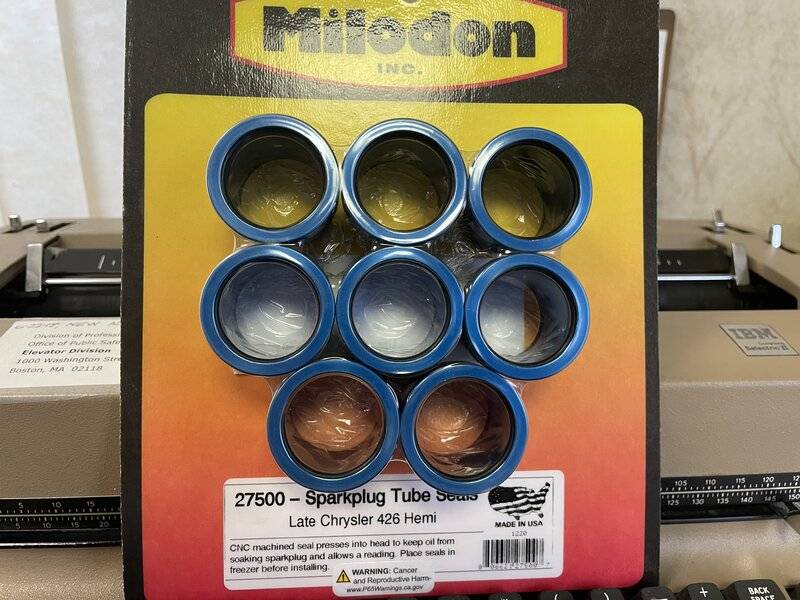

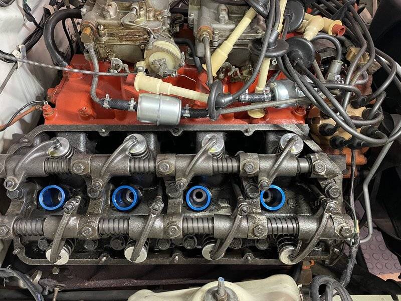

Pulled the plugs & most of the plug tubes were filled with an inch of oil. Got these in today to solve that problem.....

So these inserts go in without any modifications to the head or the stock spark plug tubes????
