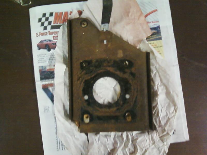

Here is a 66-70 b-body power brake booster firewall plate.
