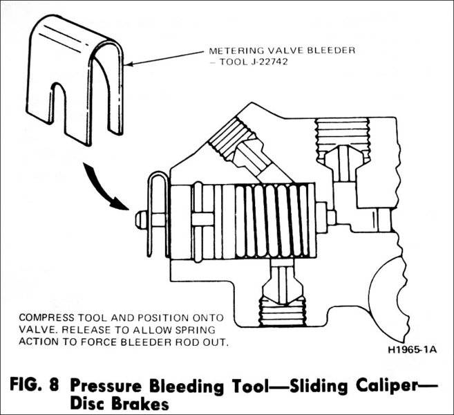

Theres' a brass junction on the rear axle probably...the distribution block should have a line out the front end over to the right & left disc, a lineout to the front port of the M/C out of the top front port, a line out to the rear port master cylinder from the top rear port, and a lineout to the rear of the car from the rear port of the block. When bleeding the block u need the clip to hold the little button pin out from the valve so the fluid goes everywhere during the bleeding. afterwards pop the pin holder off.

Ghostrider- This is the first I'm hearing about a little button pin on the distribution block. Is it the same on a 70 Satellite? I just converted my front drums to discs and next weekend changing the master cylinder and plumbing in a prop valve in the rear line coming out of the distribution block. I assume I will have to bleed the block too based on what you wrote above? I thought that as you bleed each line at the wheel, the pathway in the distribution block would get bled too.

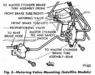

I was looking in my FSM and I think the valve that Ghostrider was referring to is the metering valve. The FSM refers to a special tool to hold open the pin while bleeding. I don't have that, just the 5 port distribution block and the tee in the back to split off the rear drums. I'm plumbing in an adjustable proportioning valve in the rear line that comes off the dist block. That's all that's needed in a front disc conversion according to all the research I did.
Yes, that pin, it's on the metering valve.
I believe this setup is for a 70 Satty with factory front discs. Mine is a drum/drum car so I don't have the metering valve.
