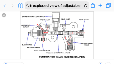

It's not a "proportioning" valve problem, it's simply a pressure differential valve not centered. Disconnect the wire from the combo valve, if the light stays on the problem is in the parking light circuit. If the light goes out, you might have to remove the switch from the combo valve and manually center the valve.
The easiest way I got the valve to center is first put that wire back on to illuminate the light. Then with car off and booster check valve pulled repeatedly stomp on the brake pedal about 10+ times till light goes out and valve is centered.
