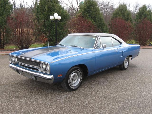

Hey a nubie here i just bought a 1970 off of another forum member... I am not a mechanic but know my way around tools and fixing stuff... grew up poor..
My brake lights went out and the first thing i did was check the fuses and they look good..
I guess there is a wire set up on the actual brake pedal that i should check also right.
Does anyone have any suggestions?
Side note when i picked the car up.. the dome light did not work and one blinker worked sometimes.
