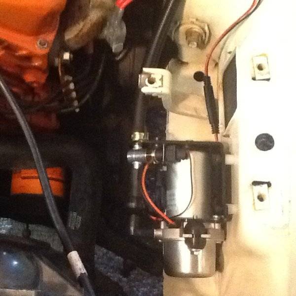

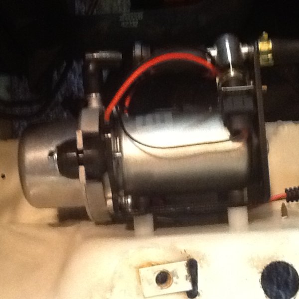

I use a Leeds vaccum pump from PST
This is the one I've been looking at. I just don't want to add any extra holes anywhere to install.
