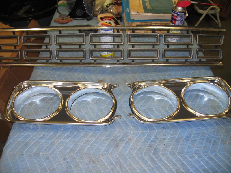

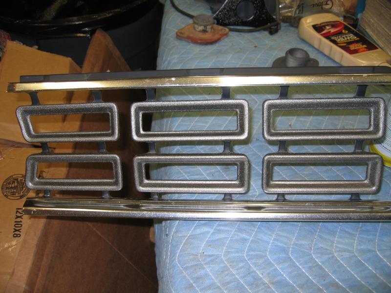

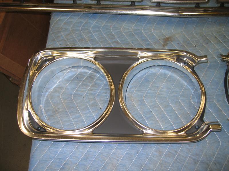

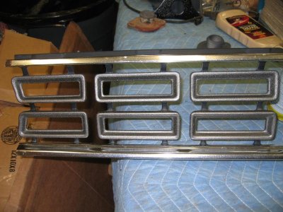

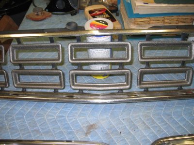

Finally got around to detail painting the re-anodized grill and headlight doors. Used the correct black paint . Also painted the small bars in between the egg crates with the black , as was my broken original grill. I bought the grey argent paint from Total , but I did'nt like the finish that it left. It wasn't coarse enough . I used some Outdoor furniture paint for wrought iron steel from my local Ace hardware store and spayed the grill with it first. I got the finish more like the original. Then I sprayed over it with the Total Auto product to achive the correct color. I did try this on a srcap piece to be sure the differnt paints did'n react to one another. I think they turned out pretty nice , What do you all think?

I'd say that looks very close if not right on. Who did the anodizing?
Meep, Check the beginning of this thread. I sent them to Industrial metal refinishers in Reading Pa. I have info if you need.
