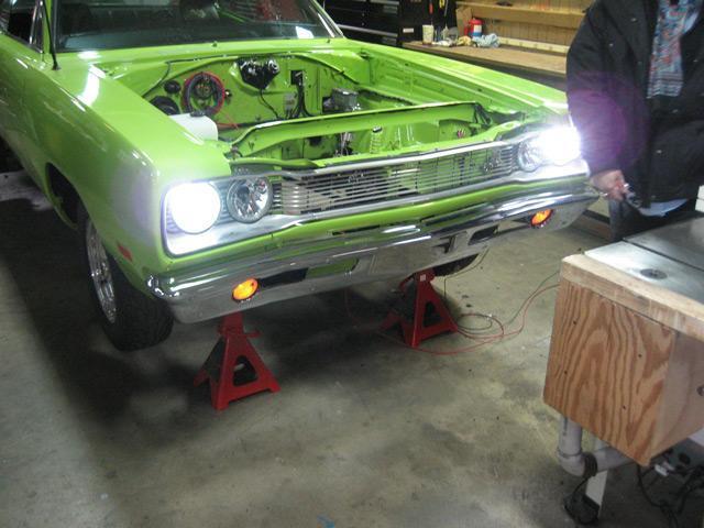

I went with a full conversion. Couldn't see a damn thing on the road at night with the original sealed beams. Most importantly, I want to BE SEEN by other these days! The way they cut you off and such, they think every car out there has ABS brakes!

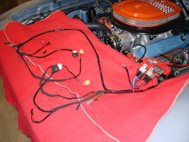

Another approach to reworking the forward light harness;

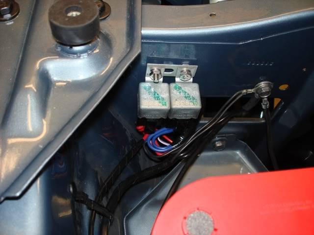

Yah your install is far cleaner than mine. If I had a pretty engine bay and nice paint I think I would have strived for a cleaner look for sure. I actually thought about mounting the relays where you had....For one I could see that its possible for a large battery to come into contact with the relays and either crush or just general vibration wear. Two I found under the batter tray its hidden a bit more. And based on time that I drive it plus relay failure it not a big deal to access them in the event of a failure.
