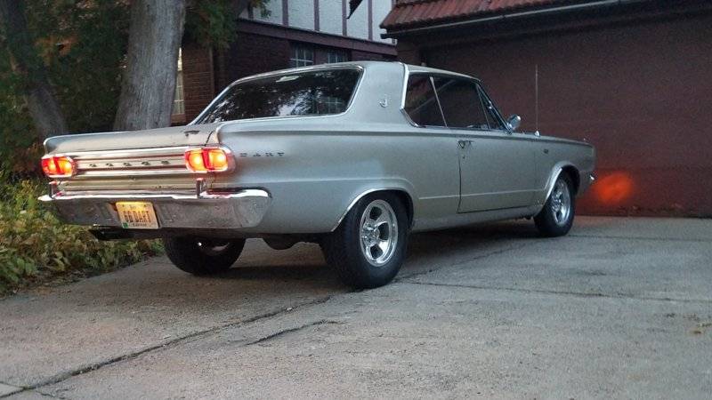

I went from 1157's to 2057's if I remember correctly. They did make a noticable difference. And the photo is the tail lights on taken in the afternoon.
