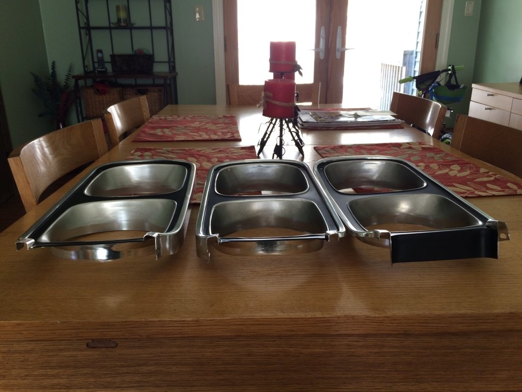

One thing I just found out is that the 69 roadrunner headlight bezels are different than the GTX bezels with the roadrunner bezels having a flat flange that goes in towards the grille. Here is a side by side comparison between the two. The reproduction road runner bezel is on the far right.
what I did find is if you take your time, you can carefully trim down the flat aluminum section that would be on a roadrunner with a Dremel cut off tool, and have it fit a GTX.
Two of the above in the pic are repro's. The one on the far right is obviously a repro. One of the other two is a cut down repro that now will fit a GTX.
