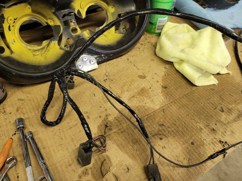

Please tell me you are using friction tape and not electrical tape with glue. The glue on electrical tape will not do well and it will look like crap very quickly.
Just figured I would ask in case...
Using exactly what they used at Clairpointe when they threw them together, which was vinyl electrical tape. It lasted 53 years so far and properly re-wrapped it'll do for the rest of my lifetime. Not exposed to engine compartment heat where it is...

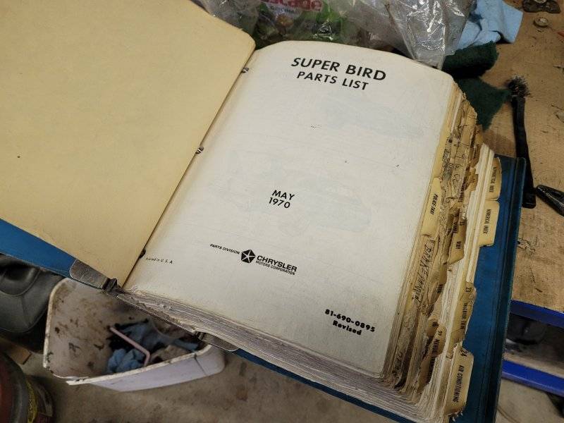

Nothing like the original parts manual supplement.

I've seen guys, rediculously, asking $300 US for these 4 pages. More than I paid for the entire 1970 parts manual.

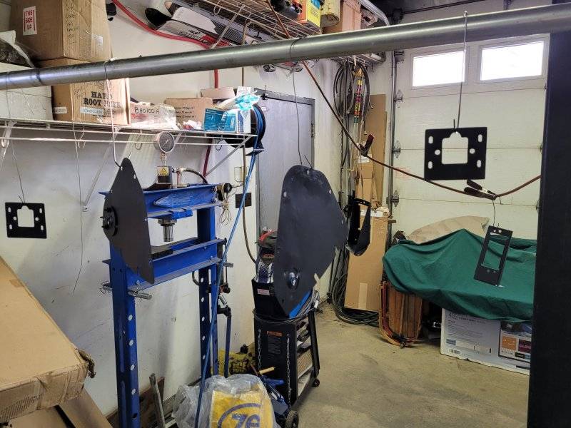

Exhaust fan in the window and a few coats of SEM Trim paint.
Painted and the heat cranked up. See ya tomorrow.

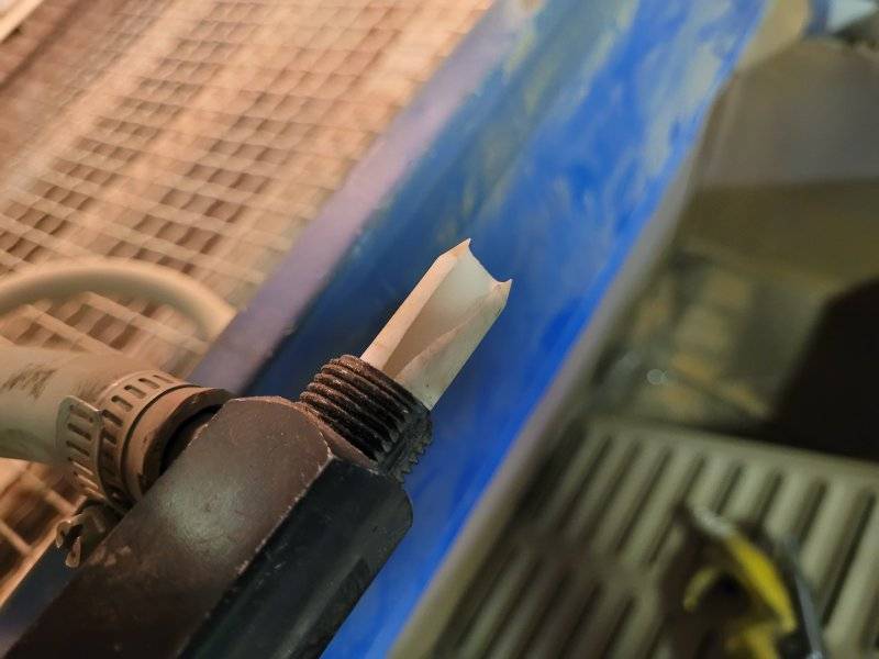

I'd put a new gun in the cabinet last month. It was working great and then it became a fight to get it to remove any paint/rust. Checked the nozzle to find it totally obliterated.
Even the tip retainer nut chewed out. My old gun is years old, did 100's of hours of blasting on other car parts and never did this. Sure it hogged some of the old red ceramic tips out, but never did this or so quickly.

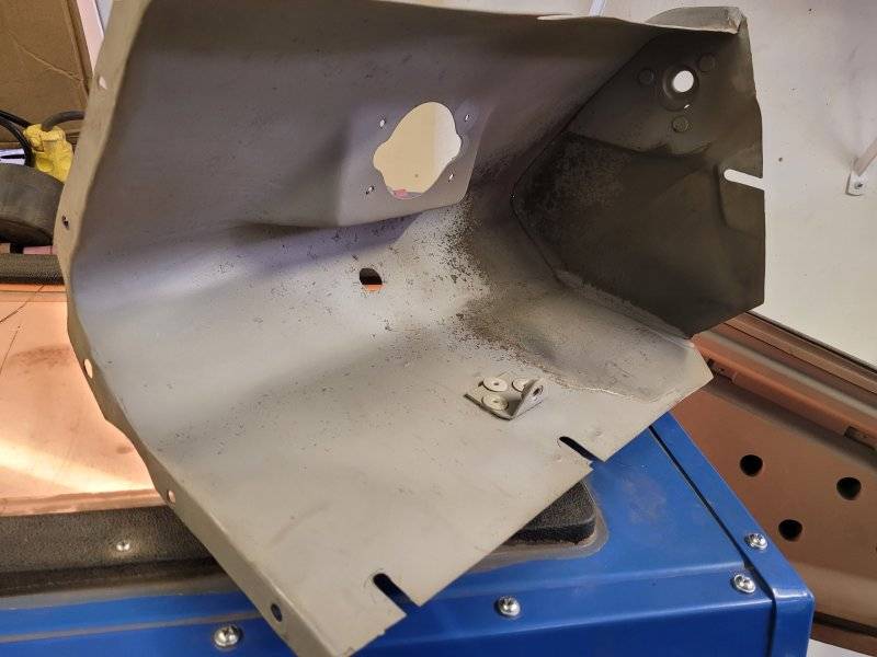

A couple of hours later when I gave up. A small portion of the inside left to go, but cleaning up fairly well.
Couldn't see **** anymore and went to remove the inner peel shield, only to realize there wasn't one there and it was fully sand blasted. Oh well, the glass was broke anyhow.

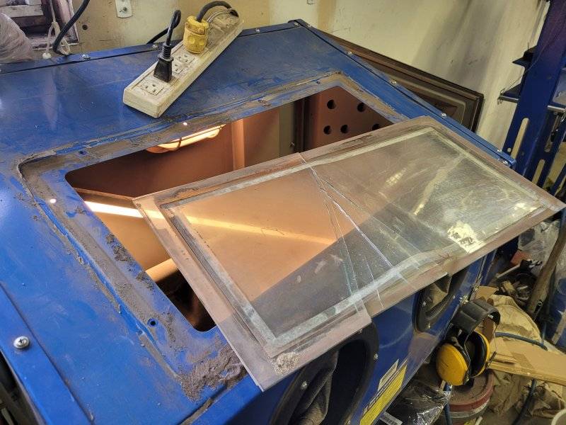

Fortunately I have many 12" wide cut offs of Acrylite out in the hangar.
DANG.... I can see what I'm blasting!
