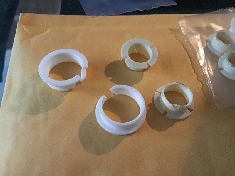

Can’t remember if these headlight door bushings were for my 71 Charger or my friends bird… I’ll send a set or 2 if ya need em. :thumbsup:
Thanks Tom, the smaller ones are probably correct. That said, I bought a set of 10 bucket bolts and 4 bushings some 17 years ago... because I could at the time. Looks like I get to finally use them and hopefully will never need more! Thanks for the offer!
I know you don't need them but if you did McMaster Carr carries the bushings

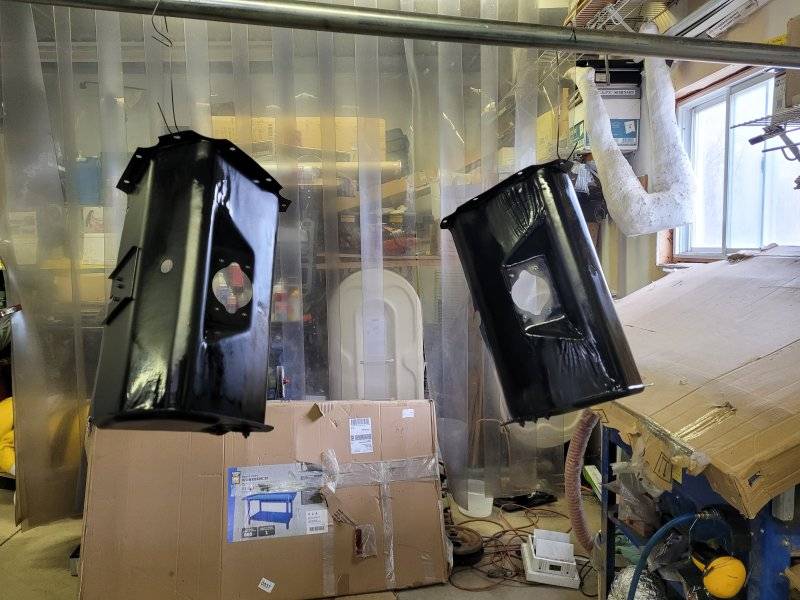

Buckets hung and ready for paint. 53 year old things look like brand new.

Got the first coat on, can ran out and grabbed my last can of SEM trim paint. Of course it clogged, spit and spread like **** so they look JUST LIKE a Friday afternoon Chrysler drunken paint job. Runs yes...

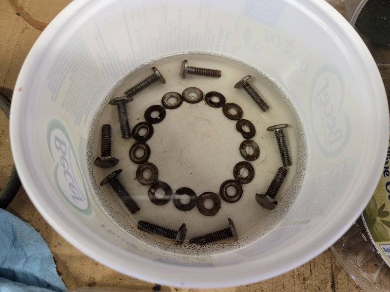

Headlight bucket bolts and pivot bushings that I bought some time ago, because I could. 19 years ago to be exact. Light surface rust from sitting in the bag all this time.
Into Evaporust, along with the spacer washers off of the vacuum actuators.

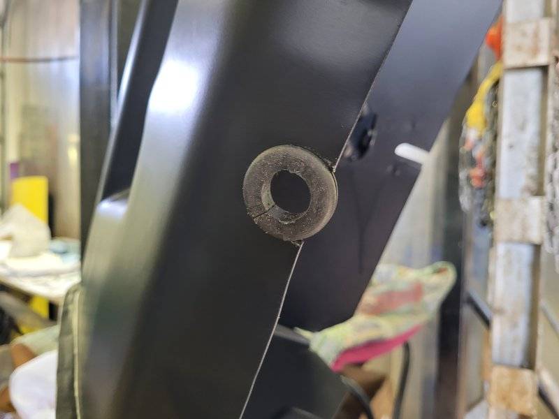

These were missing on my buckets, but I noted them on the assembly drawing in the manual. Found some AN901-12 grommets in my aircraft stock that'll work perfect to protect the headlight wiring and vacuum hose.

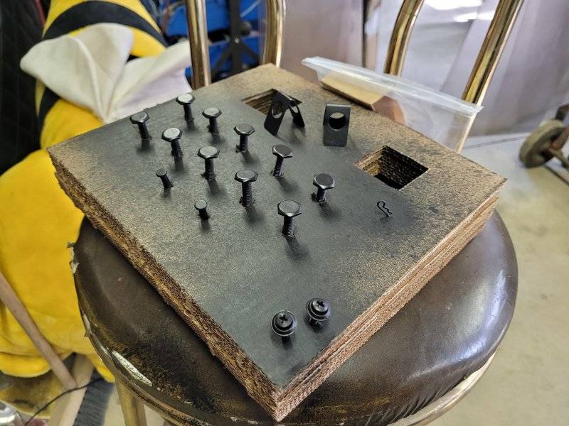

Headlight bucket bolts rust free, wax and grease remover next and then paint.
This way they'll blend in with the black "raccoon eye" black paint spray around the headlight doors.

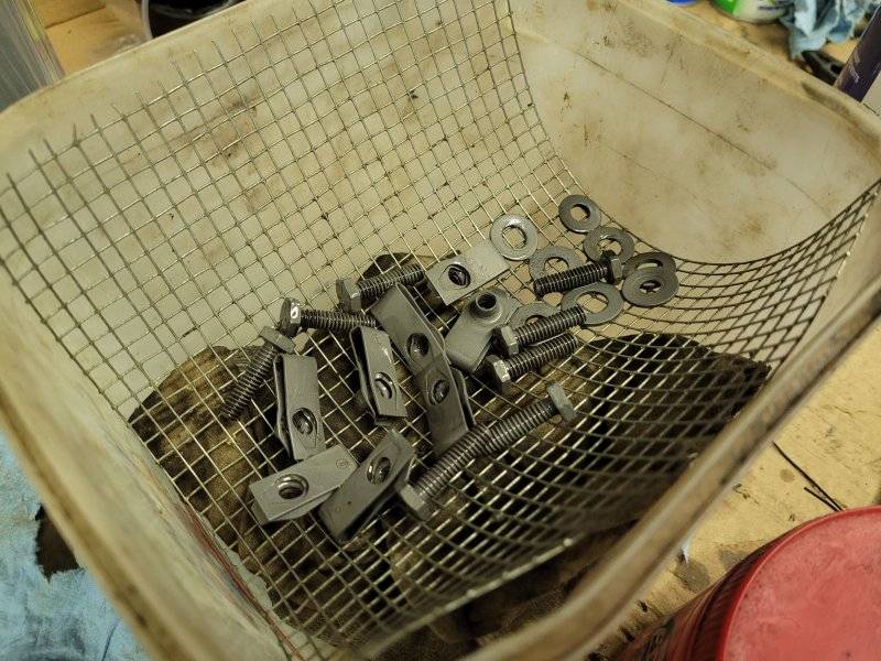

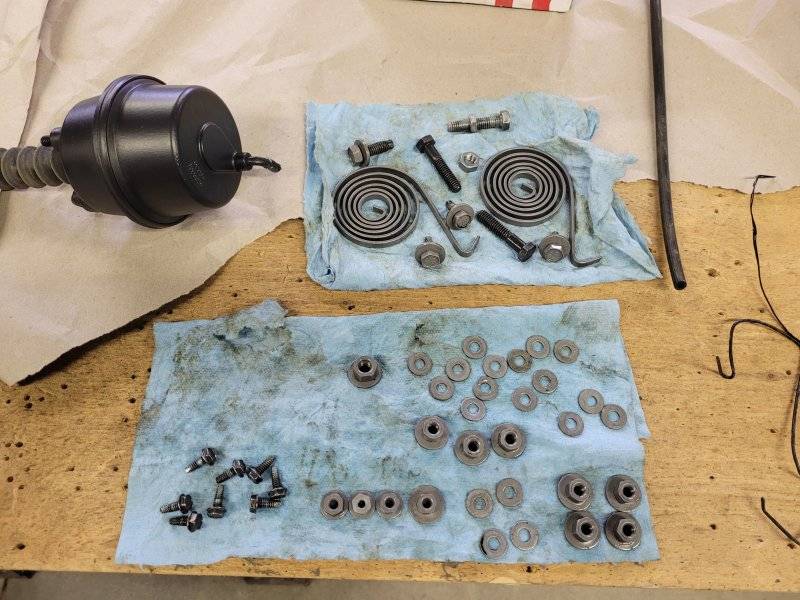

Headlight door opening springs and a few other pieces of hardware fresh out of the blaster.
Dipped in Boeshield T9 so they don't rust.

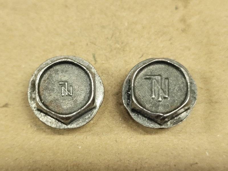

I'll assume that these self tapping screws, that hold the vacuum actuators into the buckets, are original. 6 of them with the larger LN and 2 with the smaler.

For sandblasting bolts I drill holes in a 5 gallon bucket lid just slightly less in diameter of the thread. Then I force the bolts into the holes and hold the lid as I sandblast. It’s easy to rotate and get all sides. Flip it upside down and get the threads. Push them more or less into the lid to get the portion that you don’t get the first go around.
I use one of those magnetic round parts trays
Does a really good job
Roll the bolt over with my thumb, but it gets most of the bolt without touching them
I'll assume that these self tapping screws, that hold the vacuum actuators into the buckets, are original. 6 of them with the larger TN and 2 with the smaller.
Is that bolt marking a TN? I assumed (which could be dangerous) that they were upside down, and were NL or LN.

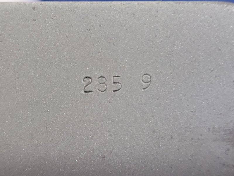

For the date stamp folks. Hood latch mfg 285th day of 1969.

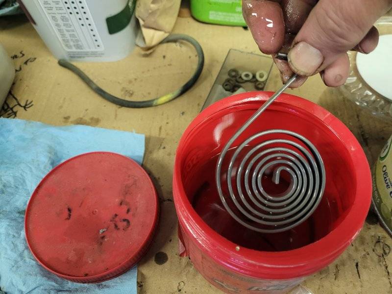

Clean hardware and headlight springs all dipped in Boeshield T9.

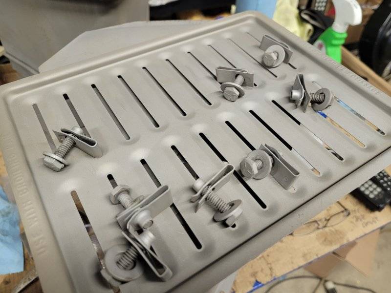

Nose air inlet screen prepped and painted Semi-gloss Black. According to David P it should be body colour, but you'll see 80% out there are Black.

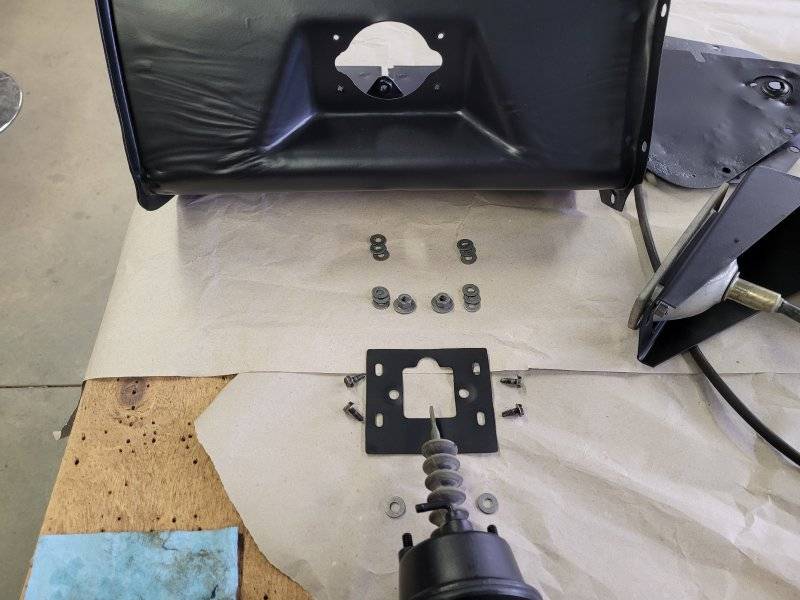

Thought it was odd as I disassembled the actuators, finding a washer on each actuator boss and then the mounting plate and nuts. Then 3 washers spacing the plate out off the bucket on each of 4 self tapping attach screws.
While none of this is shown in the parts manual it was confirmed that this is indeed correct by a new aero friend I picked up in FBook by the name of David Gabay.
I'm guessing it's a partial spacing to correct actuator stroke and also allows the unit to flex around so the headlight doors don't bind up.

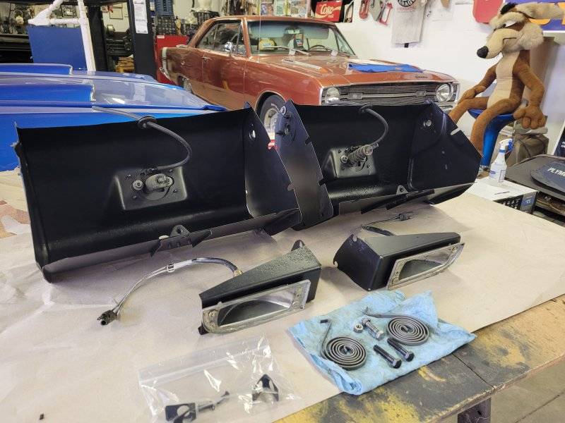

Both actuators mounted back on their buckets with new vacuum hose. Signal light housings attached to their brackets and misc parts ready for reassembly when George and Dan have the headlight pods painted Black to match the nose decal.

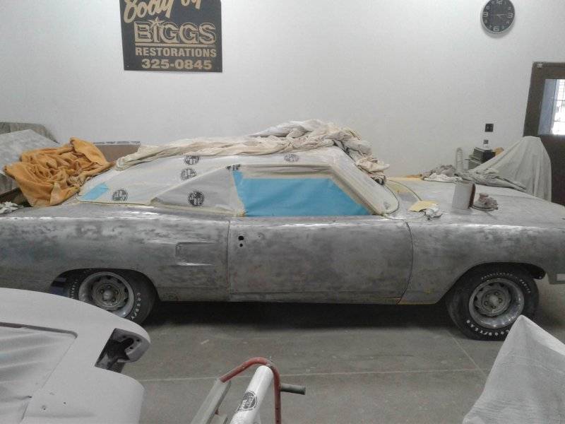

Dan's not wasting any time taking her to nice clean metal. Good thing as it'll be time for us to head for Camp in no time and I want it all done before we do.
So great to see that it's looking like less metal work than was originally thought!

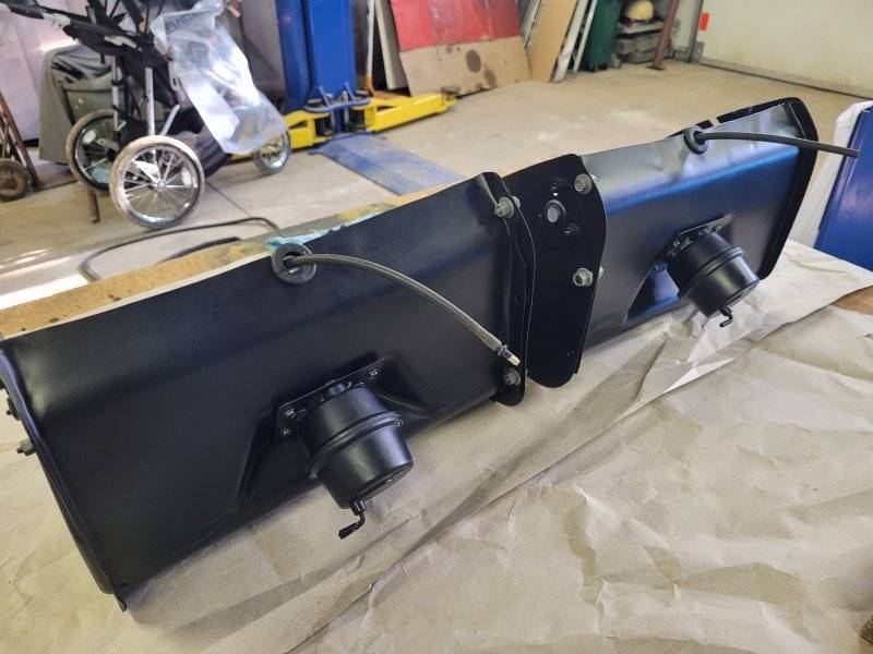

Buckets ready to put the headlight pods into them and then back into the nose once painted.

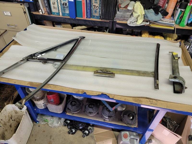

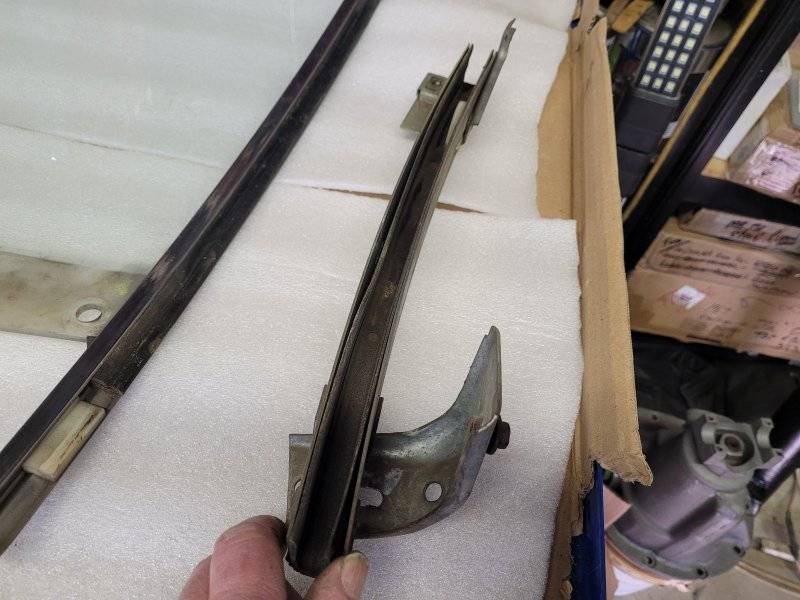

Figure I'll get the door glass tidied up next along with it's guide channels.
Rear glass channel could use that new flocked rubber insert that I have for it.
