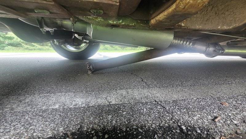

Hello Guys,
I took my 1964 Plymouth Fury wagon out for it's true Maiden voyage on the main highway after working on it the past year and a half. I bought the car that was originally equipped with a 318 Poly and 727 trans. Someone, a long time ago started installing a big block and I assume the 727 trans and drive shaft from the big block. Not sure on the drive shaft. Completed the swap. When I purchased the car the drive shaft was not connected to the rear end. I purchased a ujoint from Autozone and proceeded to "Ease" the car around the neighborhood. After getting the trans rebuilt and installed I did a few more neighborhood drives. Yesterday when I got up the nerve to take it out on the four lane when it shifted from second to third I heard a loud bang and the car shuttered like crazy. I pulled over looked underneath and didn't see anything. I nursed it back to the neighborhood and the vibration continued. Right before I got home I heard a load bang and the delightful "Tingling" sound of the drive shaft on the road. I have attached some pics. I have been reading and it seems I may deed a "Conversion" ujoint any thoughts?

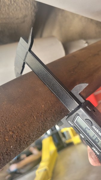

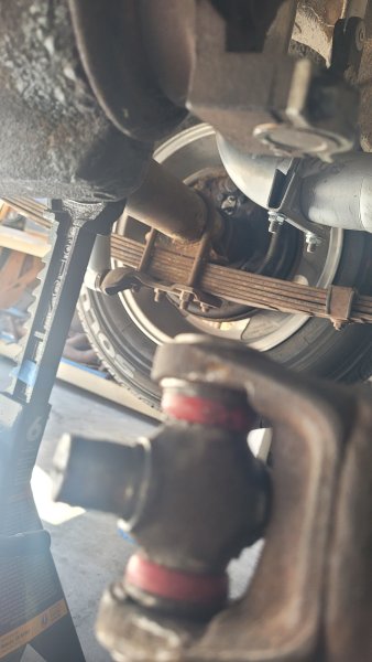

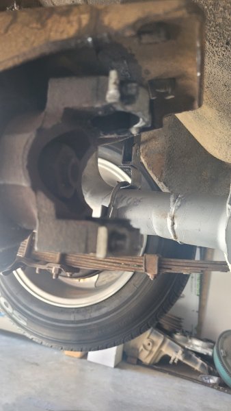

Doesn't look like it broke more like the caps had no snap rings inside the straps and they just walked away.
If that was the case it was just improper installation.

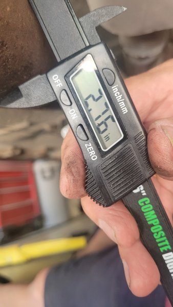

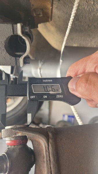

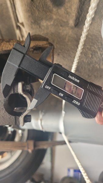

Take the straps off the yoke. Measure the inside of the ears. Is it 2.125 or 2.625?
7260 u joint needs c ring clips to secure the bearing cups
They both use clips at the yoke 7260 and 7290.
1330 has tabs on the yoke to center it.
I use 1330s which is snap rings. Lots of combinations
As others have eluded to, Mopar uses C Clips to capture the U joint cup, unlike GM which has tabs made onto the rear yoke... If you don't install the C clips the caps will disappear....
66/67 yokes have tabs for 1330 u-joints.
Thanks guys. I didn't realize you use c- clips on the yoke end. My replacement joint didn't come with c-clips. I'm out of town until Tuesday. I'll take measurements then.

I was only going maybe 15mph down a slight incline when the ujoint failed. It didn't sound like the engine/ trans revved that high and of course I shut it down immediately. I feel like a DA for not knowing about the C-clips. But again the new one didn't come with any. Did later Mopars eliminate the C-clip?
You should be fine. Most classic mopars use Detroit 7260 (uses c clips for cups and straps to pinion yoke) or 7290 (larger and uses stronger u bolts to yoke). To make it more confusing driveshaft shops you may see Spicer 1310, 1330, or 1350s as well, which use a snap ring at the ends of the bearing cups. 1330 and 7260 are very similar measurement for the cups but the overall dimensions are different. Moog and Spicer make combination u joints for most possible situations, you can find them at local parts house or Mancini racing.

So, today I did some measuring and I have the 7260 joints. I bought another one, installed the C-clips and everything looks good. I'm convinced my problem was because I'm a DA and didn't install C-clips on the other joint. Again, thanks to everyone for chiming in
