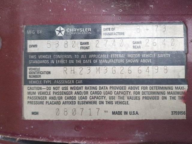

Is the door sticker showing the actual build date still there? Here's the door sticker for the car I posted. Notice DATE OF MANUFACTURE was 8-73; August 1973 for a 1973 model year car. Also, the MDH shows 080717 or August 7th, not August 3rd as shown on the tag. Further reinforcing cars are NOT, necessarily, built on their SCHEDULED dates.

The tag and door sticker are for the same car. The door sticker tells us the car was built at the St. Louis plant, its VIN (3G266498) and that it was built in August 1973. So if your VIN is similar, it too was built in August of 1973. To be built in August of 72, the VIN would have to be in the 100001~110000 range.
