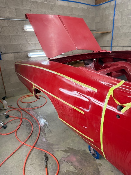

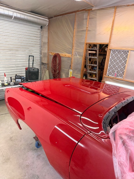

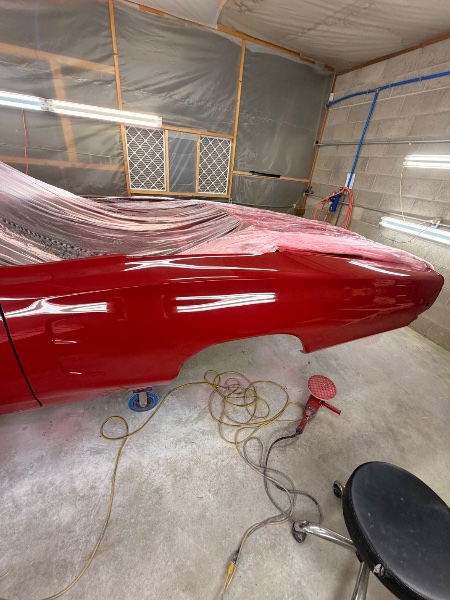

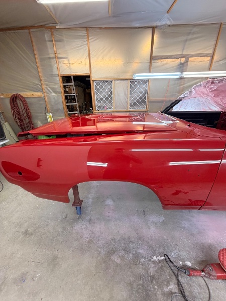

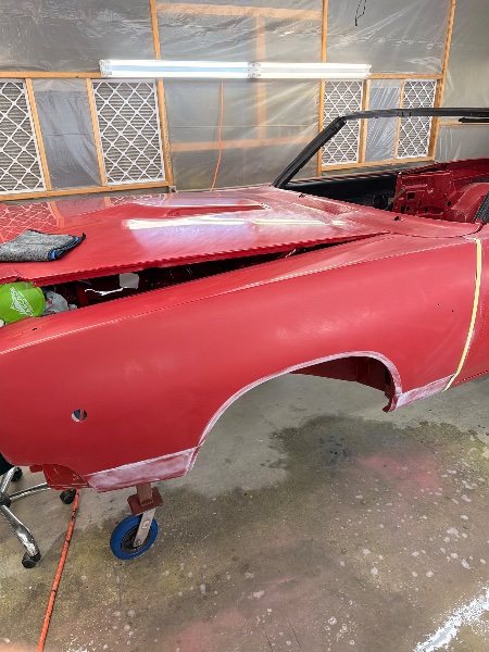

Hi all, this is going well!! I’m on that last stage of cutting at 3000 grit today. Loving it!!
Tony

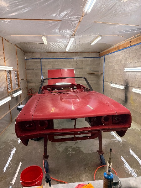

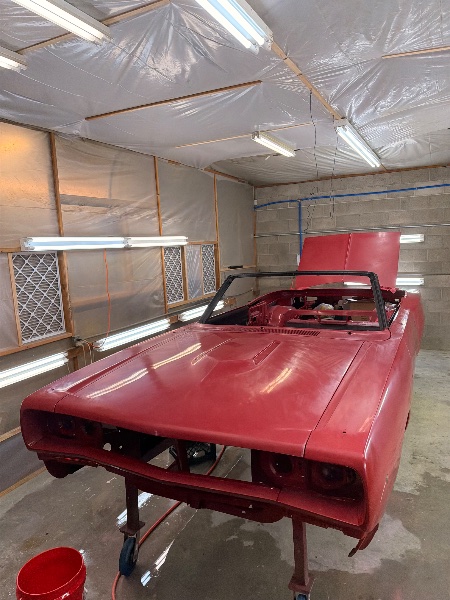

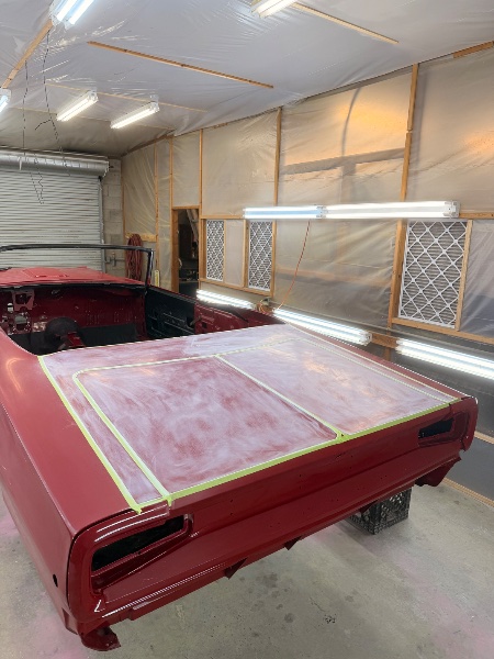

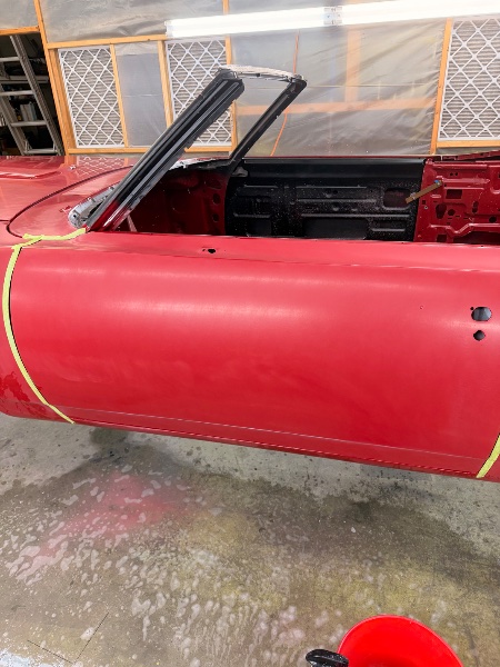

Just a little update... Tony has been putting in a lot of hours making this car far better than I ever expected.... Thirty years ago I was a patient guy, these days I can get in a hurry.... Tony was always more detail oriented than me, not saying I haven't always been a detail oriented guy but I've kinda relaxed & accepted things as they are... Not Tony.... He still pays attention to the details... This car is gonna look amazing....
View attachment 1993597View attachment 1993598
Thanks!! I can’t help myself… this car is too nice not to make it the best of my ability!!!

Yeah... I'm not a body & paint guy... I have so many parts all restored waiting, but I'm at the mercy of paint & body people... Starting to see the home stretch... Time to figure out what obscure part I don't have that'll put me back on hold....
