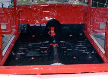

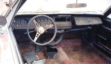

So after driving & racing the car for about twelve years & nearly losing his license he parked the car on the side of the house & let the registration lapse...
He left the top down & sanded off most of the original paint... Thankfully he pulled all the carpet out & pulled all the body plugs so most of the water just drained out....If this weren't a dry climate there wouldn't have been much left but strangely the only reason I had to replace the front floor was because of him converting to a 4 spd...
I'm not sure if he used a hatchet or a hand grenade to create that hole but whatever he used it wasn't pretty...

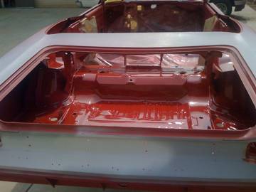

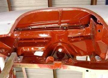

The exterior of the body on the other hand was a mess, the car never took a serious hit but it probably had four minor collisions & literally hundreds of minor dings & dents...
After taking the car completely apart & mounting it on dollies I used chemical stripper to remove all the gray primer & remaining paint from the main shell, then I took the shell to a local shop that glass beads car bodies along with lots of other stuff.... I had them hit the engine compartment, interior, jambs & the bottom of the car but the I had them mostly stay away from the quarter panels...
The car came back looking tremendously better... I didn't waste any money having the original unboltable sheetmetal stripped since it was all beat to death.

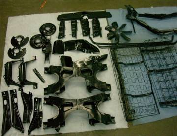

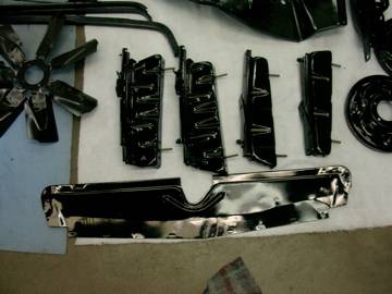

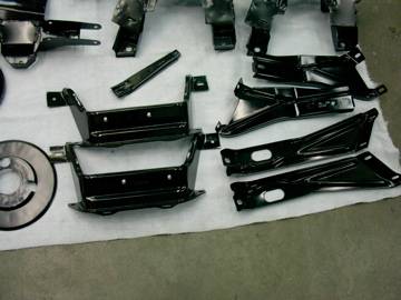

I took a truckload of parts to my powdercoater...
I took assorted buckets bins & boxes to my plater... I use to have friend who would do small quantities of bolts & parts when ever I needed but being California the environmental police made running a small plating operation impossible so when he closed he gave me contact info for a plater that does good work but this company won't do small quantities... So when I was ready to plate stuff they had a 40 lb minimum whether you bring them 2 lbs or 40 the price is the same.... And if you want more than one color it's a separate charge.... I took the challenge... I brought them about 40 lbs for clear zinc, 40 lbs for yellow zinc & probably 75 lbs of black oxide.....
I don't have photos of everything but here's a sample..

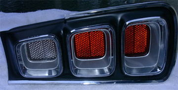

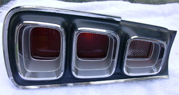

I tracked down a beautiful set of tail lights, & a nice straight rear trim panel... My original rear R/T emblem was badly pitted... I bought a repo R/T badge but it didn't fit the rear panel at all, the cutout areas didn't line up with the ribs on the tail panel.... I started working on my original but I've done enough work with pot metal to know as bad as it was it was gonna blow up when I had it stripped so I either had to polish what I had as best I could & accept it or find another solution.... I'd been searching Ebay regularly (remember this was 2001-2002) and I'd found a number of cool parts well guess what popped up... A real deal NOS in the package tail panel R/T emblem... Woo Hoo!!

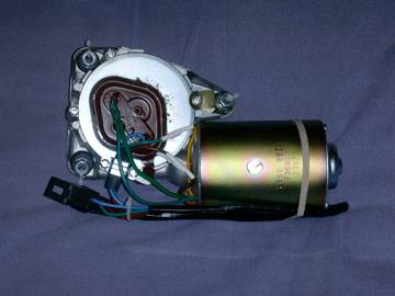

My original Wiper Motor went to Jules

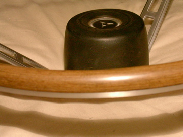

My original steering wheel (the original wheel had been removed early on & he put it in the attic) went to Doug Lepak, wish I could find a better photo..

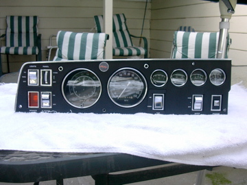

The gauges went to Palo Alto Speedometer, full rebuild, calibrate, silk screened faces...
R tail light.jpg L tail light.jpg wiper motor.jpg stuff 001.jpg parts 013.jpg

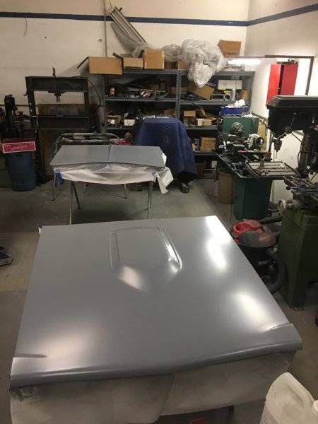

Well time for a minor update...
The car is in it’s final primer before paint... Well the hood might need another coat we’ll see...
I have found that many painters are F L A K E S so when you find a reliable one, their price usually reflects that.
