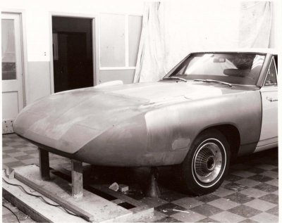

nothing from the factory was ever put into production using the 69 plymouth body. im sure there was plenty of experimentation using them.
I have not seen any Plymouth B bodies studies because at that time Petty wanted to drive a Daytona and when told no he left Plymouth and went to Ford.
I have seen a few pics of a 70 Superbee Bird. If someone has a base 70 Coronet they just need to nose cone, wing, fender scoopes and the cap for the hood. I think the 70 Superbird hoods were 70 Coronet hoods that were cut and a piece welded in.

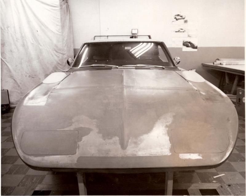

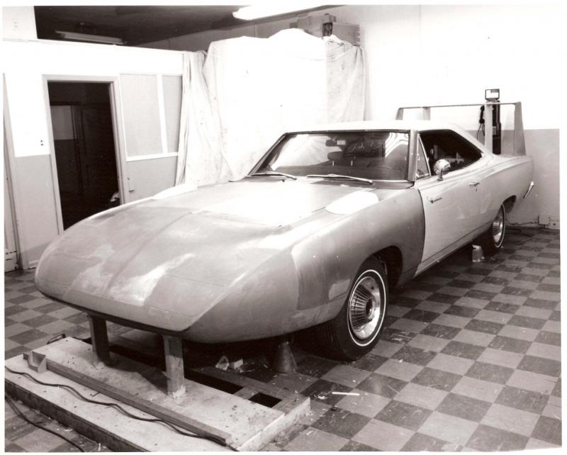

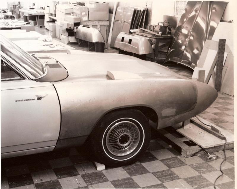

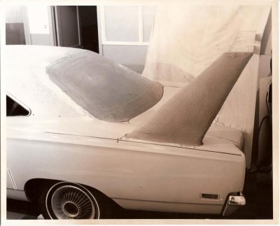

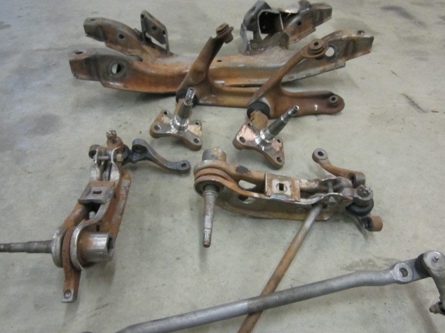

Great pics Stu - now that's some talent..sculpting the concept pieces in clay in the 60's. Dave I am on V island but sometimes get to the Vanc mopar shows. RT guy...your right aboout the hood mods to the 70 coronet hood etc. As I don't have a steel coronet hood so I am going to cut my RR hood at the front and fab a superbird insert...we'll see how that works..or not...haha, I do have air grabber 'glass hood scoop on a 'glass s bird hood I made as a back up, in the meantime the un-glamorous part of this build- hot tanked the front susp., and FirmFeel parts in the future.

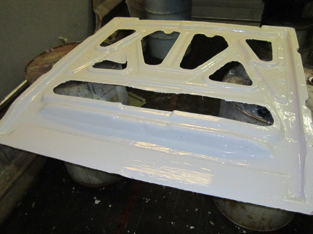

Making my ' glass bird hood now, this is the inner hood gelcoated and ready for a few layers of 2oz matt. Hood is done so will bond these two then graft my air grabber piece on and a 'glass air box...which I also make.
You're making your own air box?This I have to pay attention to.Again really great work Don...keep the updates coming
