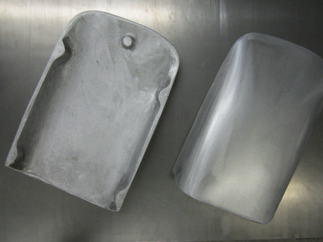

Also offering aluminum cast Daytona fender scoops.....and for Superbird too.

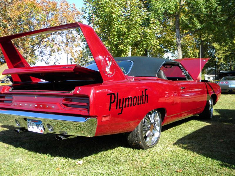

DSCN6129.jpgVery nice Don. When I build my bird there wasn't anyone making the metal parts. I used Janak which was about the best offered. It was over 9K shipped for the kit. And still had to do a bunch of tweaking to get it right. Even at that I had put around 50K in my car making it as close to right as I could. I wouldn't have ever made it with out a great deal of help from Tom Ferry. Another great authority on the wing cars.DSCN1755.jpg

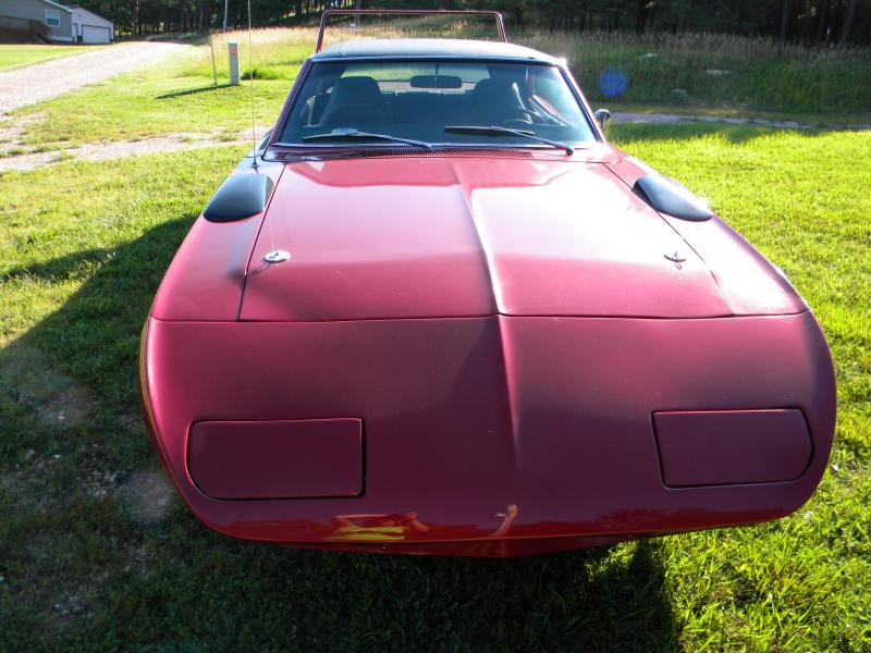

Need Help. Pics Attached from Sarnia Ontario. Guy claims his Daytona is a 70... I know no 70's were made by factory. Anybody recognize the car. Claim he found it in Southern Cali. Fender tag pic also. He claims to be putting a Viper drive train in it.
By default of the SPD of 610 ( June 10th ), this is a Daytona. All '69 C500's were built before Jan. 1969, hence will have no later than a C** SPD and with that, all Daytonas were built AFTER Jan. 01, 1969. This example is a Daytona with the A47 SE package, hence the "SE" badging on the roof pillar and woodgrain dash. Looks to be missing two important items; wind deflectors and rear window trim.....
