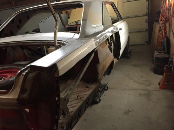

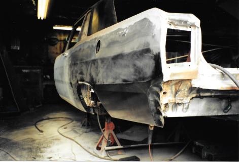

Seeing you have to buy the full quarter anyway,I would think it would be easier/better to hang the full quarter?
I've tossed around which way to go chargin. One downfall is I already welded in the roof skin to the old quarter, so I'd have to grind a bunch of welding out. I kinda dropped the ball on that one. I should have been definitely looking at skin availability before doing that. You see them listed for sale everywhere, but no one really mentions that there's none in stock, anywhere. Oh well, live and learn I guess.
That's what I would think as well. Then you end up with all factory weld points and nothing grafted together. If you gotta buy the whole quarter (which I a bummer) then you may as well do the whole thing...
I agree the full quarter process is usually more of a clean cut process (until you buy a Sherman quarter...lol). Like I mentioned, kinda on the fence. A skin I'd have a 6 foot cut line to deal with. A full I'd be trying to locate and grind out the quarter/roof welds I put in, deal with the spot welds in the window opening & deck filler, as well as the brass brazing. Also getting the spot welds out down the trunk gutter and the interior rear side window area.
Just all kinds of back & forth in my head! Work wise, I'd say they're about the same...maybe a bit more with the full. Maybe I should just flip a coin and be done with it, lol.

Sounds like a no brainer to me but then again I don't trust myself enough to do long welds on flat metal. Putting the full quarters on the Charger really made my repairs quick, clean and unnoticeable and since the old quarter was junk I just ground the spot welds paper thin and pealed it off. I'm sure whatever route you take you'll pull it off no sweat.
Hehehehe....I wish it was that easy man. I get beat up putting on panels just like you guys. Only difference is that I don't gripe about it as much as I use to..lol The bad and good thing about the Dart is that there's literally 5 body lines that run down it. The bad part of that is obviously dealing with all the body lines during body work and making the lines all come out straight and as pronounced or unpronounced as they came from factory. They good part is that there is no vast stretches of flat open metal. Makes it much more easy when going to graft in a patch or lay on a skin to find a body line to make your cuts/welds near. The metal is less likely to warp along a body line vs. open flat sheetmetal, and the straight lines give good reference. Real nice thing on the dart is that there is a 2" wide body line running across the top of the quarter. Perfect spot to make a cut/weld for a skin.

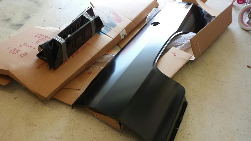

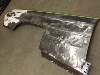

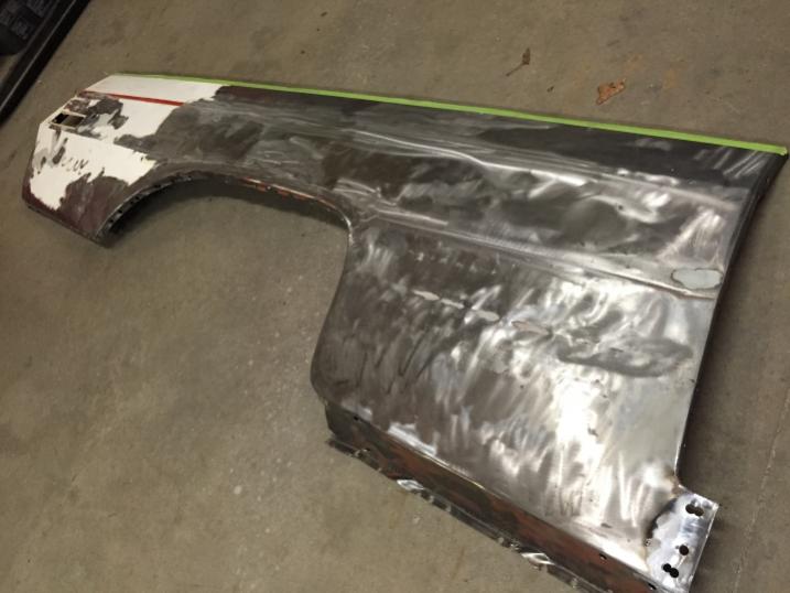

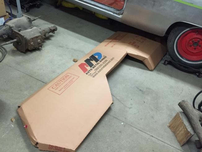

Some good news just unfolded. Found a member over at FABO selling a pair of AMD quarter skins (as well as a pair of extensions). All for 425.00. He lives about 2 hours down the road from me. Sounds like he want's it all out of his garage. I really don't need both, but I figured even if I ordered one skin (if I could even get one), by the time I paid freight shipping it would cost me $400 just for one. Full quarter would be over $640 after shipping. I may even skin the drivers side, being it has dents as well, not to mention the car had mid-body line trim and when someone went to remove it years ago they just grabbed one end and yanked. That pulled all the little trim nail heads out that are centered on that mellow body line and really messed up that body line down the entire quarter. Either way, I could always put what I don't use on here, FABO or craigslist.
Here's a pic he sent.....ones still in the box:
Put a skin on a post Dart many years ago,took me 17 years to do bodywork on a Dart again. I joined it in the middle of the upper body line. It wasn't a barrel of monkeys! Scan.jpg
I'd say full quarters is the way to go.. I found so much hidden rust in seams I would of never been able to access without having the full quarter off
Real nice Will!!! Its hard to beat AMD, i know all to well its an exspencive journey, i have one box yet again on my porch with a passenger side foot well for the bird and have some used and new parts coming.. Im pretty whipped after today's adventure but its one of those Mopar tired nights lol... im sure you know what i mean along with a bunch of guys here..

Package eh? Cool beans! I have one for you too. I need to play a little hooky from work and get that sent down to Iowa!! I did pick up the quarter skins & extensions Saturday. Drilled out pretty much all the spot welds for skin removal on the passenger side today. WoHoo!

Picked up the AMD quarter skins and extensions over the weekend and am stoked to get rolling on it. Spotwelds all drilled out. Just waiting for a little time to make my cuts and fit up.
Nothing like having fresh AMD sheetmetal to go on your ride. It's about the equivalent of waking up to someone cooking bacon! Biblical!
Free dent filled, bondo laced quarter up for grabs folks!! Better strike while the iron's hot!
Obviously it's time to clean up, seal and paint the areas that were underneath. Not use to seeing whole solid metal around wheel houses, rockers and extensions. I may have entered The Twilight Zone! Up next, make my cut line on the new skin, fit in place, then cut along the established cut line on the new skin, into the old metal.
