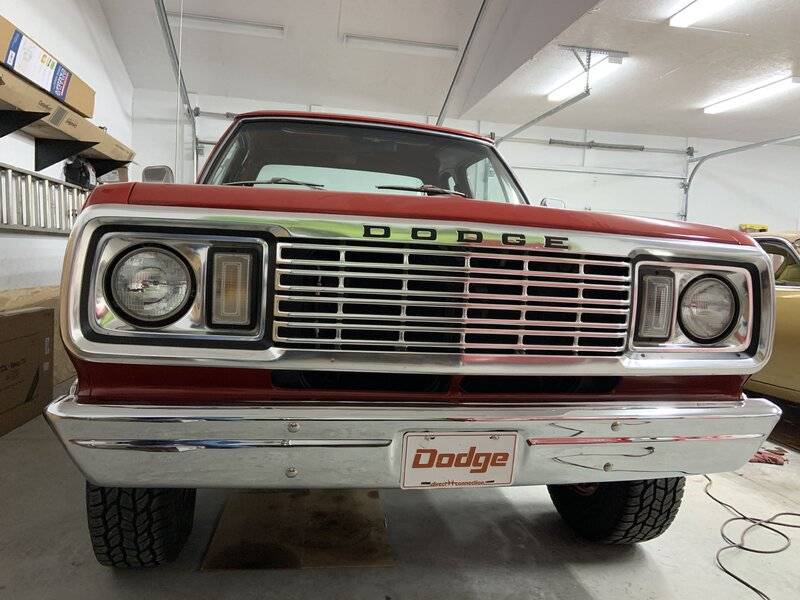

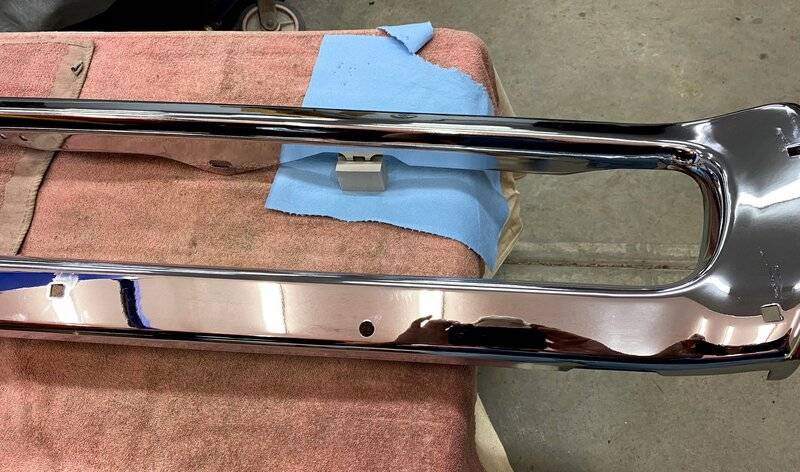

I just did 2 for my 71 by Tri-City. Very nice, $525 each and I just sent them the front for my 74 for the same price. I also just bought a 71 AMD rear for my 74 since I did not have a 71 core. It was $500 and its nice but not as nice as my originals done by Tri-City.
Tri-City top. AMD bottom, note the blemishes near the bolt holes are a protective oil I had not cleaned up when I took the pic.
Tri-City also did my Power Wagons for $500 each.
