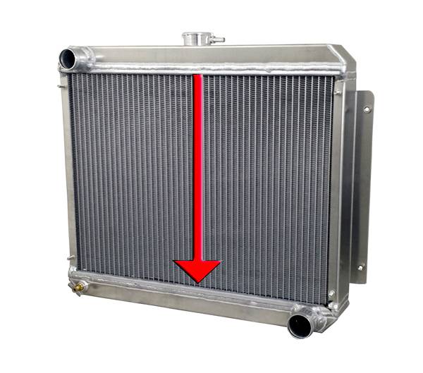

I am ready to purchase a new BeCool Crossflow Radiator setup for my 66 Satellite and because I'm also running a Meziere electric water pump I have a choice of driver or passenger side Lower hose configuration. My question: Is there any advantages that I'm not seeing to run a passenger side lower hose routing option? Same cost either way. I am running power steering and hydro boost. If going with the optional passenger side lower hose the upper hose moves to the driver side. Thoughts?

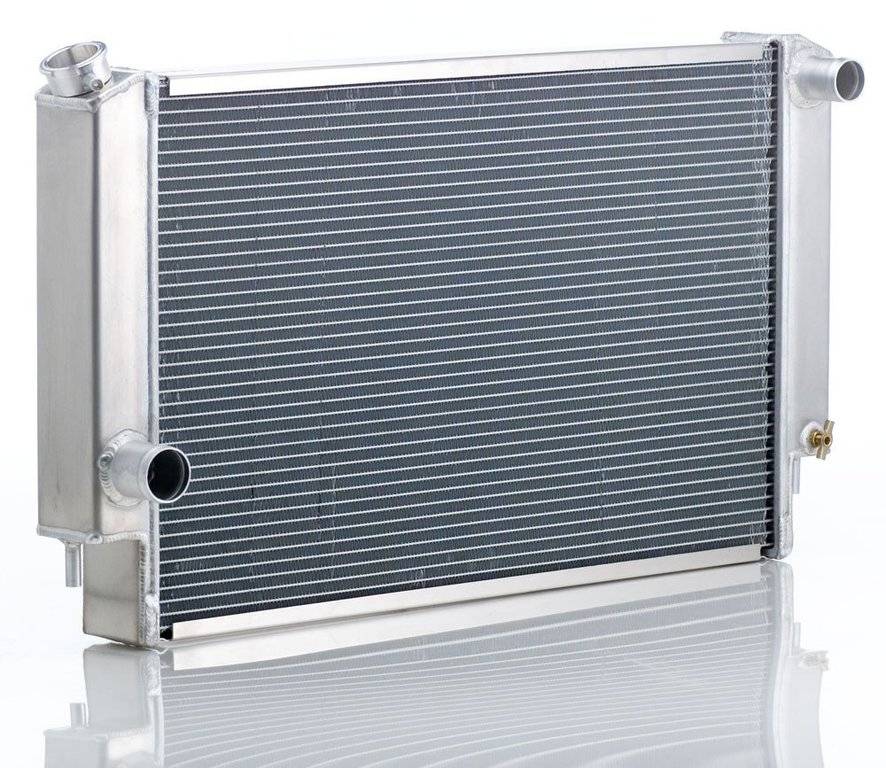

a better picture of the cross flow conversion.

What HP where they rated for and were the tanks notched like the picture above? Just saying If the radiators you were running and have real world experiance with didnt cut it. Then not sure I want it.

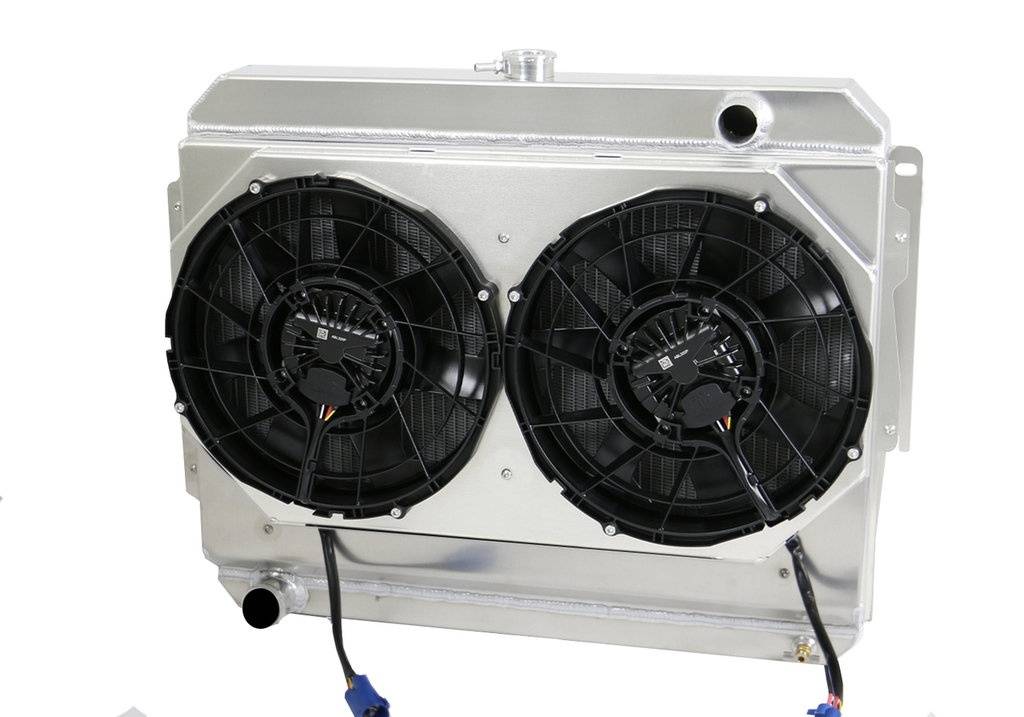

So because of the responses of you guys I've decided to opt out of the BeCool and purchased a 26" wizard radiator with 1.25 tubes and brushless fans. stil big bucks at $1300 ($920 fan/relay option) but it really makes the fan/shroud package much thinner.

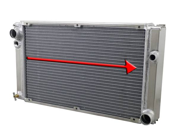

To quote from the Wizard site:
"Hot coolant flowing from the engine enters one tank, then passes through the tubes in the radiator core to the other tank, which then passes the coolant back into the engine. While the coolant is in the tubes of the core, the heat from the coolant transfers to the tube wall and fins. The passage of air over the core dissipates the heat transferred to the tubes and fins and the cooled down coolant is then passed back through the engine to start the cycle over. The more tube surface area there is, the better a radiator can dissipate heat and cool. (Please read to the end.)
So, if you have both a downflow and crossflow radiators made out of the same materials, using the same build methods and using the same core dimensions, then they will provide the same level of cooling, regardless of their position."
Entered here in the event some folks might read the quoted post and take it for truth without further reasearch...
I purchased a Wizard also. Better explanation to me of their product and performance.
