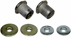

Wow! I knew about the isolator bushings and the different BB and SB inner fenders, but not all the rest. The 74 is the newest "classic" I've owned. My history is mostly 66-67 B a 70 Super Bee, 73 Duster and a 73 Challenger.

Rear of uca in gives pos caster; then move front for camber( straight edge vertical on tire with angle detector). You may have to bring rear out to get camber correct(darn, lost some caster). Tape measure from tread front and back of both tires, set toe-in. I have done that, and freaked out the alignment guy when I took it in, he said it was so close...
