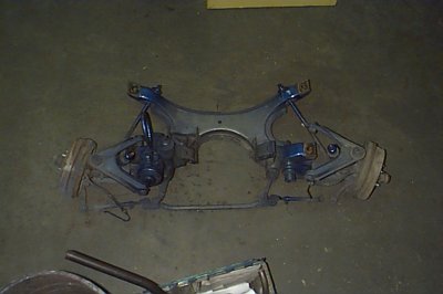

Here is a picture of your frond end.
The bar that sits just above the frame sits on bolts that slide in elongated holes.
Moving the upper control arm in and out sets the camber.
A ggod front end shop will align it in no time.
If they don't knowhow, they ain't good.
I thought the 73 was a B body and was set up similar to the older cars that used the cam adjusters? Jonny, does your car's front end look like what's in the pic?
That's 71 -72 Cranky, 73 - 74 are like the pic above.

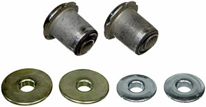

One other thing I found when ordering the strut rod bushings is that every one selling after market bushings has the wrong bushings for 73-74's they try to pass off the smaller 60-70's style...They don't work,I have 3 sets here if anyone needs some.
Here is a pic.The shaft is to short and the bushings are not big enough around to fit 73-74 B bodies strut rod.
Just a heads up for any one reading along :)

Your 73 has what is called sliding upper control arms. But the first thing you need to do is make sure you don't have the idler arm upside down. Now to adjust caster/camber on a front end machine. Raise the front of the car, look behind the top of the front tires. You'll see two nuts where the upper control arm bolts to the frame by the shaft. The bolt holes in the shafts are elongated so you can loosen the nuts and slide the control arm into spec. I like to start with max+ caster then work up my camber. Its very, very, very simple.
Yup....and I don't understand why alignment shop techs have such a hard time with the older cars. I got tired of messing with them and learned how to do it myself! I like all the caster I can get too and with a lot of Mopars, getting very much isn't always very easy. I also like a good deal of negative camber....

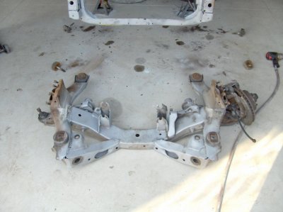

Here in the first pic is my 74 Satellite SB K-frame VS an older style K-frame out of a 69 Charger.
