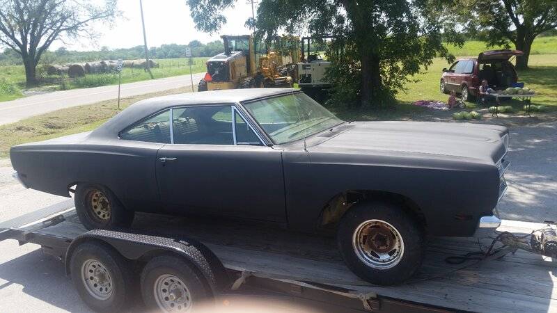

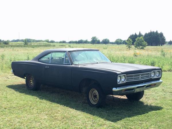

Here's the Satellite.

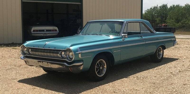

And of course, my Polara!
