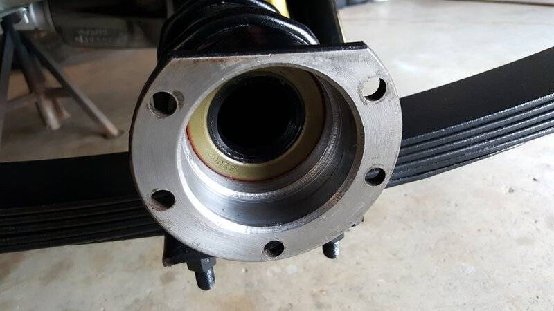

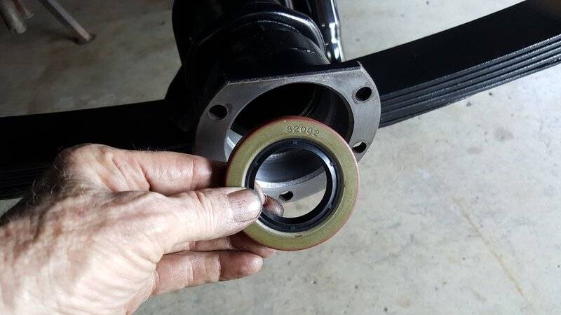

Lol, chatting on green bearings consumes volumes on the forum. If you have a few hours, or a week, you could search this topic in the archives. One of the first things I did when I got my ’63 Plymouth was swap out the rear; a ’65 Coronet rear bolted right on and installing a sure-grip was the next thing. Depends on preferences; but wanted to drop the tapered shafts.
khryslerkid
12:54 AM
Mar 10, 2010
26,359
42,464
Hanover, Pennslyvania

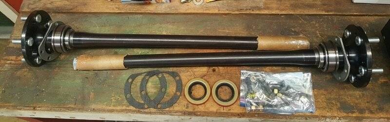

Ive used cut to fit length late style shafts with green bearings in the original housing. There is no room for axle seals doing it this way. The housing isn’t machined deep enough. However the green bearings are sealed and ringed. It worked fine. I’ve used green bearings for 25 years. Only one failure. And it was oil seepage. I failed 2 factory style bearings during the same time frame.
Doug
Unless what Dr Diff sells to replace the tapered axles with a flanged axle are different from the factory axle, he did supply seals.
You can look through the link I provided in post #10 for more info.

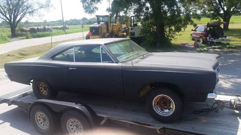

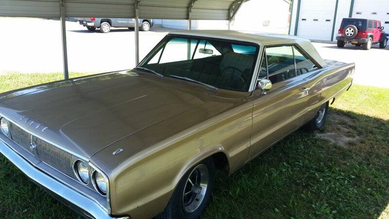

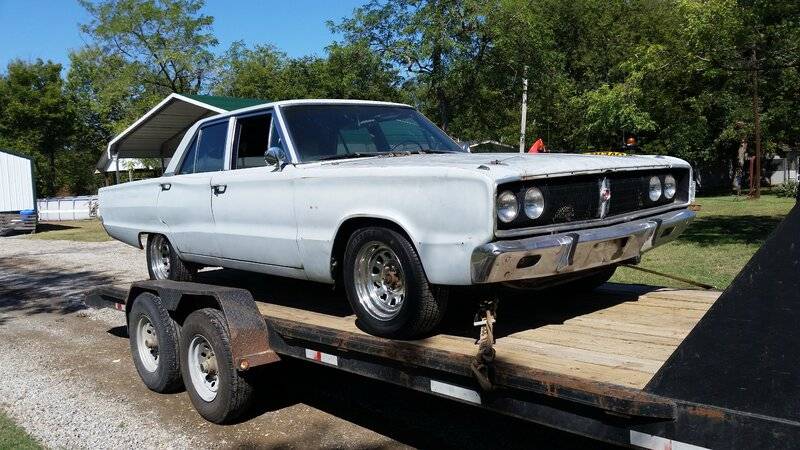

View attachment 1214429 View attachment 1214430 I'll be sure to post a thread in the sections you guys linked after work later. Thanks guys. In the meantime, here's some pictures. Above are the Coronets.

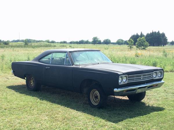

View attachment 1214432 View attachment 1214433 View attachment 1214434
Here's the Satellite.

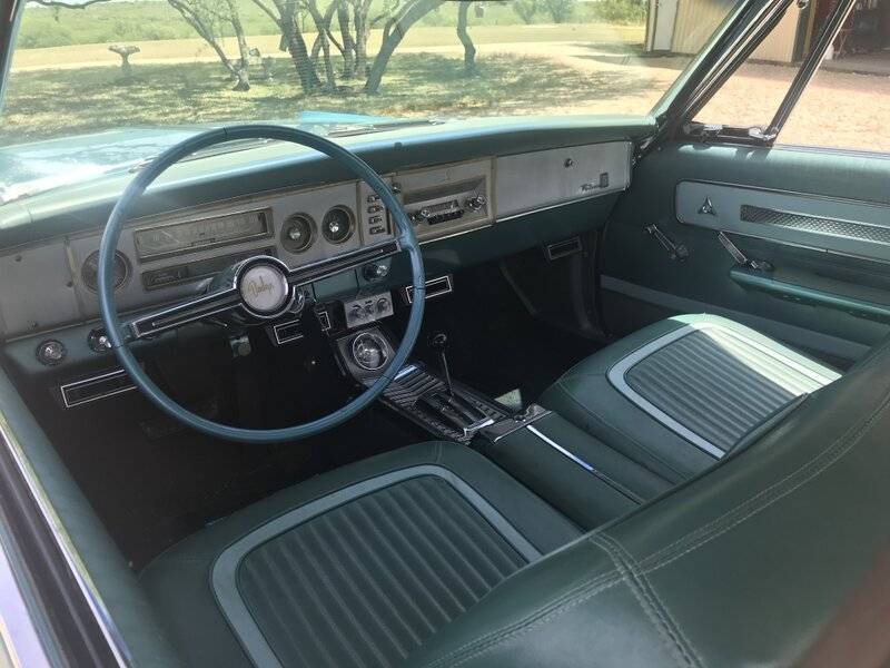

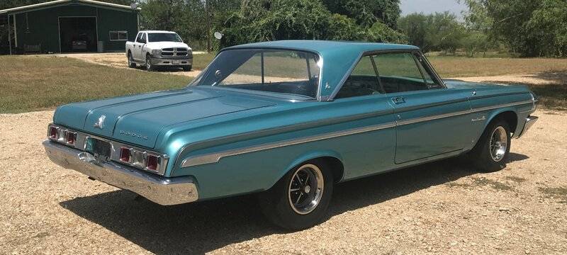

View attachment 1214435 View attachment 1214436 View attachment 1214437 View attachment 1214438 And of course, my Polara!
I'd upload pictures of the Dart, but I've reached the picture limit for one post, and I doubt anyone here would want to see an old A-body anyway :lol:

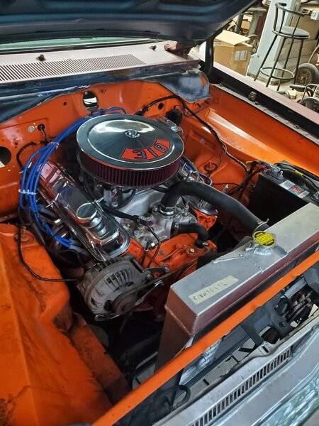

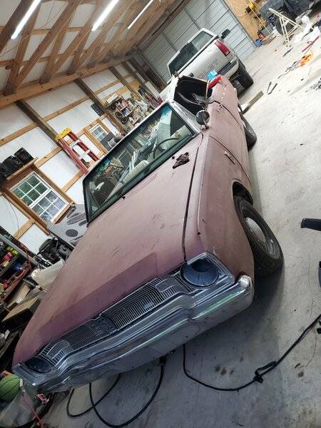

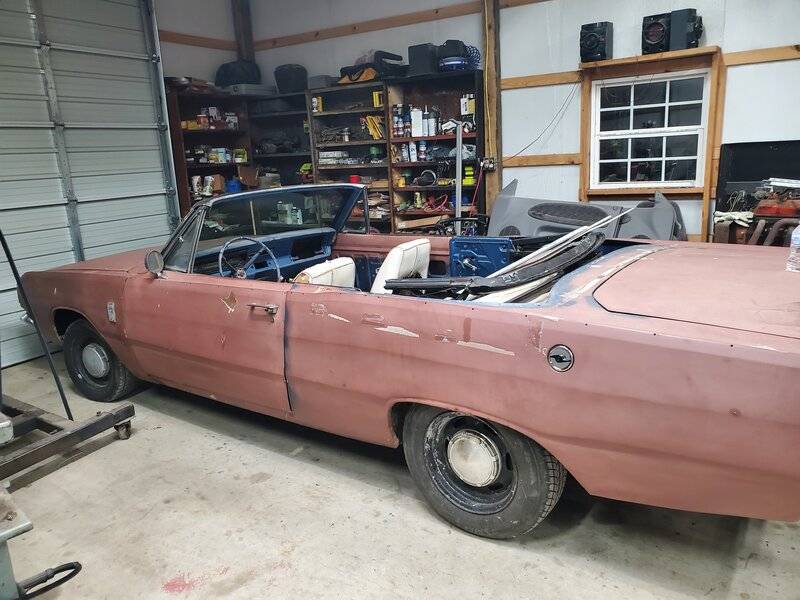

Finally had a chance to check back in here. Here are some Dart pics. Main thing it needs is the body and interior done. And to finish installing the new Painless wiring kit lol. Lots of new parts when I got it. He painted the engine bay a little prematurely in my opinion though. Now I either have to paint match the rest of the car or change the color. Oh well lol
