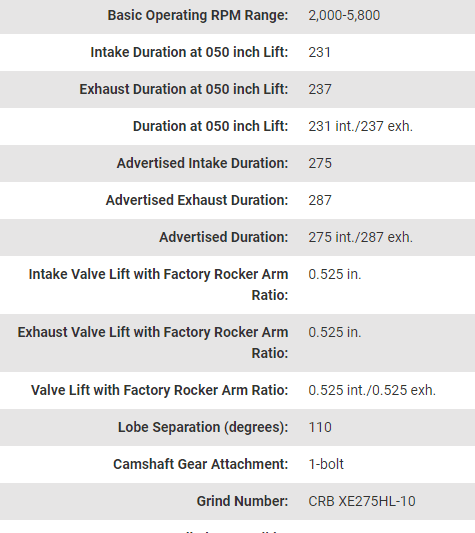

So I just built a Very similar motor only used 440.. got the 512 kit from 440 Source including the stealth heads only thing I did to heads (Besides spring change) was have the valve angle checked (and adjsuted) I used the Comp Cams .525 .525 CL21-228-4 spec: lift @500 int .230 exh .237 Dur int 275 exh .287 LS110.
Have the Holley sniper set up I chose to go with a single plan intake to maximize fuel atomization as running the dual plane for lower end torque was not necessary and to try to carry torque thru the whole rpm band.. Like you I chose to leave some HP on the table for durability/longevity.. I will never see over 5500 rpm and with my 4 speed have all I want to handle.. 1969 bee 18spline a833 8 3/4 w 3:55's 26" Street tires TTI header back 2 1/2 in.
