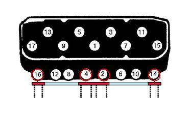

Not sure about your headers but I had a slight issue with my TTI's and head studs. It was the bolt positions just below exhaust ports of the header flange. The studs extended just high enough to contact the flange and keep it from lining up. It was down to either grinding the flange or putting bolts back in those holes.
Good point, I'll have to look at how close they are now.
