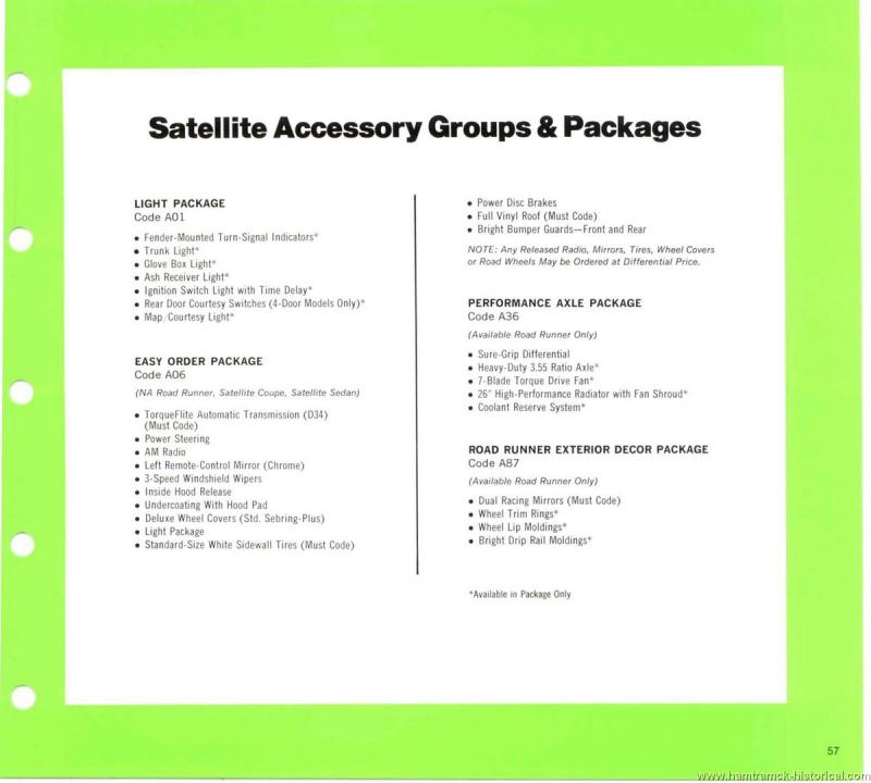

Yes, you can tell what came in there from the factory by decoding the fender tag in a round about way. Since it was a 4 speed, that means it started out coming with the standard 3.23 and since it is not optioned out for an A36 that let's you know it did not come with a 3.55 sure grip. What is actually in the car right now is another story. It could have easily been changed over the years.

As stated earlier, look for a small brass tag on one of the bolts. Mine also clearly had 3.55 in yellow crayon on the rear of the differential, so if you carefully clean yours off, you might get lucky.
Failing all that, jack the rear wheels off the ground. Spin on wheel one full circle and count how many times the differential rotates. You should be able to see the difference between about 3 1/4 (3.23) and 3 1/2 (3.55) or almost 4 (3.91). I suggest you align a u joint to a known point and count from there. Also, if the other tire spins the opposite way, you have a sure grip.

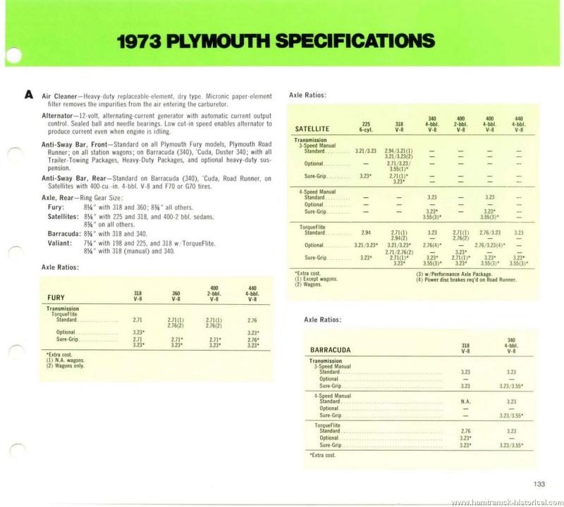

A 73 Road Runner should have an 8 1/4 rearend
If you look on the data book page posted above, (Axle, rear-ring gear size) I'm sure it's pretty clear the Satellite model with anything more than a 400-2bbl got the 8.75.
I once had a parts car 1973 340 4 speed Road Runner that came with a factory 8 3/4. Could be that the stick cars got it along with big blocks.
I can only talk from a 73 Charger pov, but mine has a 8.25 and has a big block 400 in it. I think the 8.25 was standard for 2bbl while the 4bbl came with an 8.75 minimum.
Yes, if it came with a 318 or a 400 2 bbl, but not the 400 4 bbl. The 400 4 bbl came with the 8 3/4.
Let's not forget about the 340s. My 73 Road Runner has a 340, 727 and a 3.55 suregrip 8 3/4 rear.
