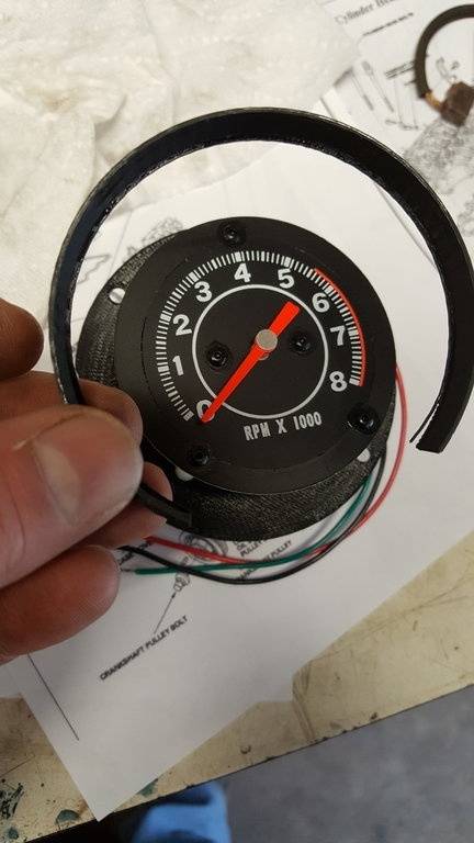

I also received my in-dash tac from year one after nearly three months. Nice looking unit but the shroud was separated from the face. Hopefully it can be glued on or I may have to wait for another three months!

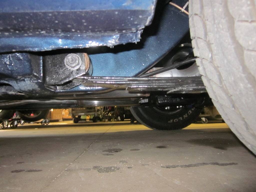

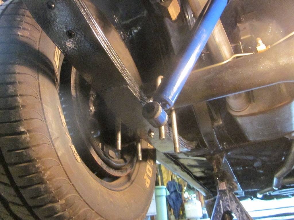

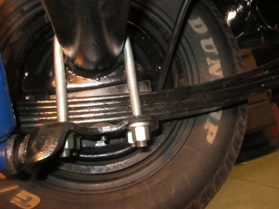

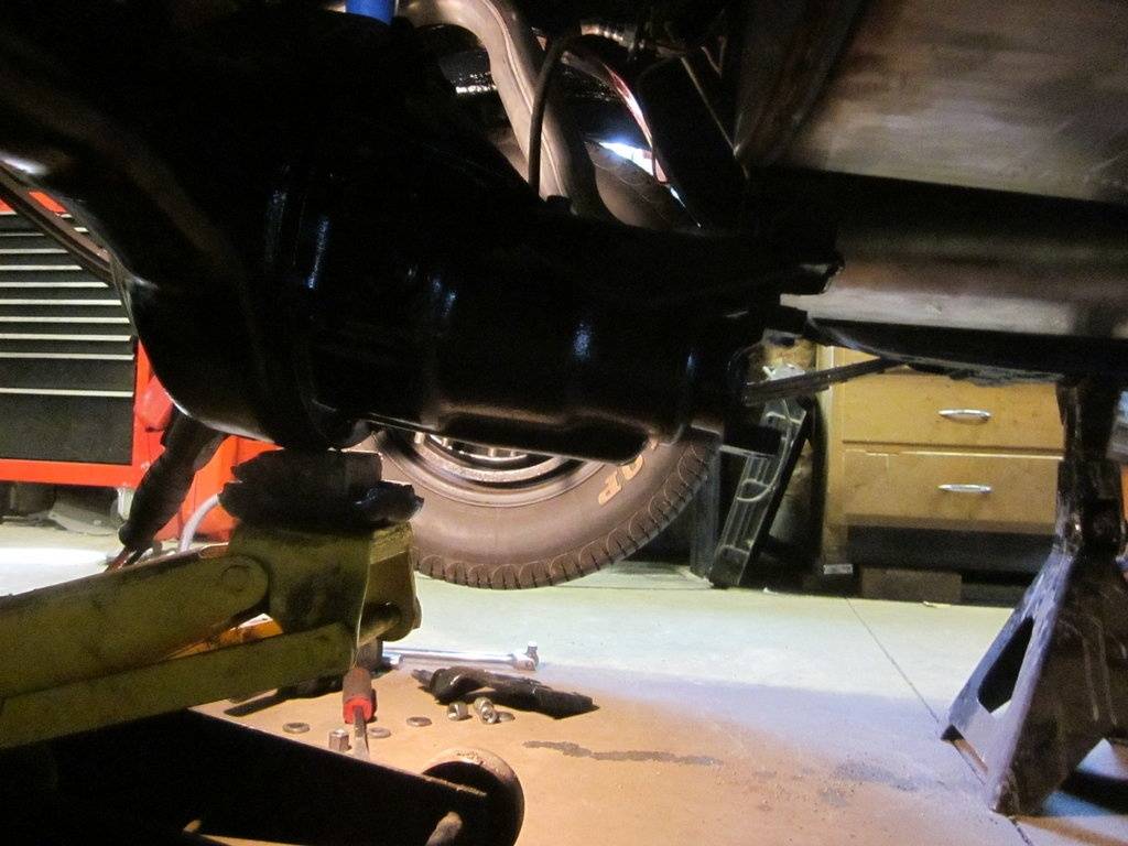

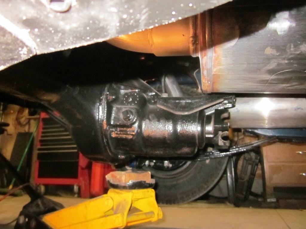

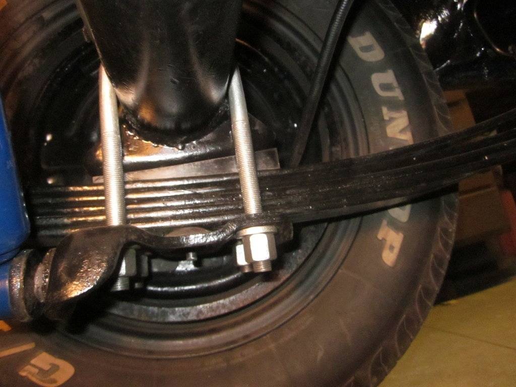

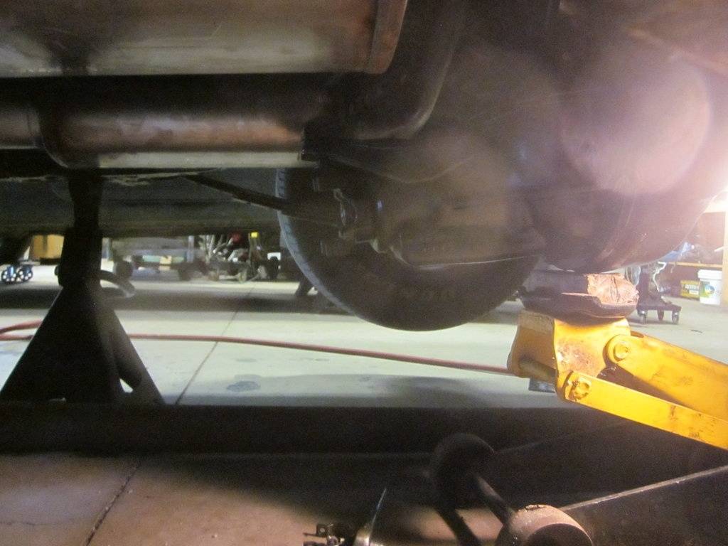

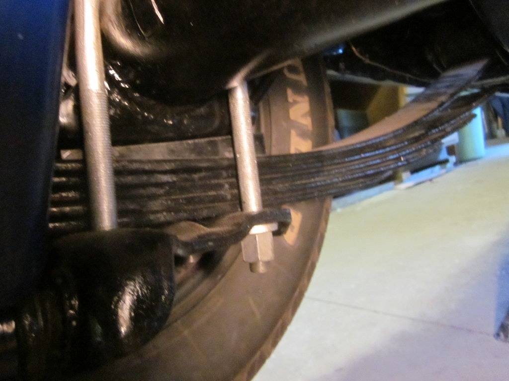

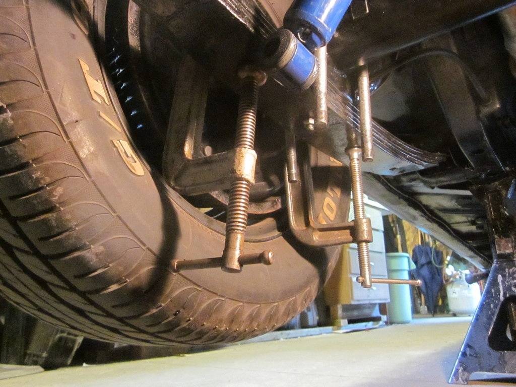

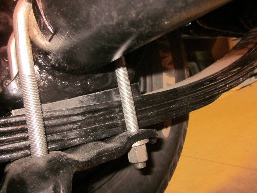

Picked up some shims from a local spring shop for $10 each to correct the pinion angle that I think is causing a vibration.
before the shims.
Thatt seemed to do the trick and get rid of the vibration.

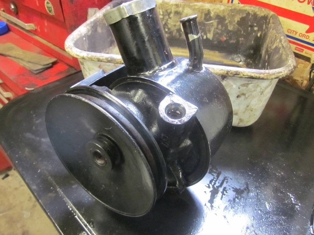

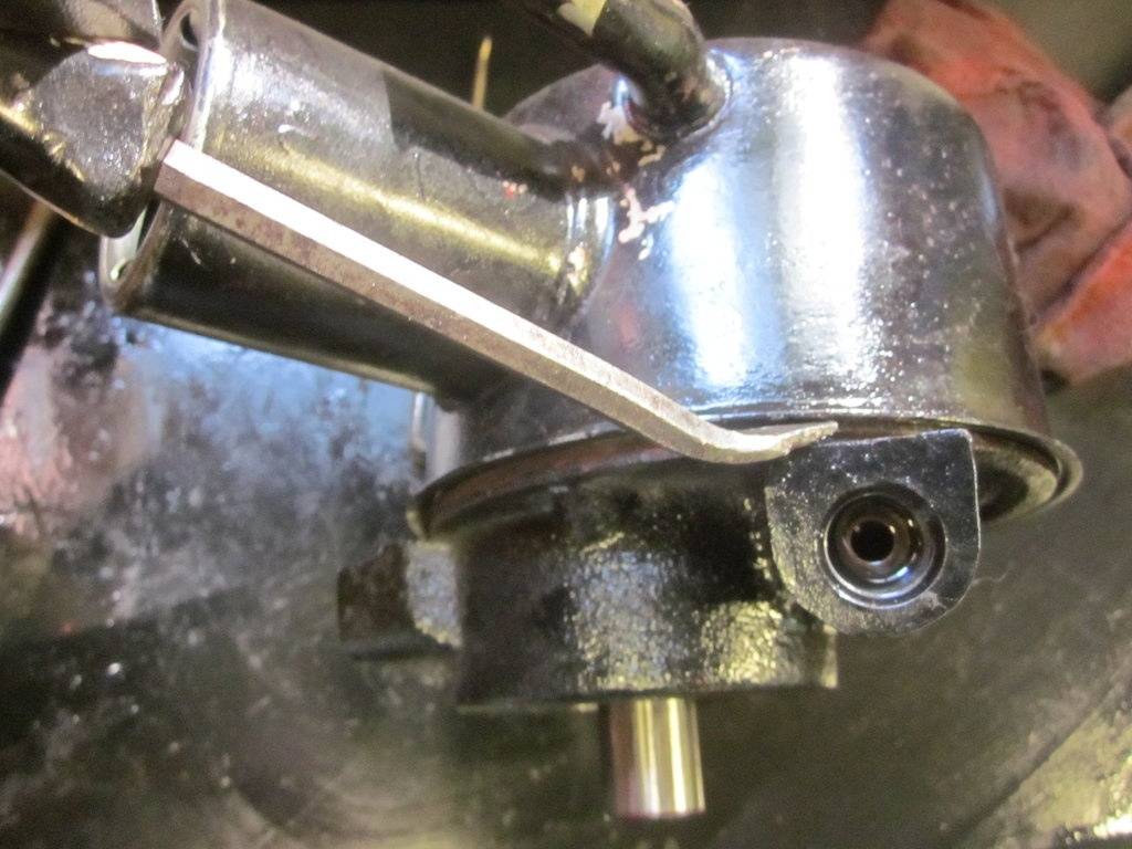

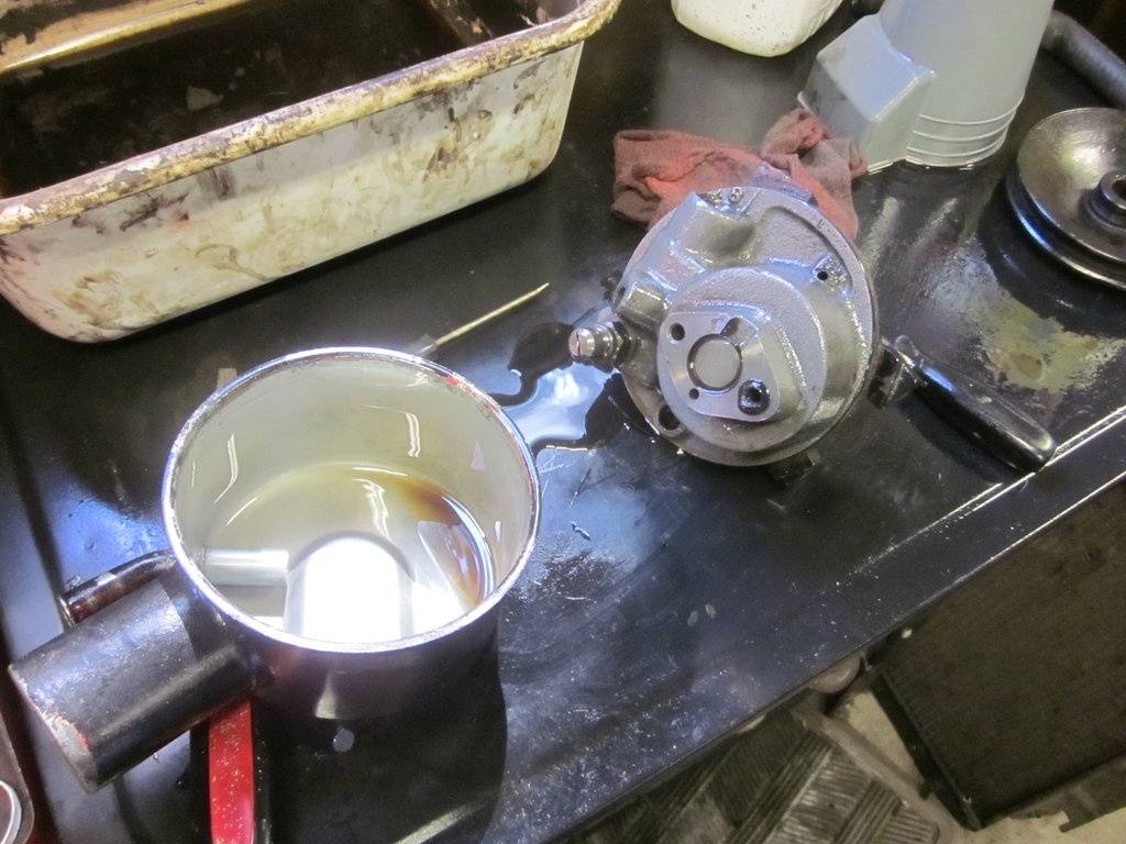

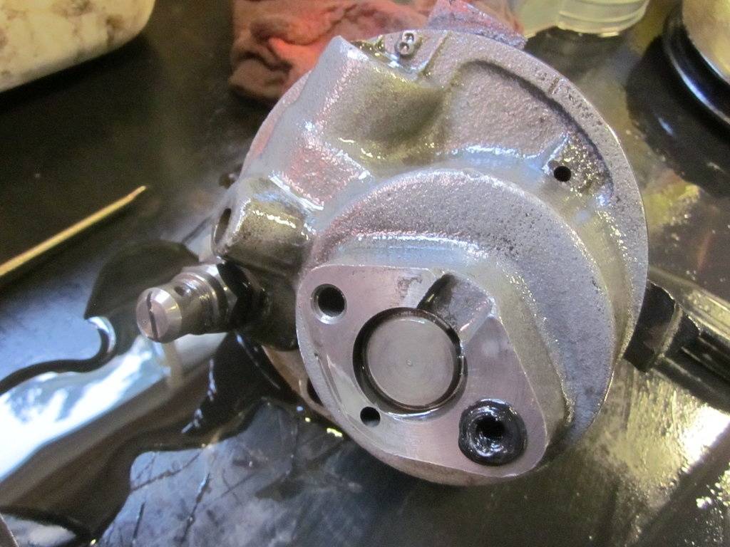

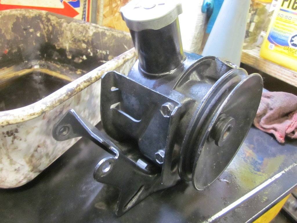

Now I've been having a nasty power steering pump leak.

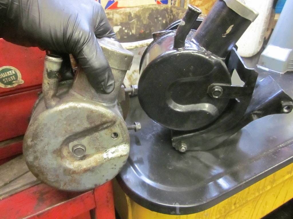

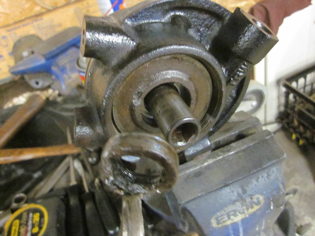

I got this TRW pump from Nationalmoparts, so there's no telling how long it has been sitting. I replaced the case oring but it is also leaking from the shaft seal.
I have another TRW (small reservoir) from the poly that didn't leak, but the pulley shaft is a smaller dia., so the pulleys were not interchangeable.

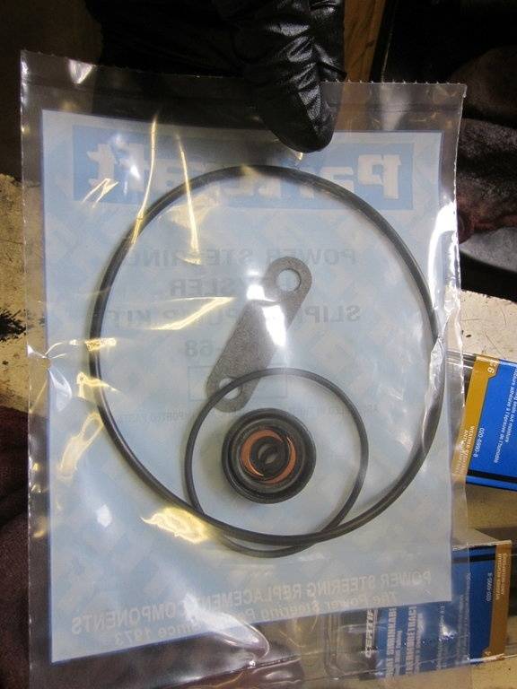

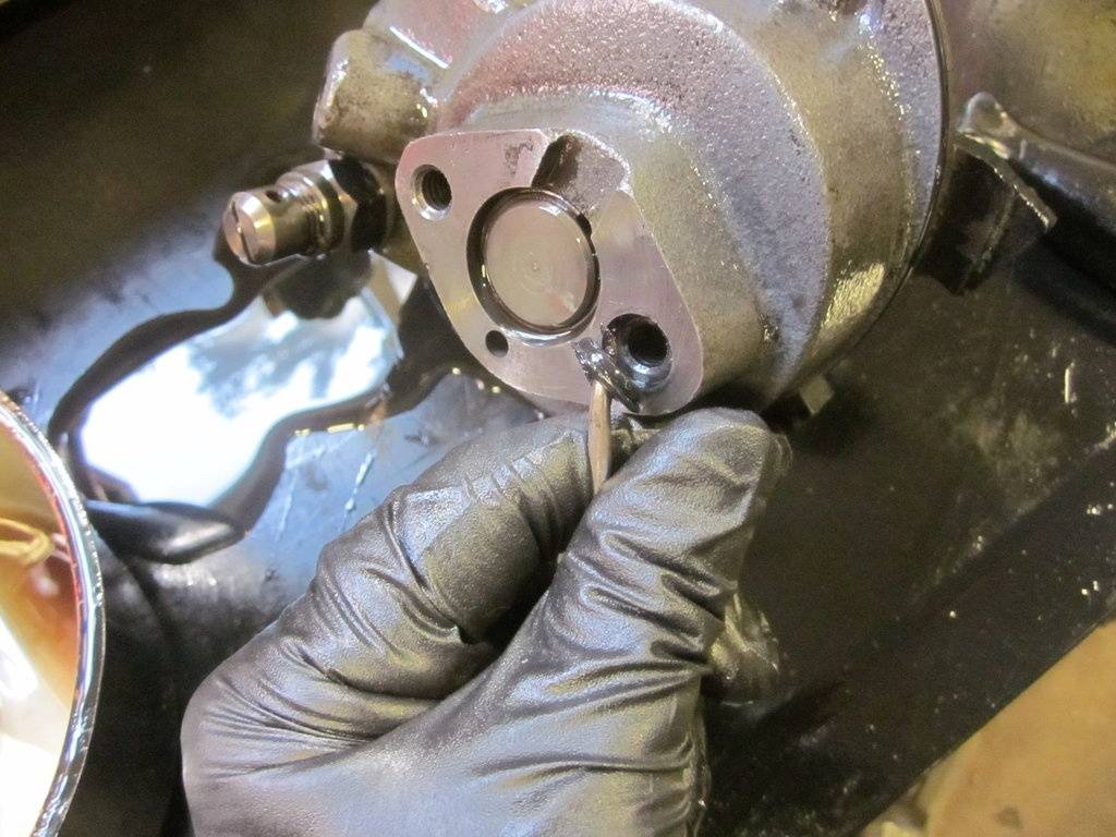

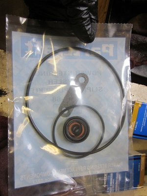

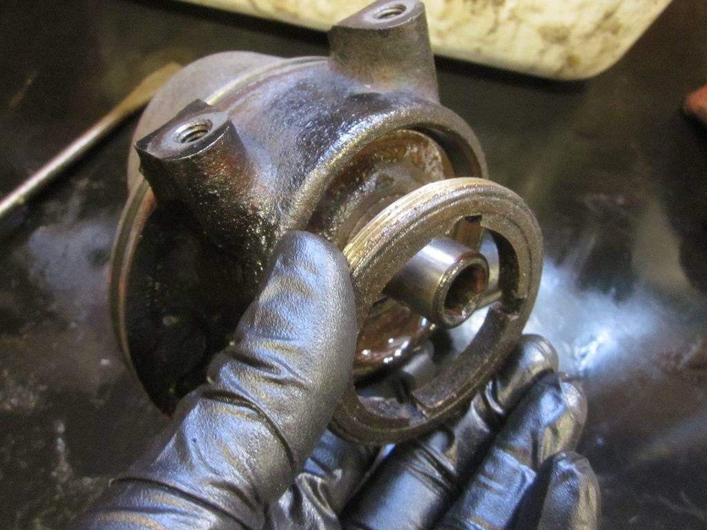

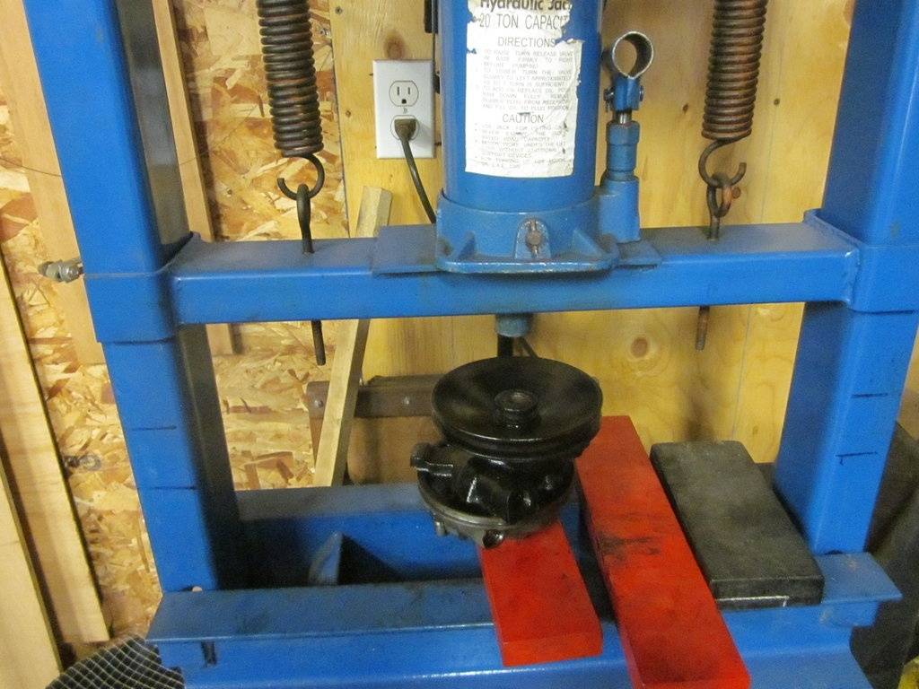

ordered a kit from steer & gear for the large TRW. It took a LOT of force to get the pulley to pop off the shaft. There's a thin layer of rust that was probably interfering with it.

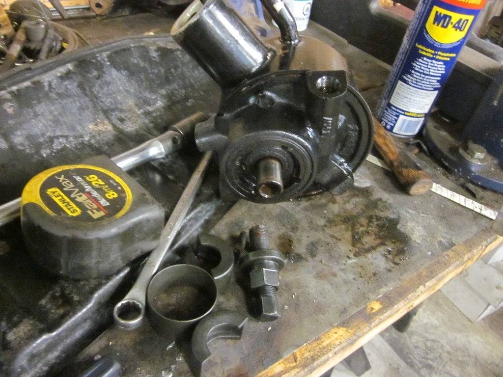

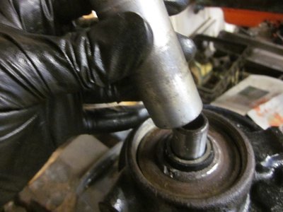

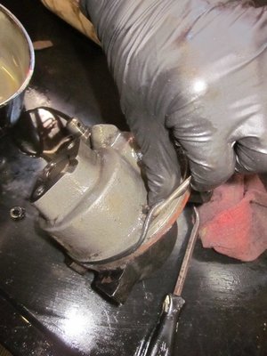

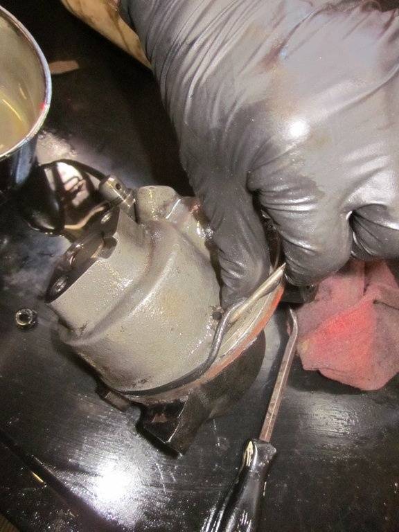

I took the threaded locking ring off, thinking I could slide out the shaft and pump components to replace the seal. After some reading, I found that this has to be pressed out and there are are some parts inside that may fall out of place while doing so. I decided to just pry the seal out by carefully folding the metal shell inward until I could pry it. There's a special tool to pull it out, but I don't have one and doubt they are easy to find. Took some work but got it out eventually.
The new seal has an outer rubber sheath or coating, so a little lube around and inside the shaft seal, then tap it on with a deep socket.

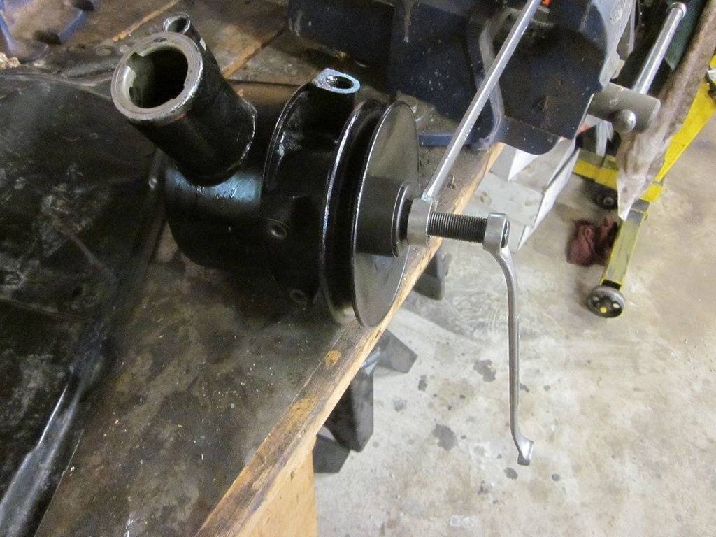

Cleaned up the rust on the shaft with 600 emery, despite the shop manual saying not to. Pressed the pulley on and bye bye leaks!

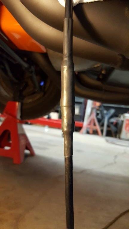

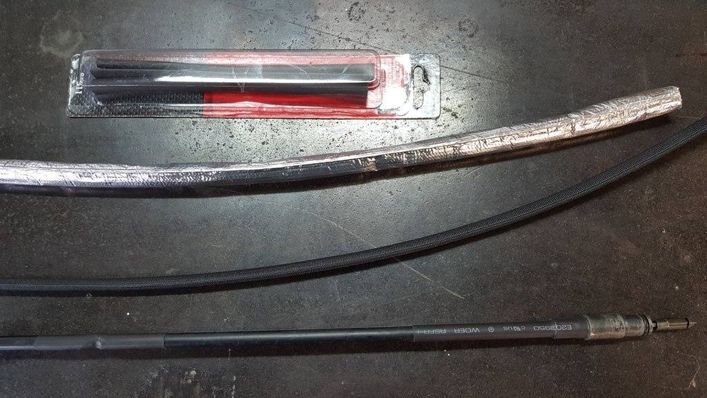

Next up is the tranny shift cable leak. I plan to use some heat shrink on it, but I'm still waiting to pull the cluster when my replacement tach arrives from yearone. Looks like it'll be another 3 months at this rate.

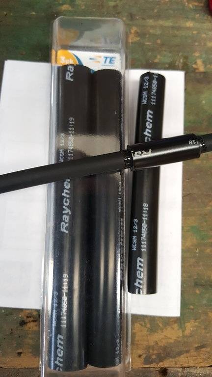

I went to Home Depot for my heat shrink. It's the kind with the heat activated glue inside. Everyone else carried the regular heat shrink without glue. Lowes has the right stuff but not the right size. Was more expensive too. But you probably have access to it.
My park cable had a place rubbed through it right where the clamp bolts to the floor. I had used the regular heat shrink and it didn't hold. So I removed it, cleaned it up with parts cleaner, applied a small amount of black rtv right where the metal housing was showing, not getting any on where the rest of the heat shrink tube needed to adhere to. Installed the heat shrink then installed the regular type over it for added protection. Useing it at the transmission ends are a plus too.
Tested a piece on a sparkplug wire.
Finished repair.
This is the "non glue" type.
Nice price on those shims! I paid $30 for a pair of steel ones on ebay. Hopefully they did the trick. I have a go pro type camera on the way so I can mount it and record my pinion movement. I'm rocking s.s. springs. I am 4° down on the pinion as it sits.

And a +1 to the glue lined shrink wrap. I didn't have any for my cable so I cleaned it with carb spray, used form a gasket adhesive and slid the wrap over it. I shrunk it down and the cable housing has been leak free.

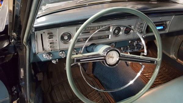

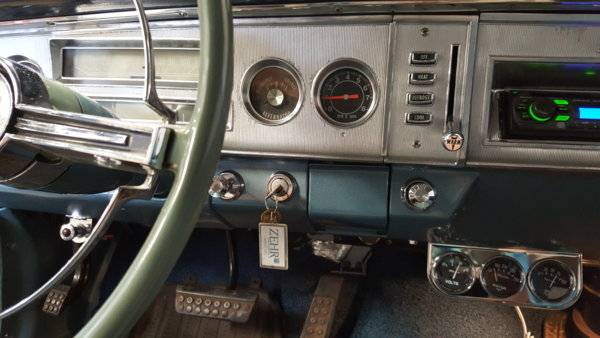

It's been a while since I've posted. Added the new in-dash tach and a few more gauges. I haven't connected the temp gauge yet because I can't get the plug out yet. Over the winter I hope to add a shroud and a new ignition system.

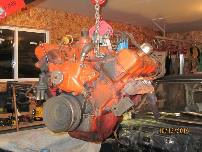

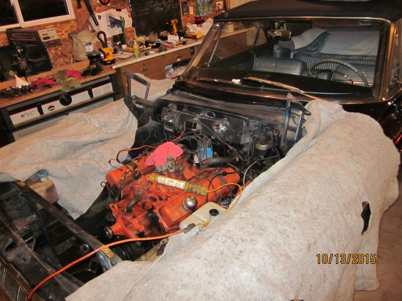

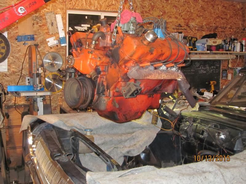

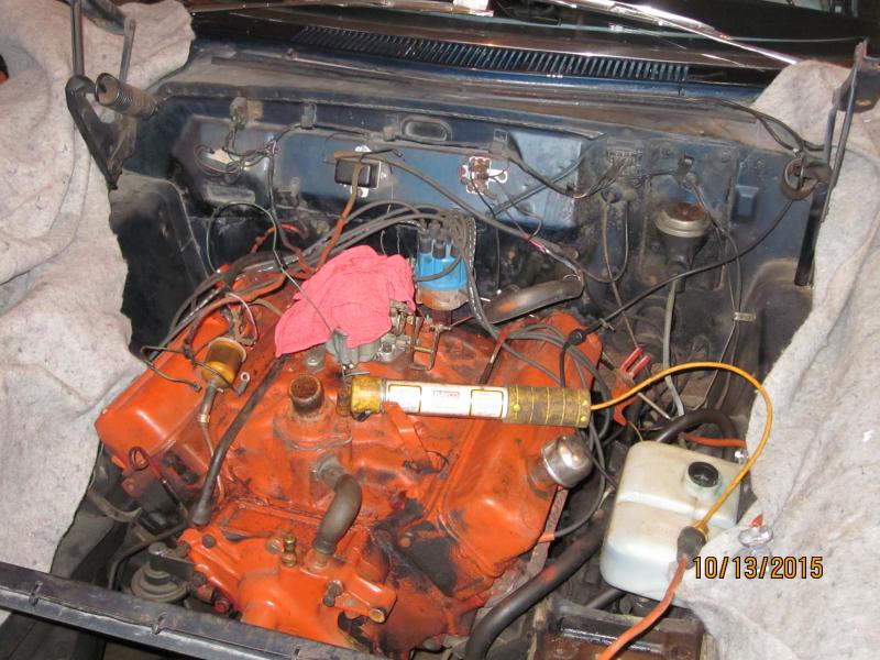

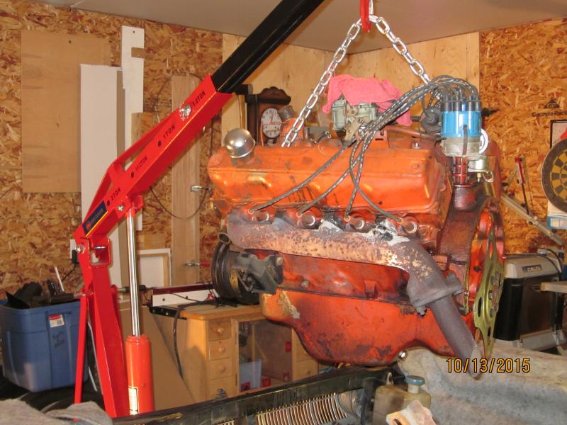

Bought this nice looking Polara last year and enjoyed driving it all summer. I thought a lot about rebuilding the poly but I'm just partial to big blocks. There's just something about the sound of a big block I can't explain...just love it!
View attachment 301050View attachment 301051

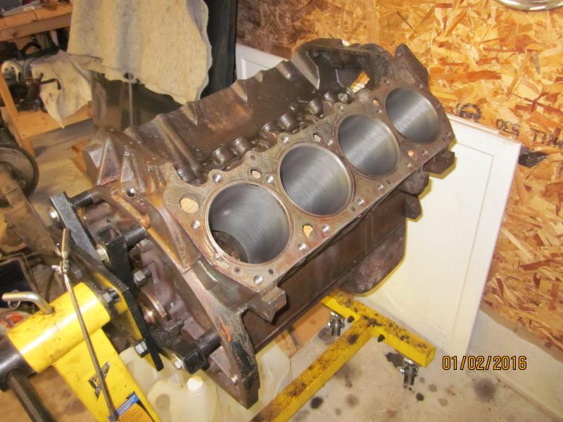

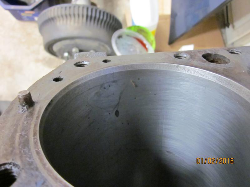

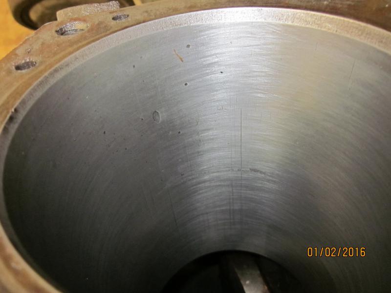

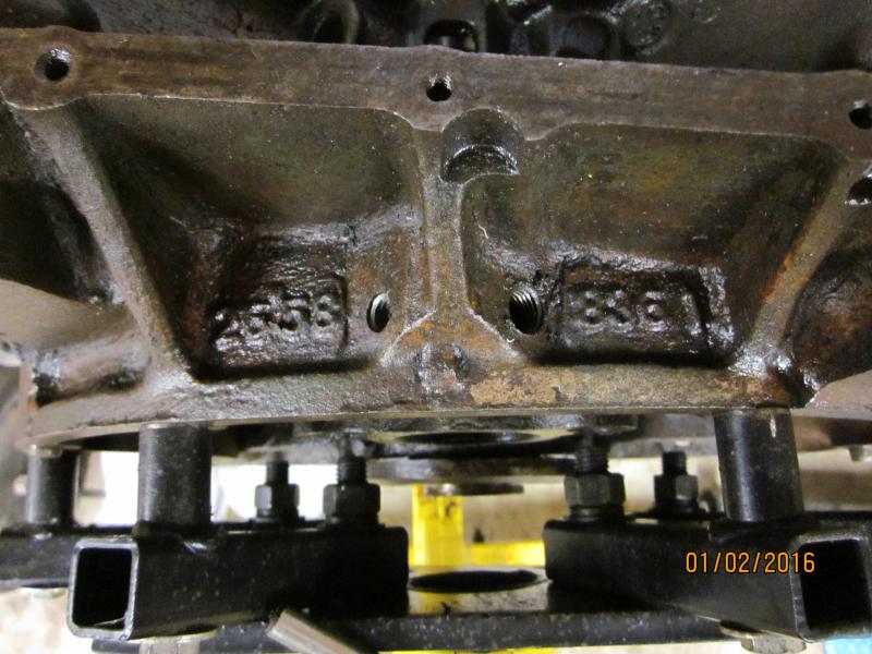

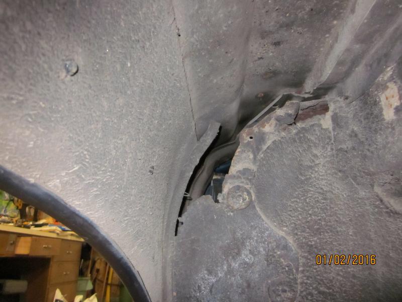

So out comes the poly. Below is the 413 which seems to have little wear but I found some pitting in a cylinder. It's going to the machine shop to be inspected soon.

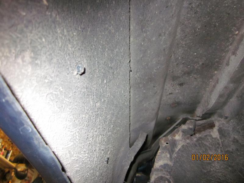

I could see the splash guards need replacing but it looks like some repairs will have to be made as well...
View attachment 301050 View attachment 301051 View attachment 301052 View attachment 301053 View attachment 301054 View attachment 301055 View attachment 301056 View attachment 301057 View attachment 301058 View attachment 301059 View attachment 301060 View attachment 301061 View attachment 301062
