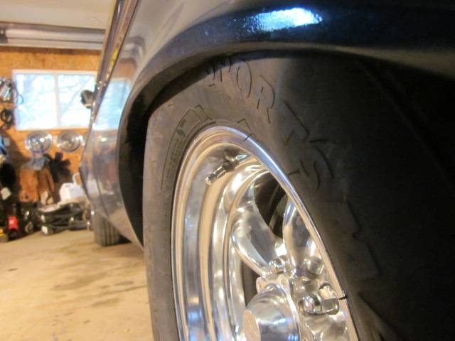

Those wheels look sharp! I bet you cannot wait to get it out.

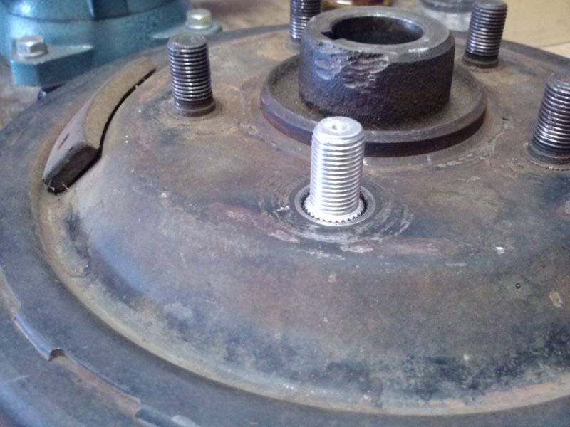

On the wheel studs I found that the 610-090 work as great replacements, used them on my 62 when swapping out the swaged drums. They are listed for Jeep.
You know I saw this posted elsewhere while trying to figure out what studs to order, but I thought it was for the rear for some reason. I ended up ordering the Dorman recommended studs for a 64 but the shoulder is too tall. Oh well, water under the bridge now!
