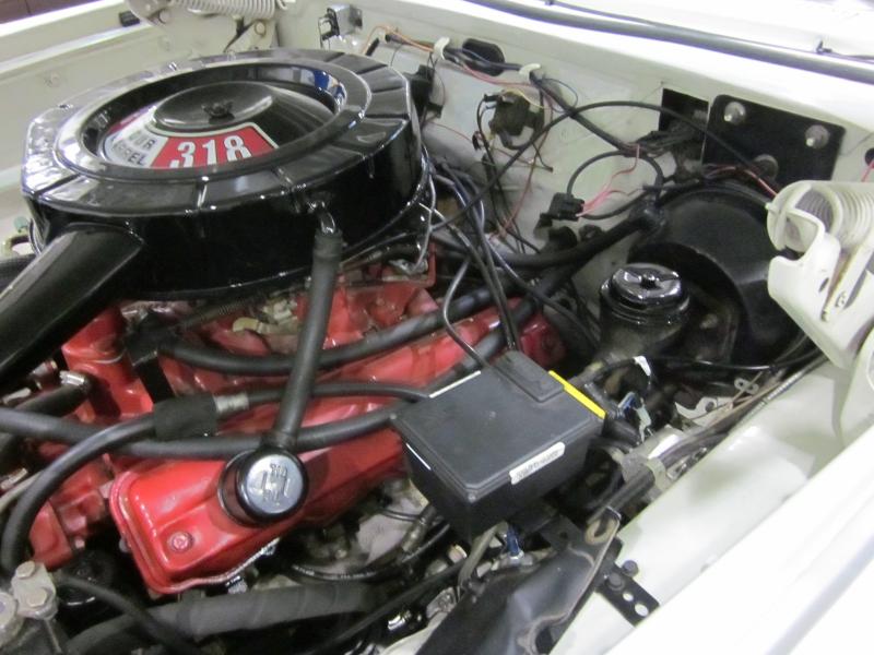

took in the local car show yesterday. Not may mopars unfortunately but this one caught my eye! Same owner since new...beautiful

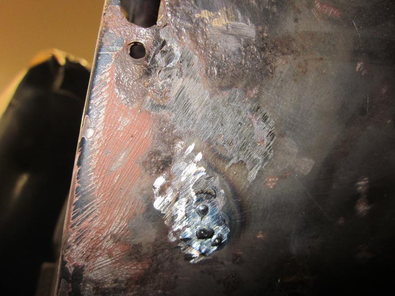

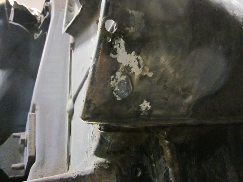

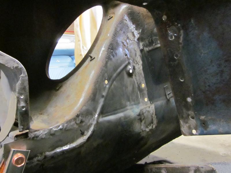

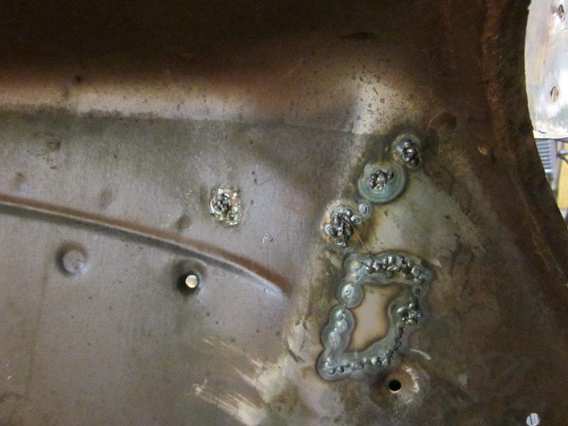

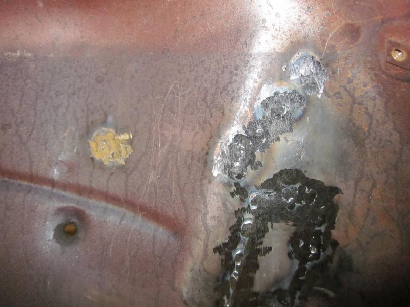

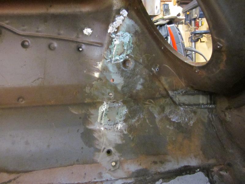

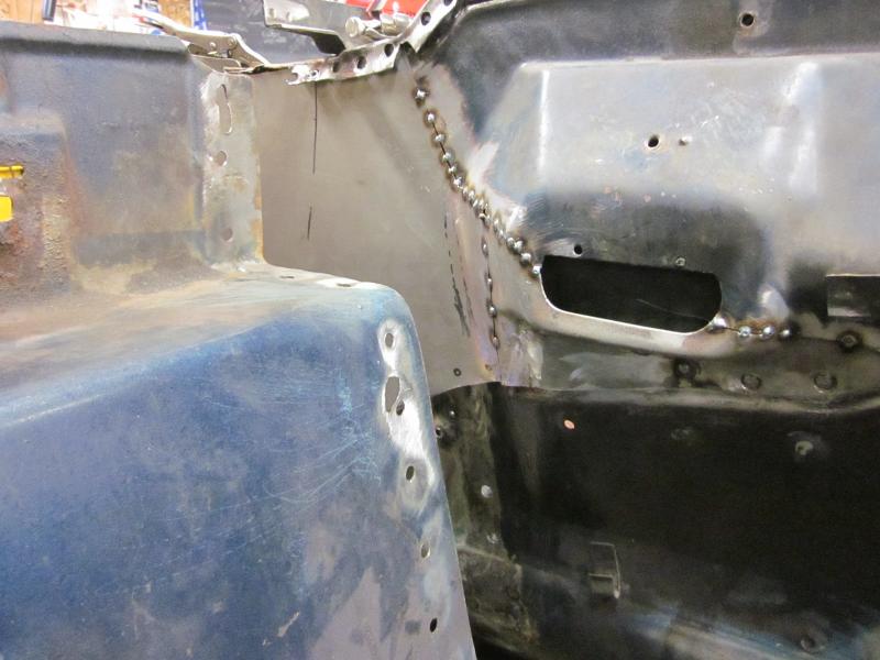

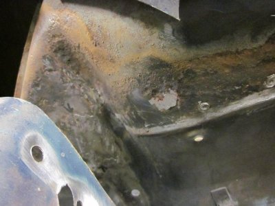

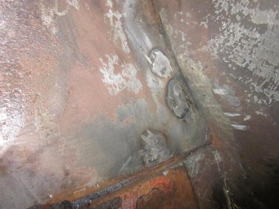

finished welding up these patches today

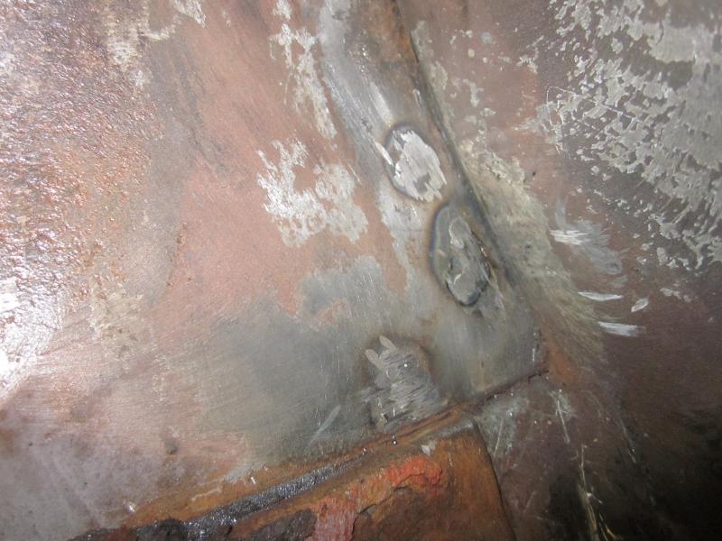

found a few more rust pin holes. Probably should have cut and patched but I managed to fill them in.

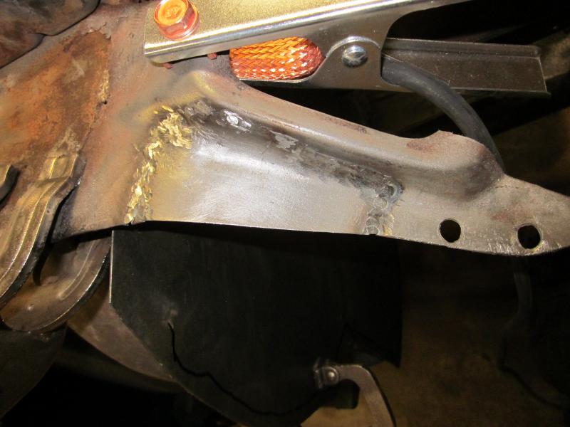

did a bit more work today though not as much as I would have liked.

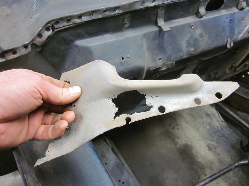

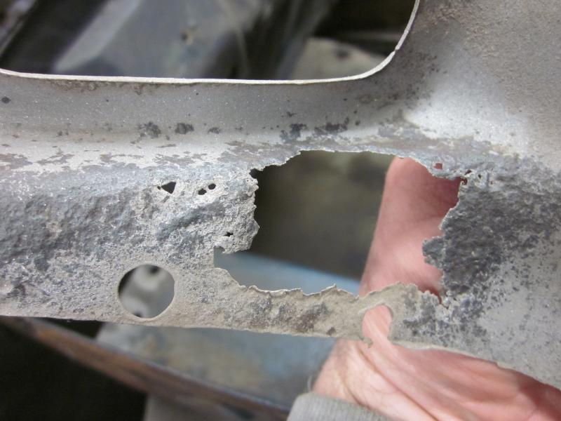

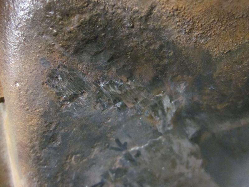

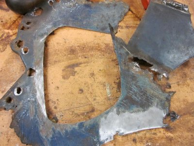

Before I can fit the large patch, I figured I'd fix this small section first. I trimmed it away from the large section and blasted it in the cabinet to see how much would have to be cut out...nasty!
I thought the 18g would be too difficult to fit and weld given the shape of the patch I needed to make so I stepped out to buy a piece of 20 in the absence of 19g. Turns out no one sells 20g either. All I could find was 16, some 18, 22 & 26...wtf, no 20g in three different stores!

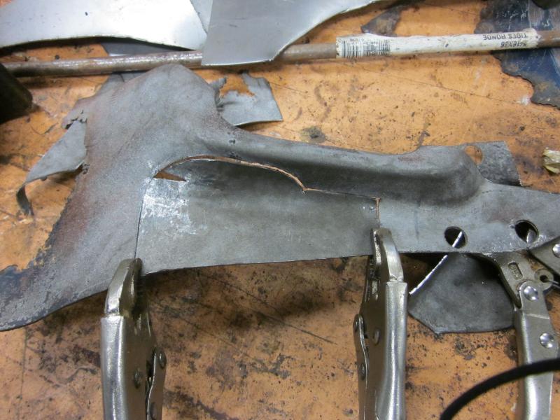

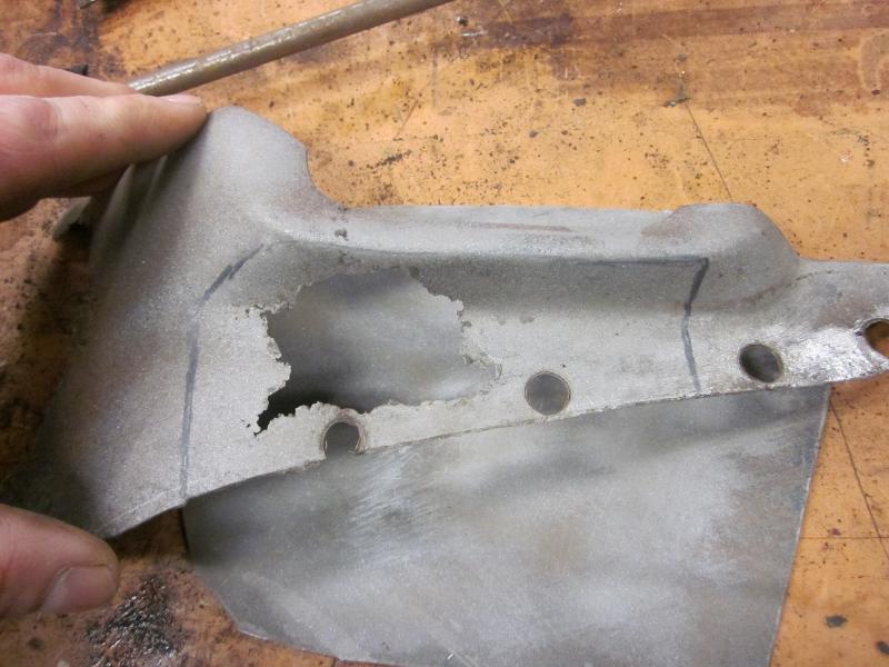

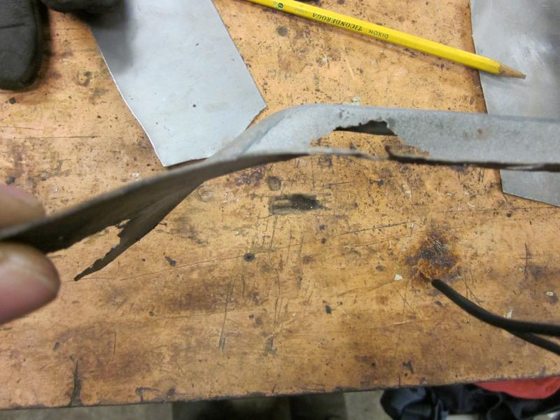

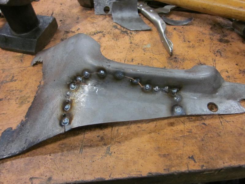

I decided to trim out a piece from the old air box and blasted it.

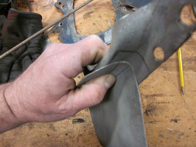

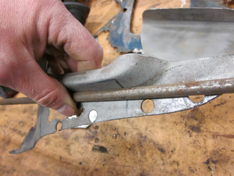

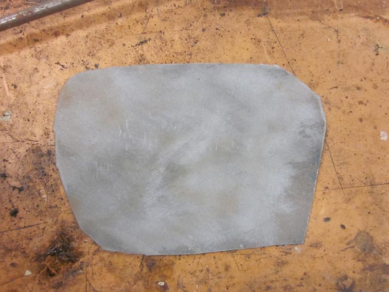

Marked out the rough spot to be cut. Used some round bar to get the right radius and hand bent it.
it was tough to fit the different curves and slopes, lots of hammer & dolly work.
tacked it and continue welding. Turned out better than I thought it would.
thanks guys. My goal was to get this little patch roughed in on Sunday, I took it right to the dinner bell. Amazing how long it takes, but I'm getting a little better at it. The plan is to sand it and then tack this piece back onto the firewall so that I can continue fitting the larger patch.

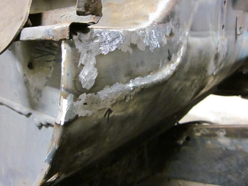

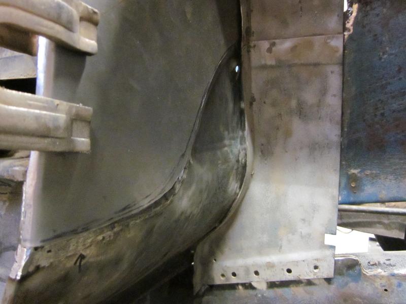

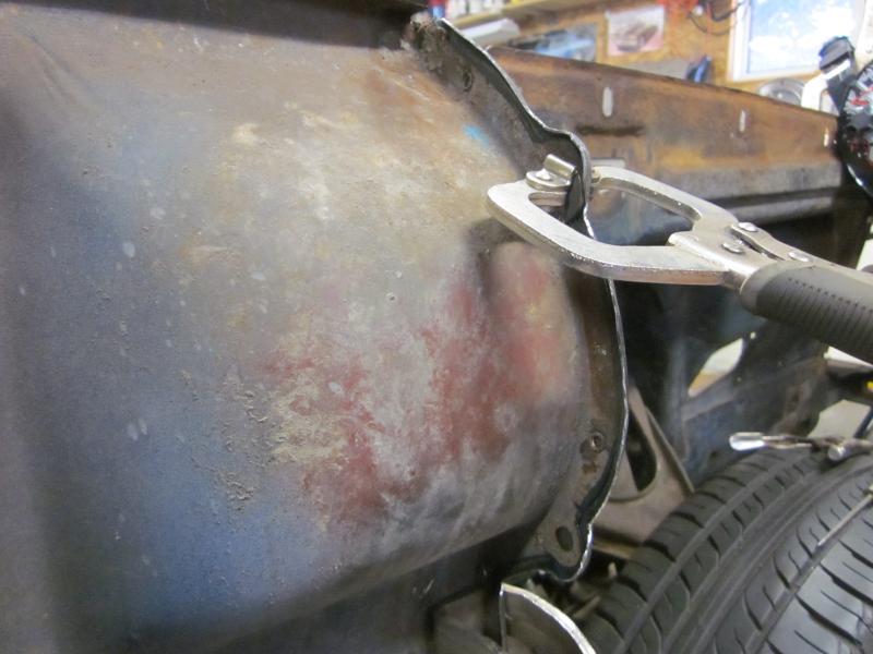

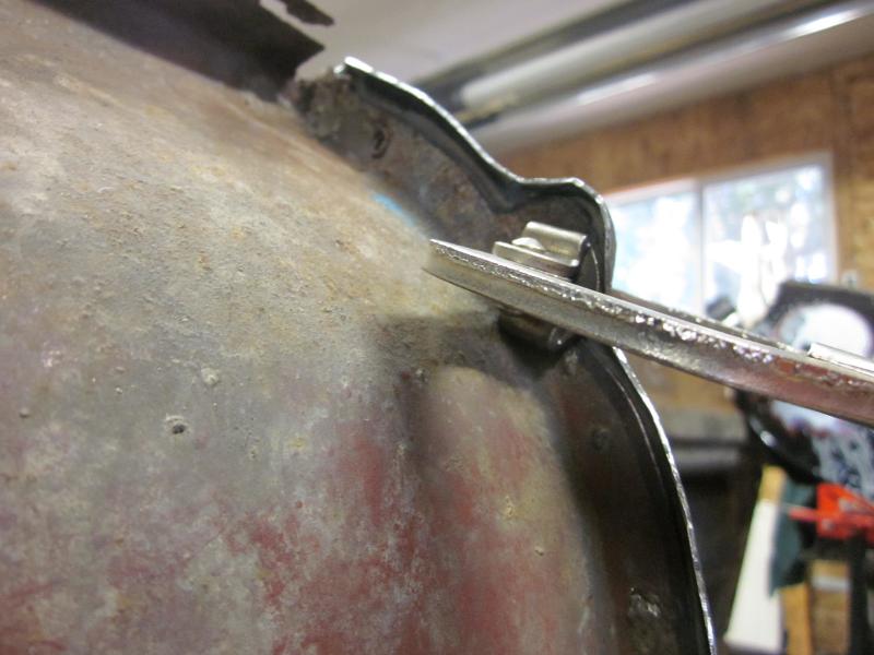

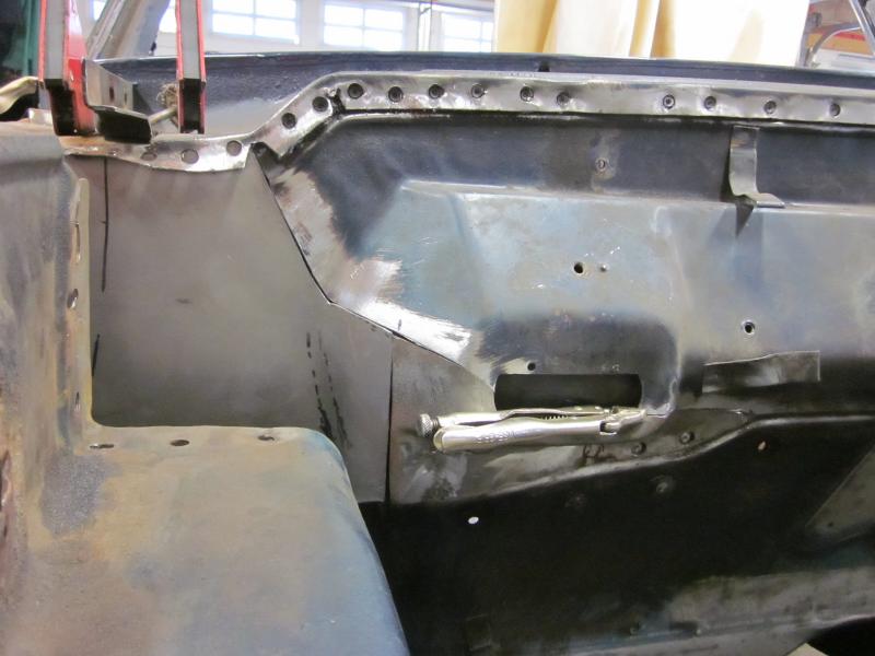

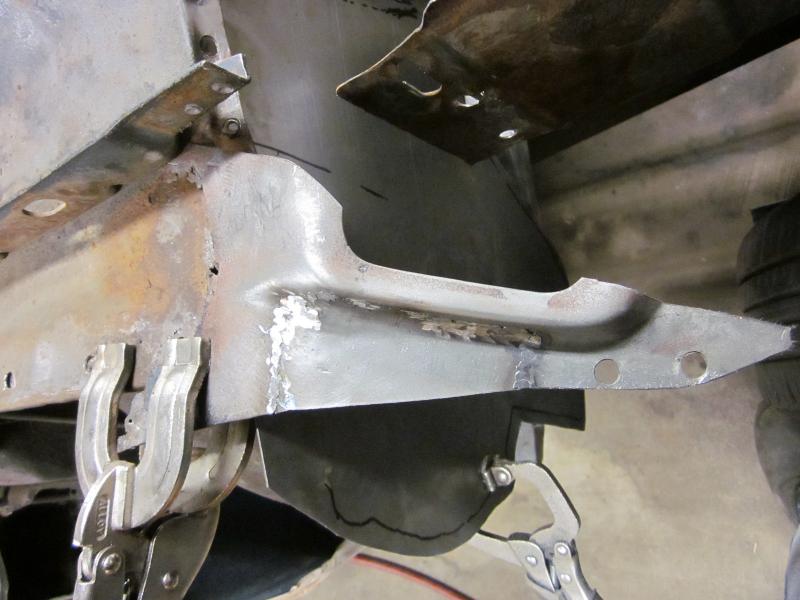

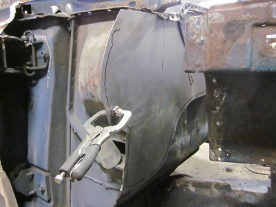

Some fine tune fitting

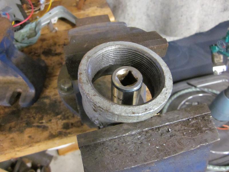

trying to reproduce the lip on the curves was a bit tricky.
A 3/4 socket and a 2" pipe fitting worked pretty good for the radius.

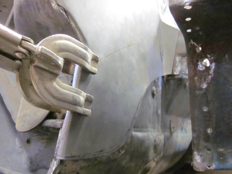

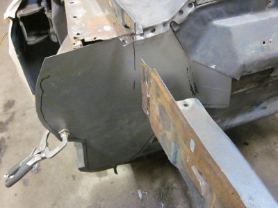

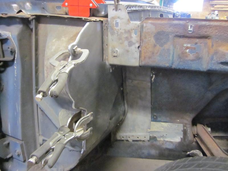

checking the fit for inner fender bracket
tacking it in place. not a bad fit for an amature
the plan is to remove the entire firewall air box section after fitting and tacking the patch so I could remove it as one piece. I figured it would be tough to fab it up and get it to fit right off the car. Now I can remove it and finish welding it. It'll be easier to clean up both sides and put on some rust protection and then weld it back on.

That last patches your fitting and tacking in could put you into pro status, it looks very nicely done.
