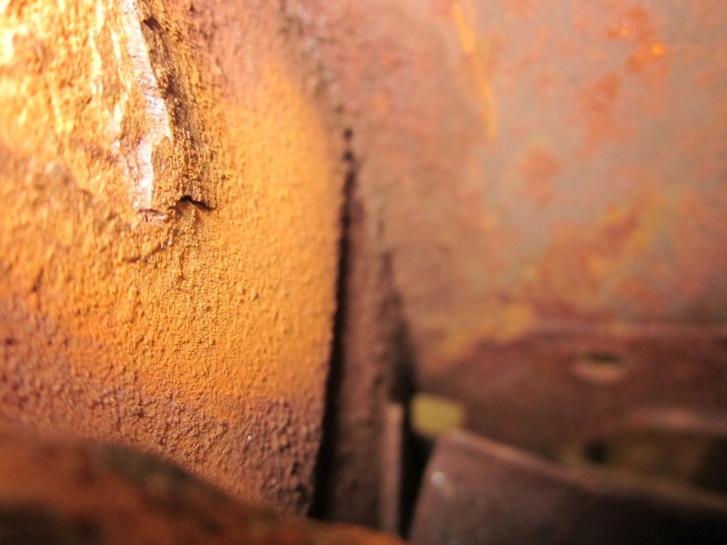

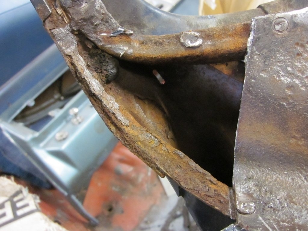

Can of rusty worms
crusty in there!
fitting and folded over the lip.

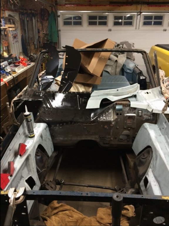

Look what showed up today, days ahead of estimated delivery! Jegs keeps impressing me. Costs were lower, delivery faster, no nonsense. Something to be said for American companies. These guys have their **** together!
well, there's no excuse now...I know what I'll be doing next week.

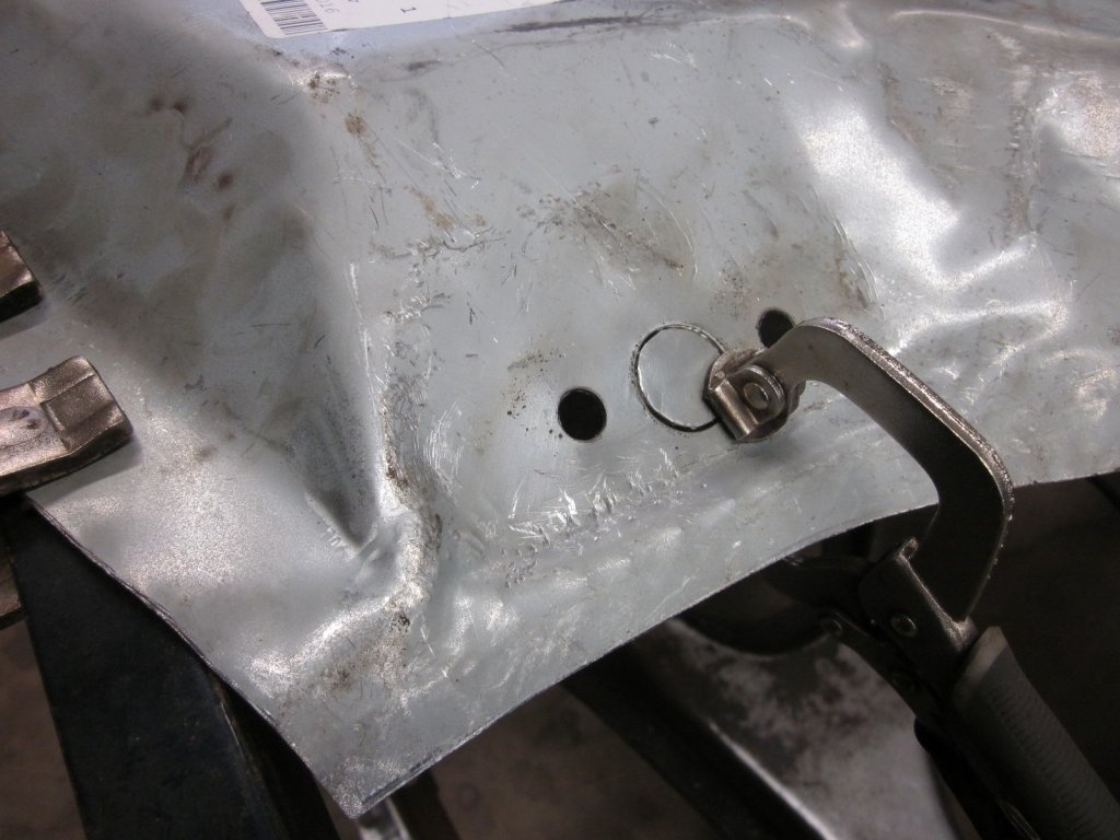

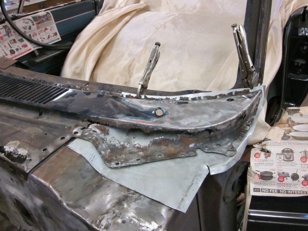

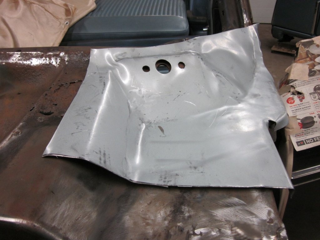

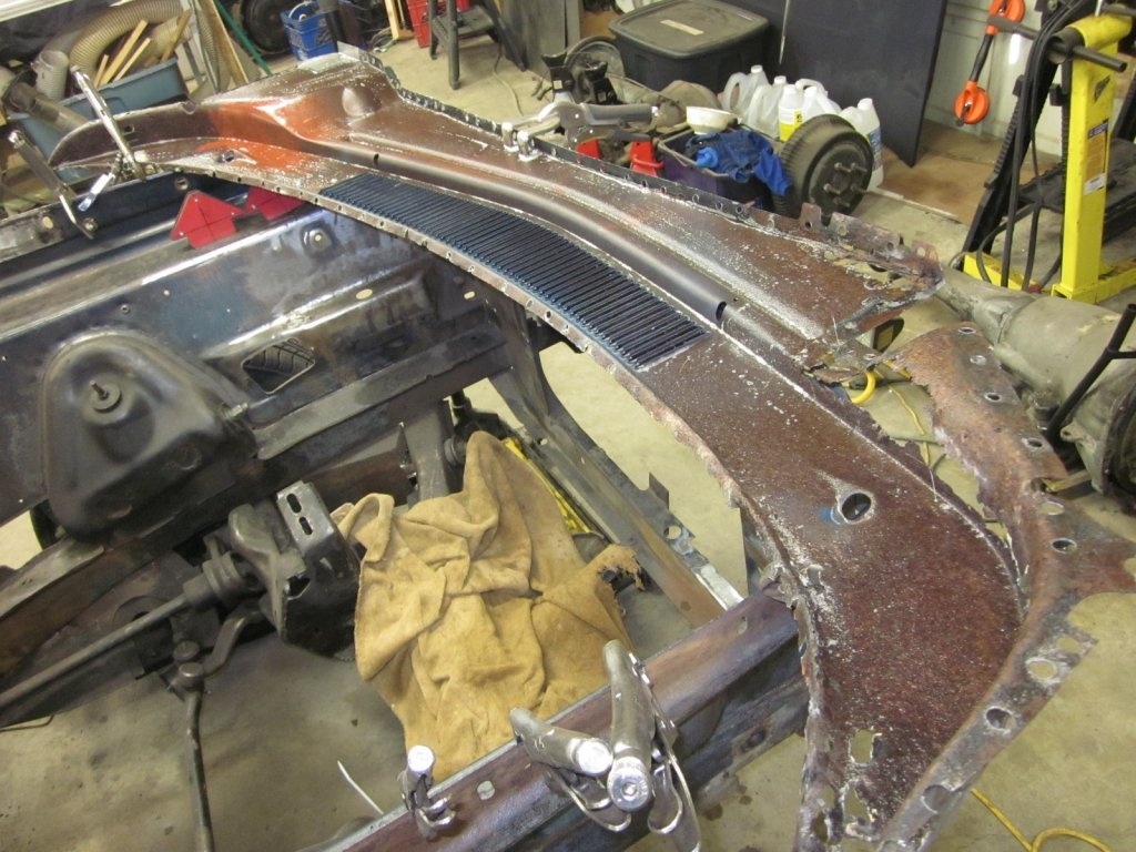

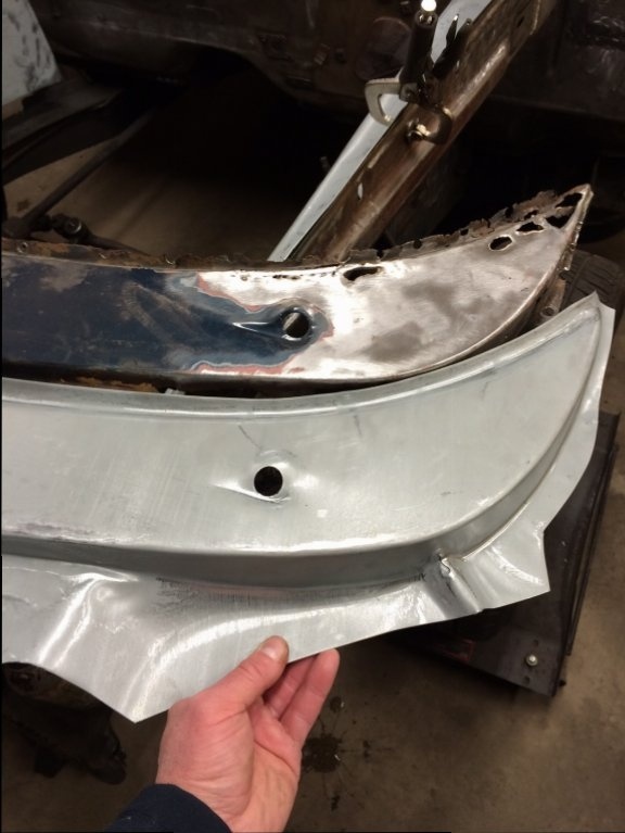

the bare metal inners & cowls are Sherman... a bit rough and will need some massaging to fit. I hope I'm up to the challenge.

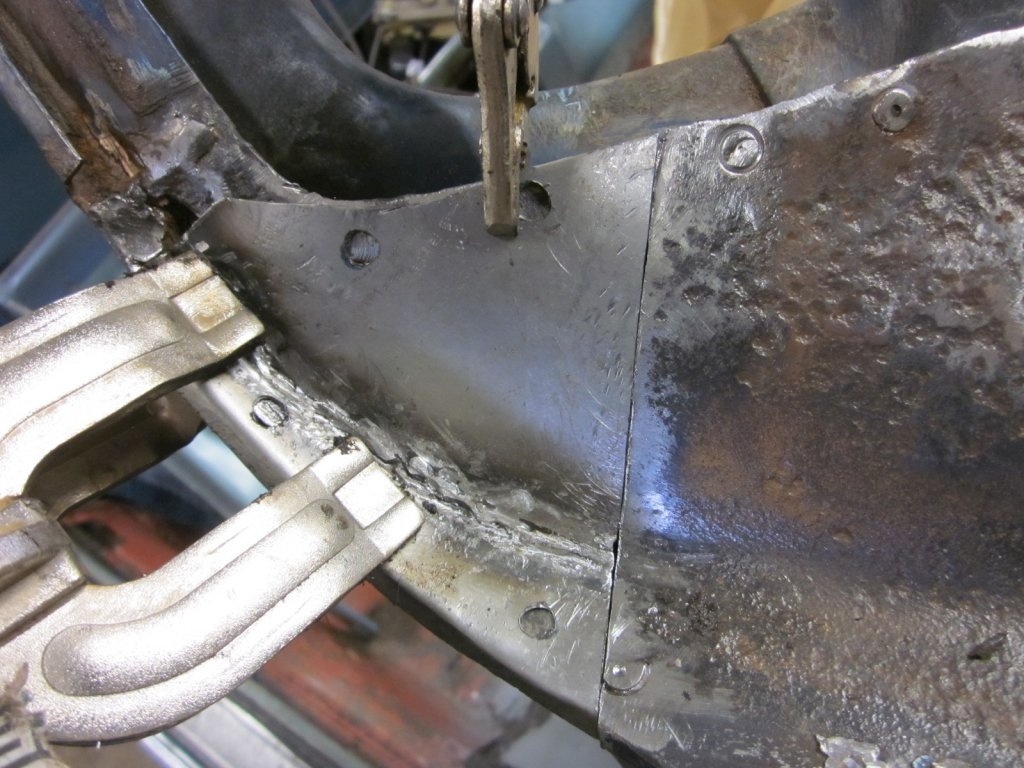

The outer cowl doesn't look too bad of a fit. The pivot openings line up more or less but it isn't pressed quite the same. I'm thinking of using portions of the replacement to patch to the original.

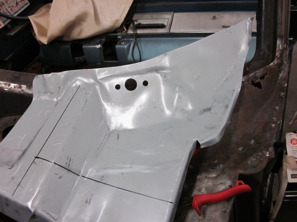

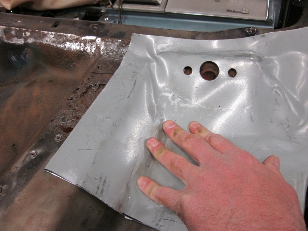

The sherman lower cowl doesn't fit but gives me the general shapes and contours to work with. I decided it will be cut up to reshape a bit.

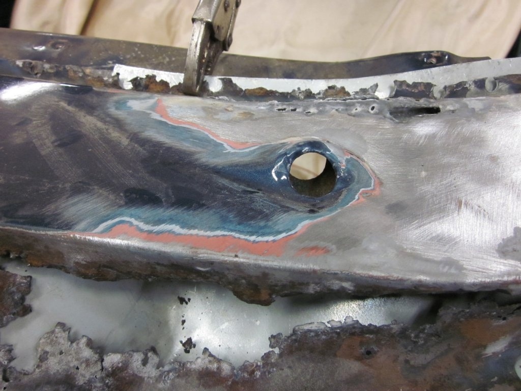

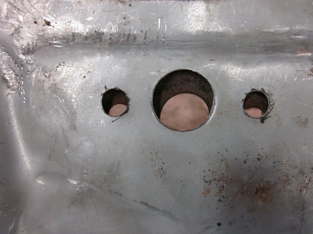

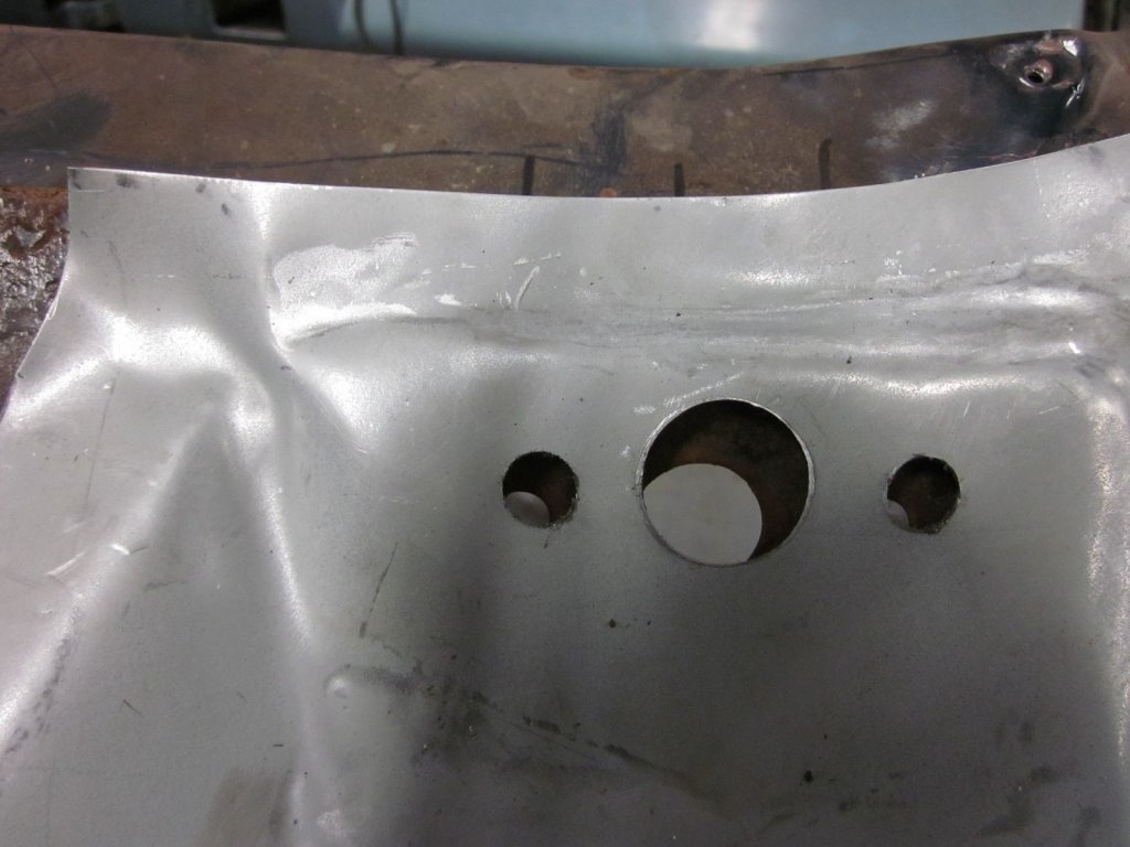

The holes do not line up very well either.

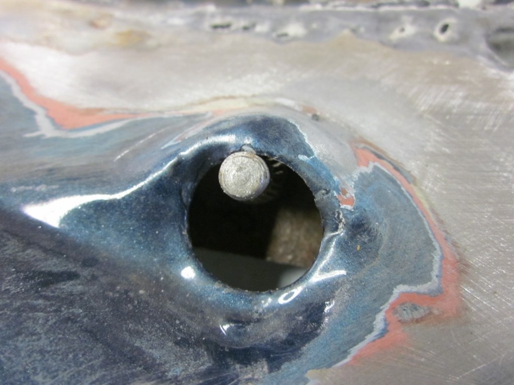

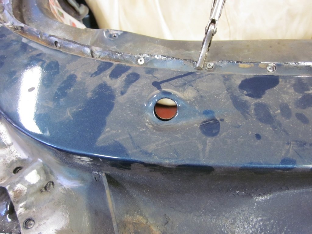

Checking the fit with the cowl pivots. The holes are definitely a problem. Might be better if they didn't punch them out.
