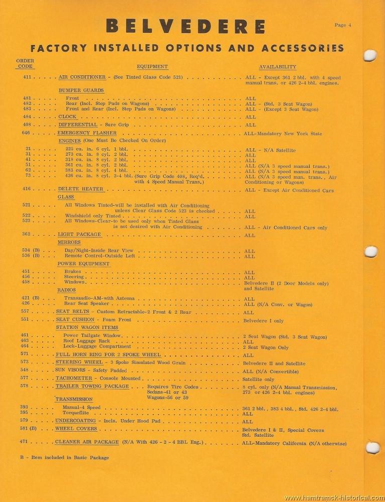

Here is the dealers order sheet from 66 showing the ordering options.
Problem is, Chrysler deviated from their normal ordering options many times, the real problem is, people know this and make ridiculous claims sometimes, stating "THEIRS" was one of those anomaly's when it really wasn't, or someone told them it was so, and they re-quote what they were told like it was gospel from the almighty. Unless you have documentation to back up the claims, it's all moot, or pure BS

Date code 10/66 is 1967 the new model year starts in September, and your friends charger also must have been a 67 the only mopars that came with 440's in 66 were C bodys, their wasn't a single B body made in 66 with a 440 end of story
