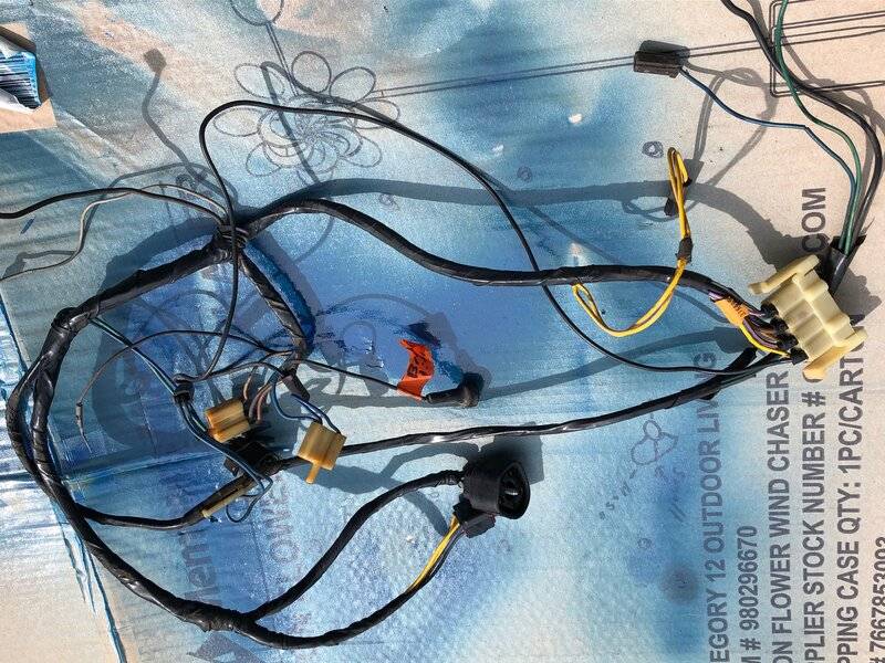

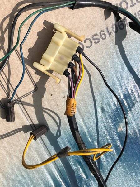

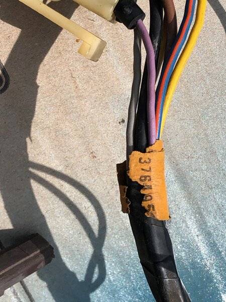

Guys, pulled this engine harness off my 73 and noticed it seems modified and pretty sure it is NOT original to a 73 400/440. Found two numbers on the tag near the bulkhead connection; can we tell what year and what engine it is from: numbers 95329C and 376495. Car was a factory 4 speed but had been changed over to an automatic, and I bet that harness is/was from the donor car.....thanks..
:thumbsup:
yes, PN will identify it BUT, Chrysler PNs got 7 characters, not 6.
Manual and auto cars should get same harness. Transmission related harnesses are separated harnesses
Can t see another digit on part number. Appears a PO had cut out wiring for the electronic ignition as engine was running a point dizzy. Just curious what it came from. They had bypassed the amp meter and I am wanting it all back factory original.
that's a 74 harness, a totally diff monster from earliers. If BB and you don't want it, I could get it :D
althought it seems to be small block
1974 - Depending on the last # it could be as Nacho says, 318/360 w 50 amp alt (3764955) or (3764954) A body also 74.
I need to get the numbers off the 727 that I pulled from the car. It may be a 1974 tranny. A PO in the past swapped out the original four speed and put in an auto and different 8 3/4 rear. I would bet thats where the engine and harness also came from. Pretty sure Im not going to use it Nacho. thanks guys.....
